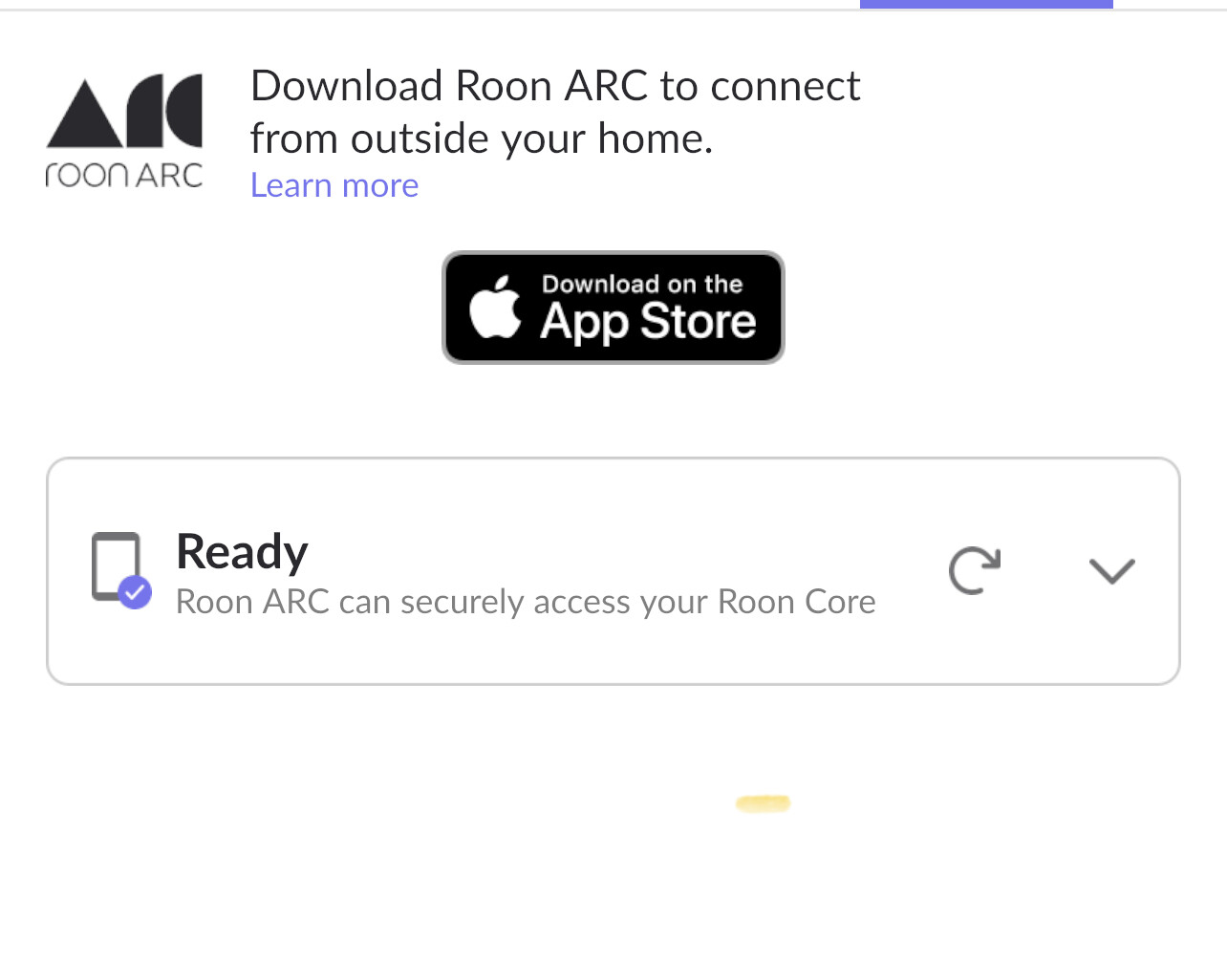

Here is the screen from my ARC that it is working indeed:
also the screen from Winbox you should see when all is OK:
(yellow marking)
When I disable above rule i got:
“connectivity”: {“status”:“NetworkError”,“status_code”:504,“error”:“error: Error: ETIMEDOUT, response code: undefined, body: undefined connected? undefined”},
“external_ip”: {“actual_external_ip”:“MYIP”,“router_external_ip”:null},
“upnp_autoconfig”: {“status”:“NotFound”}
