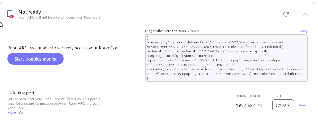

Roon ARC not ready - reviewed list of modems (mine is not on it)
Roon Core Machine
“connectivity”: {“status”:“NetworkError”,“status_code”:502,“error”:“error: Error: connect ECONNREFUSED 75.164.193.93:33267, response code: undefined, body: undefined”},
“external_ip”: {“actual_external_ip”:“75.164.193.93”,“router_external_ip”:null},
“upnp_autoconfig”: {“server_ip”:“192.168.1.1”,“found_upnp”:true,“error”:“<s:Envelope xmlns:s="http://schemas.xmlsoap.org/soap/envelope/\” s:encodingStyle="http://schemas.xmlsoap.org/soap/encoding/\“><s:Body><s:Fault>s:ClientUPnPError<UPnPError xmlns="urn:schemas-upnp-org:control-1-0">501ActionFailed</s:Fault></s:Body></s:Envelope>”}

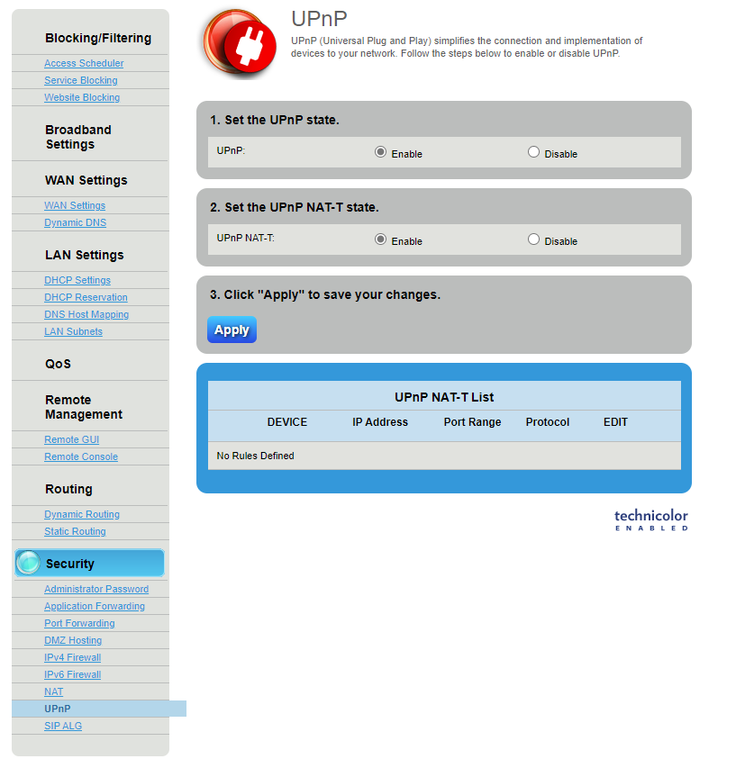

What modem? What ISP?
UPnP is not working. You’ll probably need to manually set-up the port forward.
These might be the instructions:
Hey @Karl_Mayhew,
Thank you for your patience while we’ve diligently worked to reach every request for support with port forwarding. The diagnostics you’ve provided suggest that UPnP is enabled on your network, but your router is refusing the connection. This is either the result of UPnP not being enabled properly on your router, or settings at the level of your internet service provider.
First, to confirm the issue is not with your local network setup:
  • Try to enable UPnP/NATPMP in the web administration interface for the router directly upstream from your Core
  • Try to manually open the port in your router’s port forwarding configuration
  • Make sure the IP/Port matches the Port listed in Roon → Settings → ARC
  • Check for any VPNs or Firewalls that might be interfering
  • Check if your modem is in Bridge mode
If you continue to experience difficulties, we recommend reaching out to your internet service provider and passing along the following questions:
  • Have you implemented carrier-grade NAT for my account level?
  • Have you fully implemented IPv6, or do you have IPv4 addresses available?
  • Can I request a static IPv4 address to support port forwarding?
  • Are there any ports you have reserved at the ISP level I should be aware of?
-Ben
