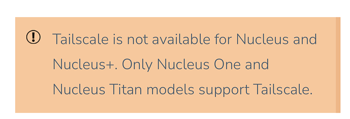

When I try to install Tailscale I am stuck at step 2. in the Roon OS web admin page I don’t see a Tailscale button. How do I proceed?

Tailscale on RoonOS is only available with RoonOS 2.1, and this version is only available with Nucleus One, Titan, and ROCK installations that were created in UEFI mode.
Older Nucleus and ROCK installations in Legacy BIOS mode don’t update beyond RoonOS 1.0 and thus don’t have Tailscale.
You can either reinstall RoonOS in UEFI mode or use a separate little machine (like a Raspberry Pi) or any other computer you have, to configure a Tailscale Subnet:

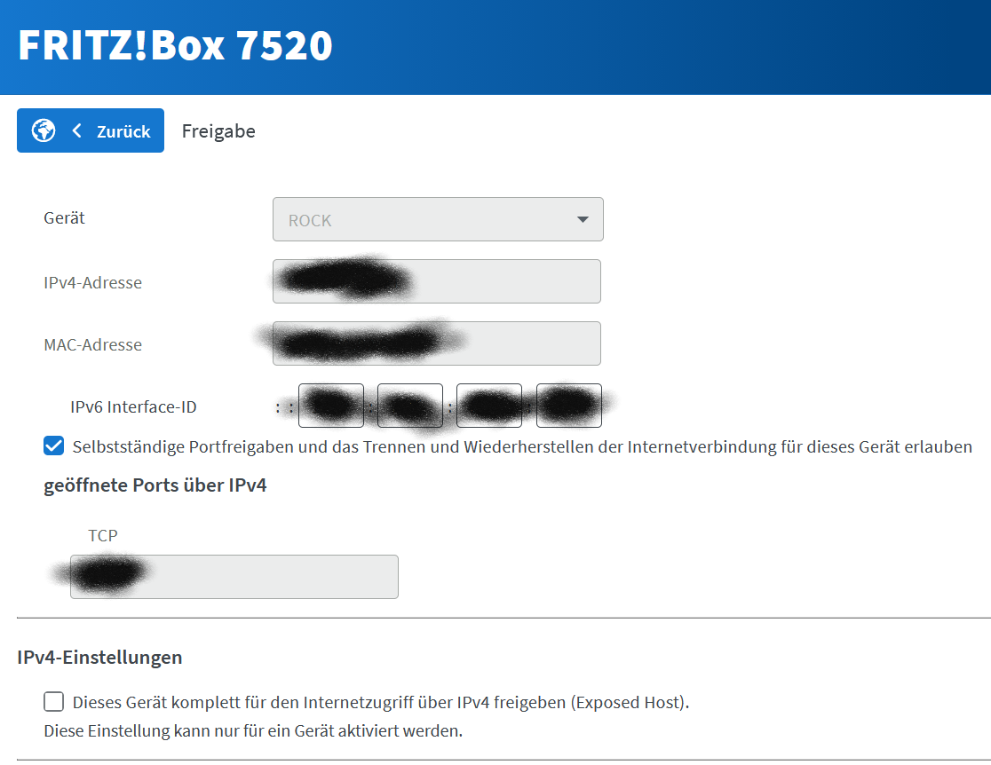

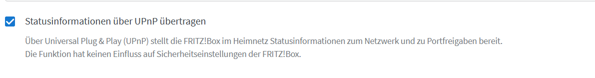

In Heimnetz - Netzwerk it shows this

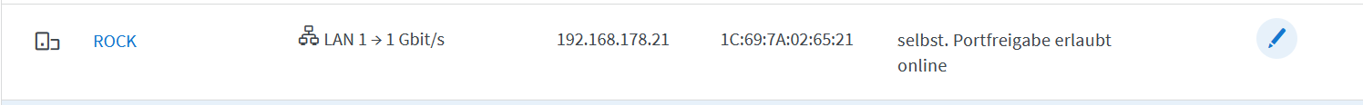

UPNP is activated, as far as I understand.

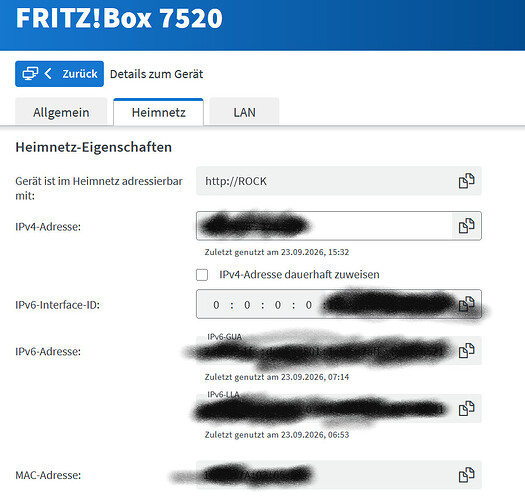

This shows in Freigaben - Portfreigaben. Not sure if useful

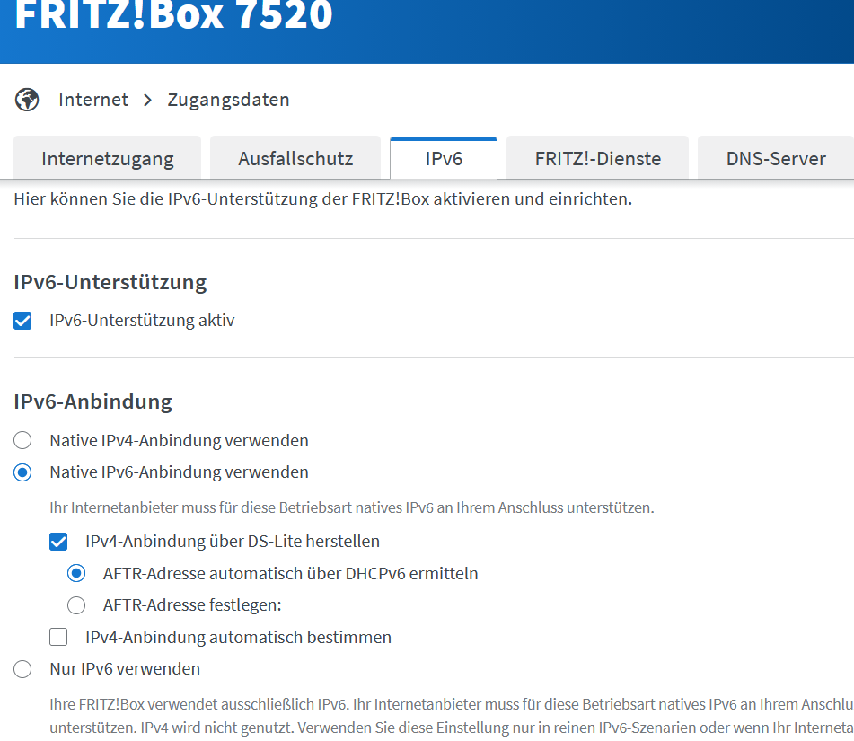

If it configured itself like this based on auto-configuration info that Vodafone sent to the Fritzbox, it probably means that it has to use DS Lite for IPv4, and in this case port forwarding won’t work.
But as mentioned, it may be possible to convince Vodafone to give you a real IPv4 address instead.
I think this is a different use of UPnP where the Fritzbox uses UPnP to provide info about its own state

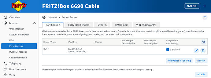

This looks OK - the important part is the checkbox for “Selbständige Portfreigaben … erlauben”, meaning that this device is allowed to use UPnP to configure port forwarding for itself.
The corresponding setting in Internet > Permit Access is this (from my Fritzbox), saying that Independent Port Sharing (“Selbständige Portfreigaben” in German) is allowed for the device. I.e., like above, that the Fritzbox allows this specific device to configure its port forwarding by UPnP automatically:
But it won’t work with IPv4-over-DS-Lite.

You could try to force a native IP v4 connection instead of a native ip v6 or remove the ds-lite checkbox for IP v4 with native IP v6.
In both cases check on “Internet/Verdindungsdetails” whether you get IP v4 and v6 adresses assigned after reconnection and of course check if you can still access the internet.
If it doesn’t work, you can always change the settings back to IPv6 with ds-lite.

I tried that and the internet connection was broken. So not that easy. I will try to get a hold a support person tomorrow again. No luck today. Other wise will look into other options for on the go…
