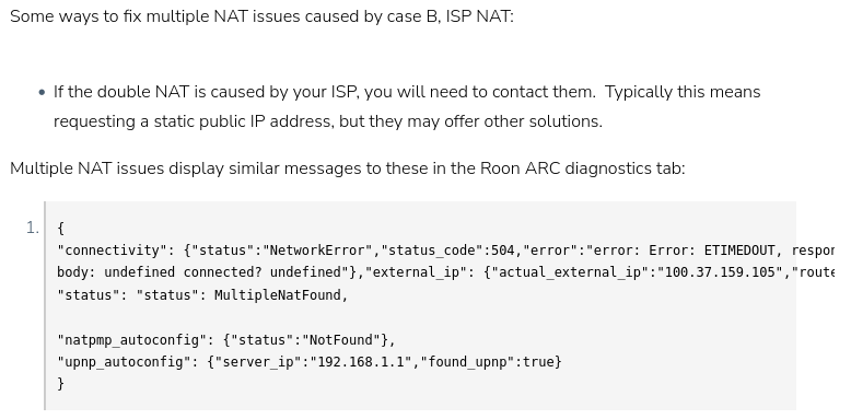

“ipv4_connectivity”: {“status”:“NetworkError”,“status_code”:504,“error”:“error code: 504\n”},
“external_ip”: {“actual_external_ip”:“147.aaa.bbb.ccc”,“actual_external_ipv6”:“null”,“router_external_ip”:“100.ddd.eee.fff”},
“status”: “status”: MultipleNatFound
“upnp_autoconfig”: {“server_ip”:“192.168.0.1”,“found_upnp”:true},
“multinat_autoconfig”: {“status”:“Failed”,“error”:“Unknown Error code”}
Are you sure that you actually got one and use that one also properly?
This also contains the possibility to be 100.64.XXX.XXX which is reserved for CG-NAT which would perfectly explain the “MultipleNatFound”. See also:
So please contact your ISP to check your situation with him (too). He may also able to help you setup a manual port forward with the ISP router.

The first was the one BlackJack spotted from your diagnostics. router_external_ip beginning 100. is carrier-grade NAT address space, which is why the connection test returned 504 and why MultipleNatFound appeared. Your ISP confirming the static IP had been forgotten during the router swap fits that exactly.
