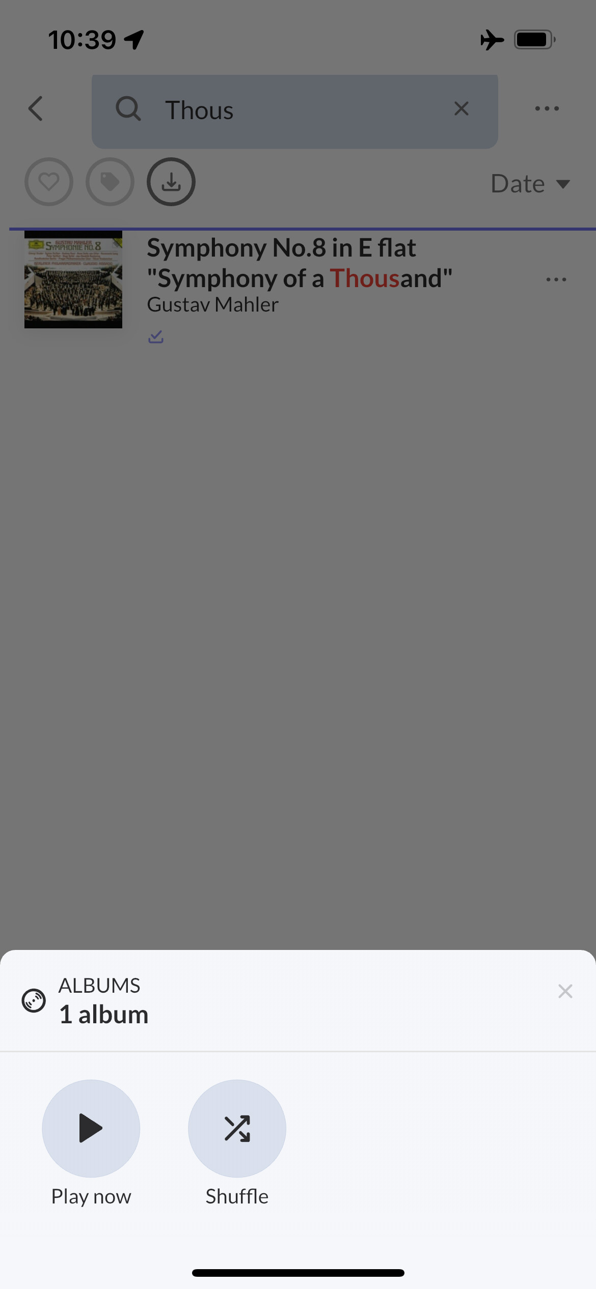

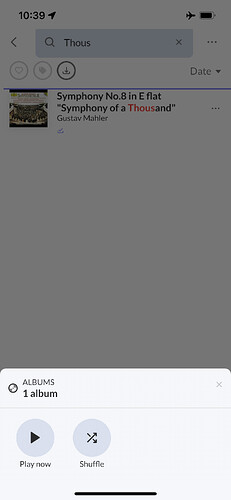

When I use Roon ARC offline, my downloaded albums show an error and can't be played from the album screen. But when I filter the downloads list, I can play them from that screen - but the tracks are all out of order, so it's really frustrating.

  • ARC syncs all the time, this issue only happens when I launch the app when I already have Airplane mode on (or no signal). If I start playing before I lose signal, there’s no problem.
  • Yes, tracks are fully downloaded, they play without problems if I lose signal after pressing play, or if I use the weird workaround of the album list filter (although they are then out of order).

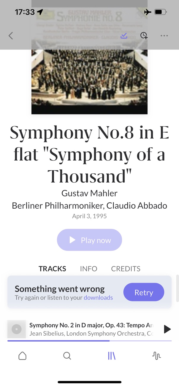

For clarity I should add that I can click on a downloaded album but the play button is greyed out and no tracks appear. Eventually an error message appears saying I should go and listen to my downloads.

Thanks @noris - it happens whenever I launch ARC after not having a connection, whether that’s Airplane mode or just going underground.
Steps to reproduce:
Phone with signal > Engage airplane mode > launch ARC > can’t access album
Phone with signal > Go underground and lose signal > launch ARC > can’t access album.
What’s particularly strange is that as you see in the screenshot, it tells me to try and listen to my downloads - but as you can see at the top, the album is one of my downloads. It happens with every downloaded album.
