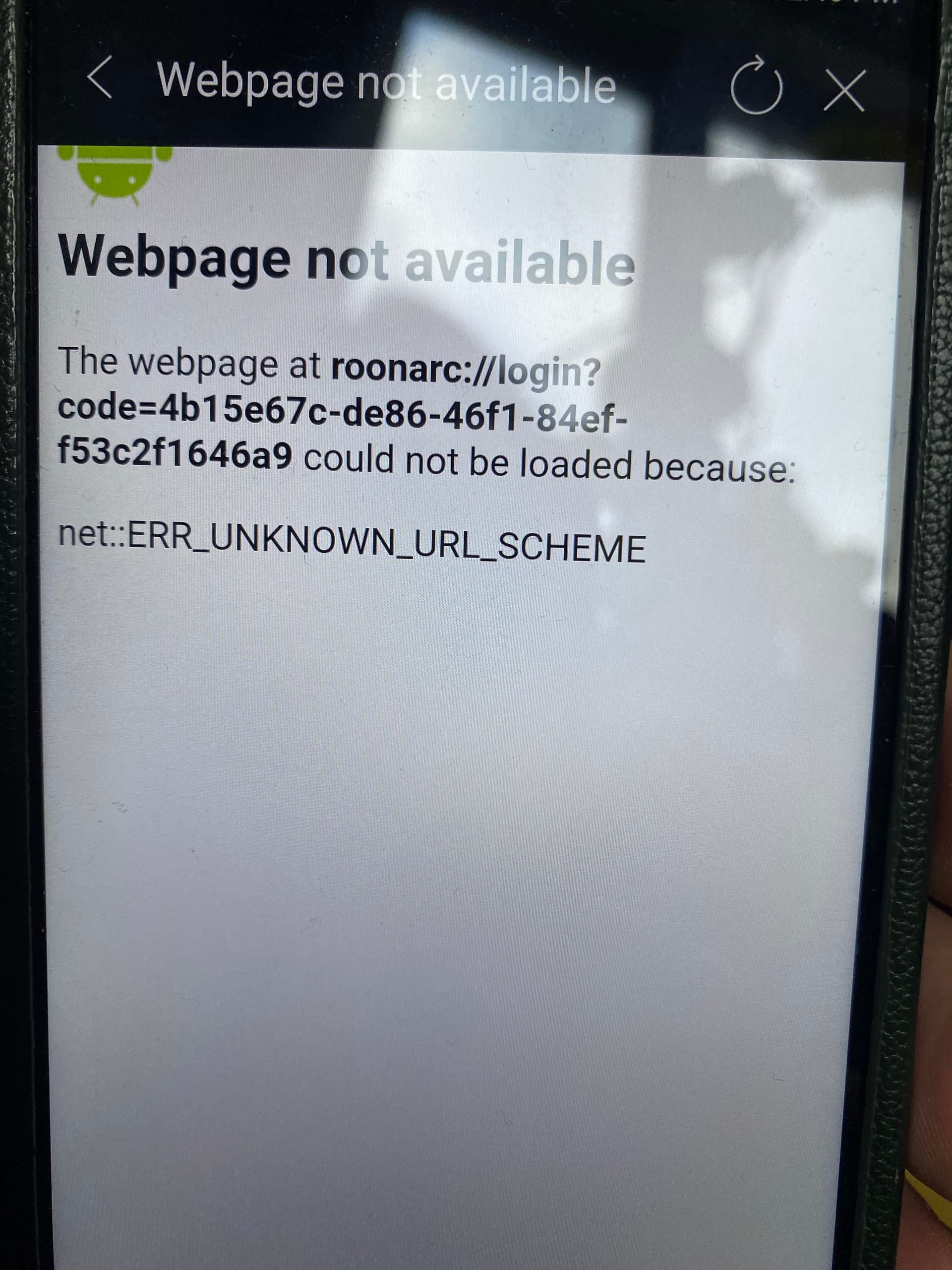

Hi - I’m trying to get Roon ARC running on my SP3000 but there’s huge issues signing in. My Roon server does recognise the device though. This is the issue: is this where I sideload chrome?
Yes, you need to download and install Chrome and then go to setting and select it as your browser.
Send me your email address and can send you the APK I got from A&K to use.
After installing it and selected I had to perform a settings reset for it to work but try first without the settings rest.

Yes it works! It takes a bit of puzzling: copy the APK package to the ā€œopen servicesā€ folder, rather than to ā€˜download’ in that folder. Then it’s simple to install. Now it works smoothly.
