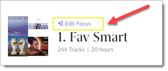

This is a longstanding issue with ARC. A workaround is to open the playlist edit function in Roon (not ARC) and close this function. It will then refresh the playlist and hopefully will download to your mobile device too.

Just to make sure my understanding is correct…
I select my smart list.. edit focus .. exit focus …
… and that should cause a refresh to Arc ..
Thanks . I will explore. Maybe that is why my Smart playlist does refresh from time to time. I did have a problem with the sort sequence .. but that seems ok now.

That should do the trick, hopefully.
Thanks.. I will test the next time I purchase new music.
I tested this morning.. initial fail… but …
When I reverse the sort and reverse the sort again… I found that my Smart List in IOS Arc had refreshed correctly.
I have the smart list sorted so the most recent additions to the smart list appear first.. (ie I want to list to my most recent favourites to appear at the top of the smart list.
I will monitor this going forward.
Hopefully, I can verify that my Arc SmartList is valid in advance of my next trip.
