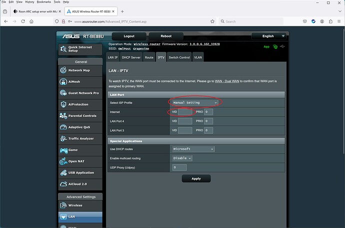

If your ISP supplies you with a router or ‘modem’ then, this modem/router should be put into ‘bridge mode’ which is also sometimes called ‘modem only mode’ if possible to elliminate the NAT layer associated with that device. Sometimes this is not possible because the ISP supplied router does not offer that functionality. If the router supplied by the ISP connects to an ONT and then your ASUS router connects to the ISP router, it may be possible to disconnect the ISP’s router and just configure the ASUS router to connect directly to the ONT and use, usually, PPPoE to authenticate to the ISP. You will need to know the username and password for PPPoE and you may also need to know a VLAN ID. The means by which you configure a VLAN ID (if required) differs between different ASUS routers. It is either part of the WAN settings (in the 802.1q settings section or, on older routers, it is in the IPTV setting tab in the LAN settings page (As shown below).

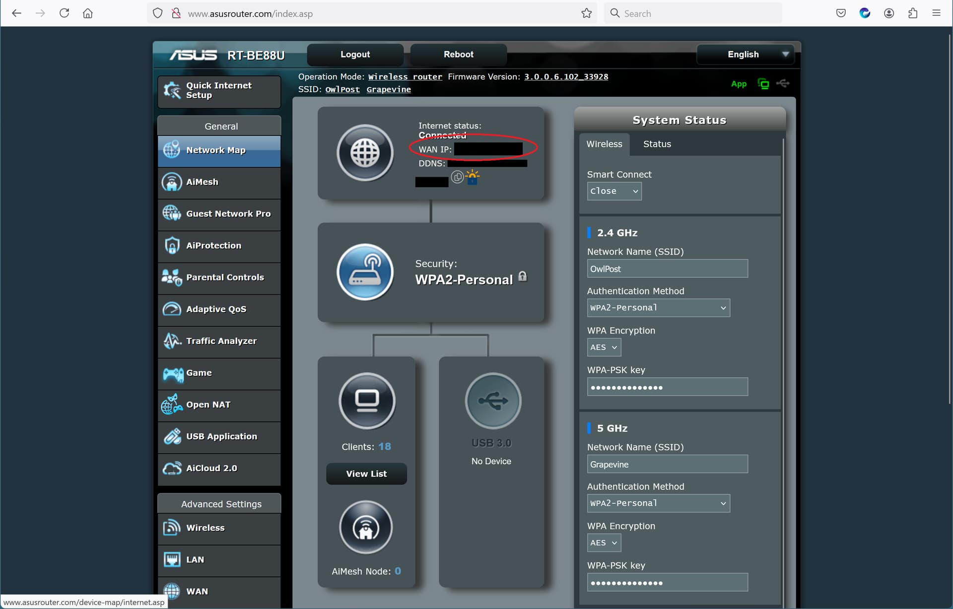

  • On the ISP router, confgure a port forwarding rule to forward TCP connection on the ARC port to the WAN side ip address of the ASUS router (as seen in the screen shot below - but note my ip address is blocked out):

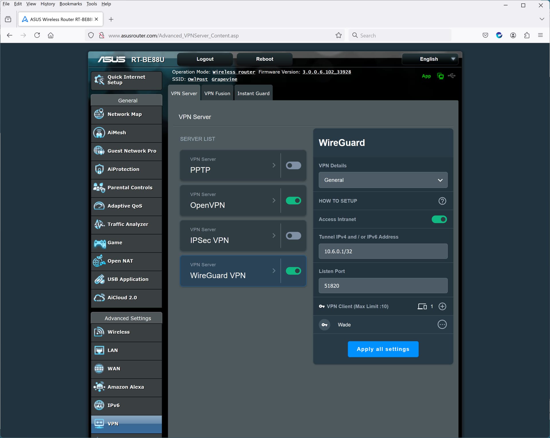

Note 2: Whilst Tailscale is the solution officially supported by Roon, your ASUS Router may directly support a Wireguard VPN which works in exactly the same way as Tailscale and can be used in substantially the same way. The ASUS wireguard configuration, if supported by your router, can be found under the VPN page:
Note: My setup also shows that an OpenVPN VPN Server is also configured. This is likely not an option that will work for you and should be ignored.
