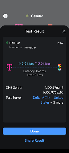

  • Check the speed of the internet connection using BMW’s hotspot with an app on your mobile phone or visit https://www.speedtest.net in a mobile web browser. Here’s an example:

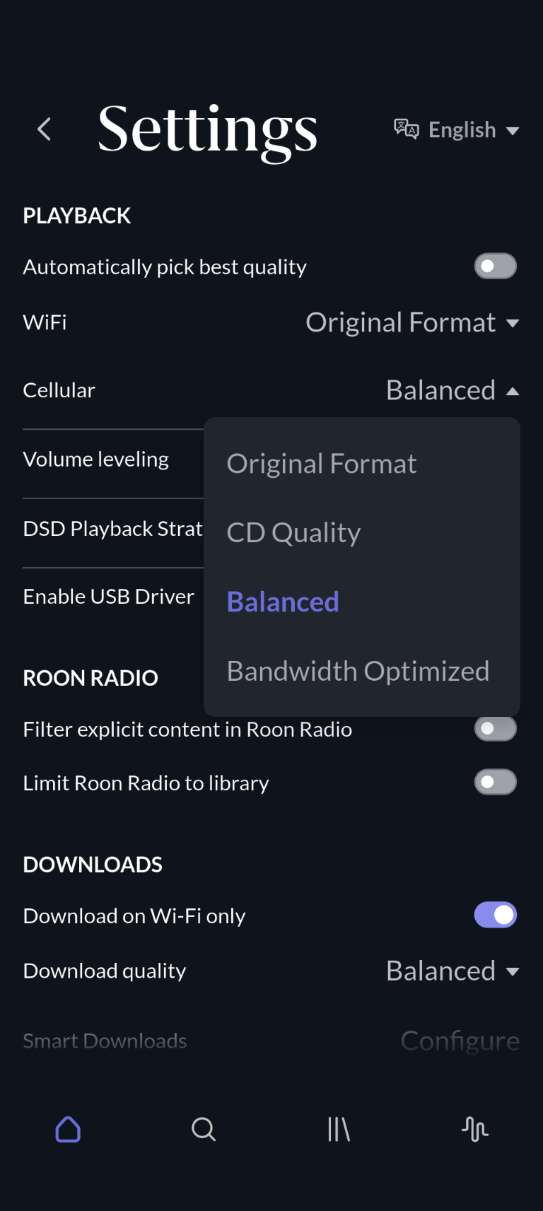

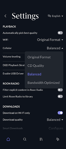

  • Check ARC’s playback setting to see the streaming quality (speed) it will use:

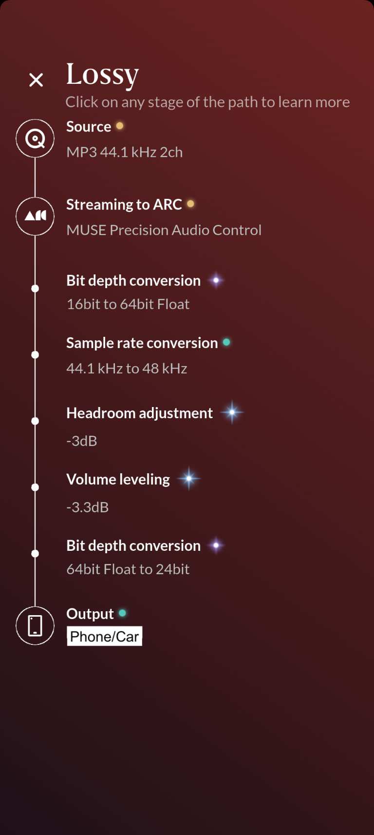

  • Play some music and confirm the signal path shows what’s streaming matches what the hotspot can keep up with:

  • The ARC FAQ has the following info about using “Balanced” playback…
    • Files: Lossy files will be transmitted to ARC in original format. Lossless files will be transcoded to 256kbps Opus
    • TIDAL: We will request “High Quality” from TIDAL, typically this means 320kbit AAC
      Qobuz: We will request “Standard Quality” from Qobuz, typically this means 320kbit MP3

I tested the speed, and cellular is about 24-26 mps, and ATT wireless is about 7-9, which exposes the problem. But, like I said, why did ARC work when it first came out? I can get ARC to work through Bluetooth connection to BMW idrive, but can’t control what I play as well as CarPlay. Also, I must control the iPhone, not the BMW screen and/or dial to chose music.

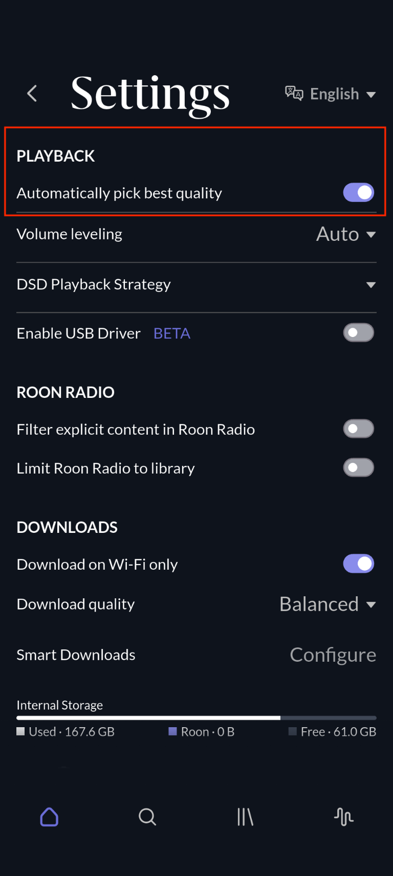

Works now, either from tweaking settings as you showed me or a stroke of luck. But I attempted copying your settings and it works. Thx.
