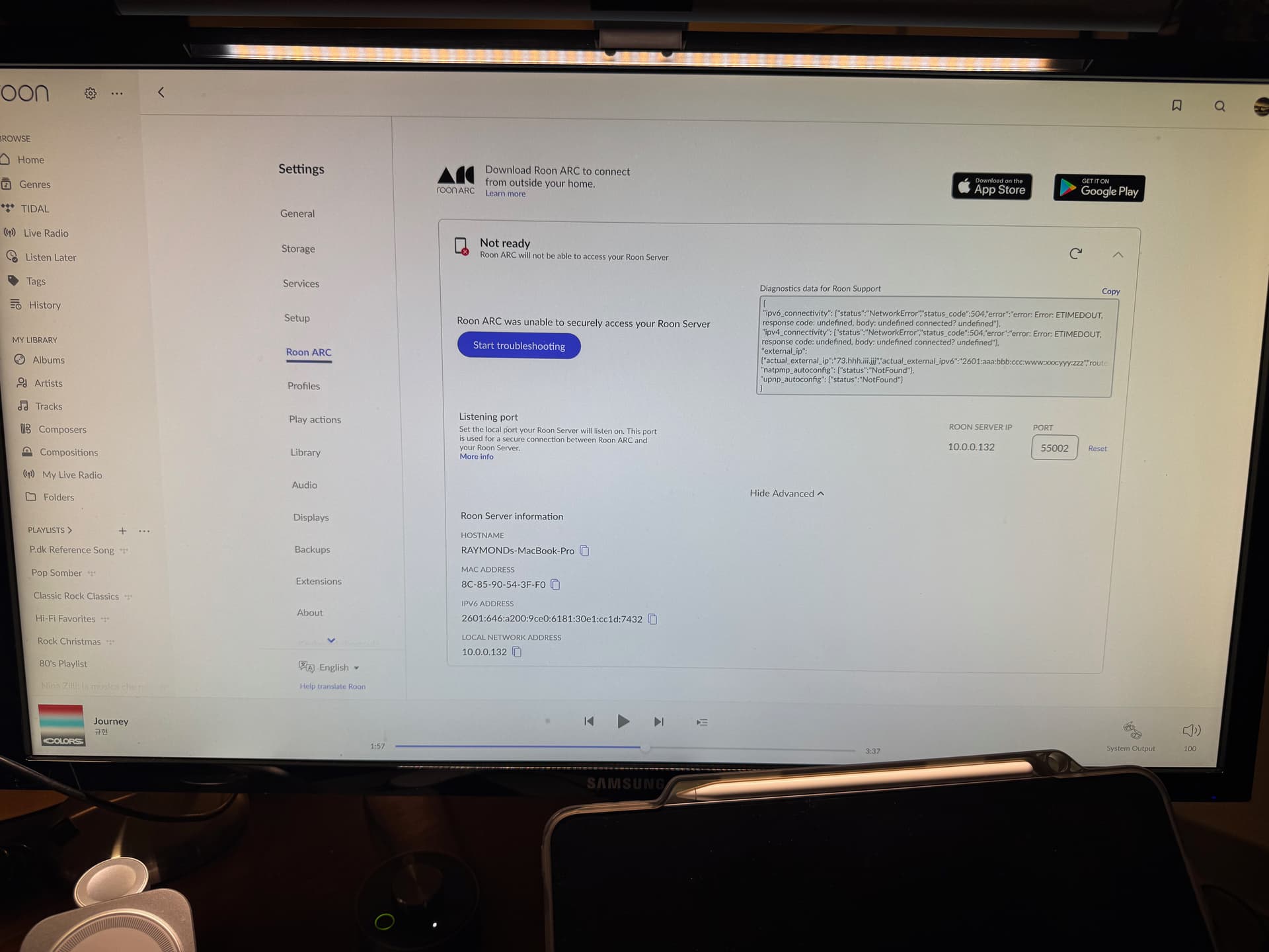

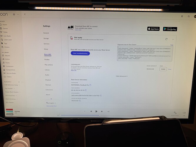

My Roon Arc was fine but starting yesterday, it stops working.
Xfinity
Xfinity Gateway Router
Wi-Fi
Mac OS Ventura 13.7.4

  1. Can you share a few screenshots of what you see when you try to use ARC?
  2. Please share the full error from Roon settings → Roon ARC.
  3. Does ARC work if you use it while your phone is on your home network?
  4. Have you made any changes to your home network recently?
2.{
“ipv6_connectivity”: {“status”:“NetworkError”,“status_code”:504,“error”:“error: Error: ETIMEDOUT, response code: undefined, body: undefined connected? undefined”},
“ipv4_connectivity”: {“status”:“NetworkError”,“status_code”:504,“error”:“error: Error: ETIMEDOUT, response code: undefined, body: undefined connected? undefined”},
“external_ip”: {“actual_external_ip”:“73.hhh.iii.jjj”,“actual_external_ipv6”:“2601:aaa:bbb:ccc:www:xxx:yyy:zzz”,“router_external_ip”:“null”},
“upnp_autoconfig”: {“status”:“NotFound”}
  1. Arc works well if I use it while my phone is on my home network.
  2. No changes have been made to my home Xfinity Gateway Router.
