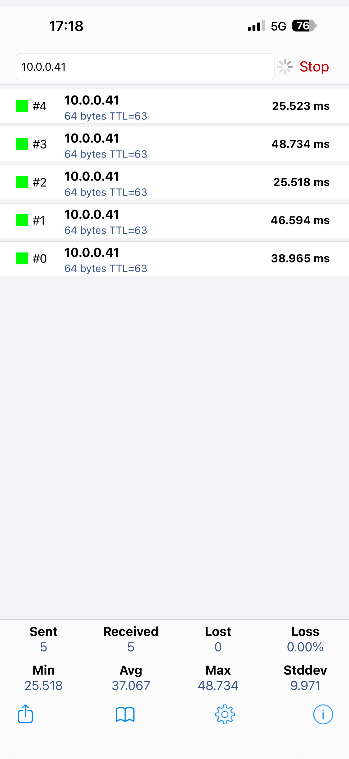

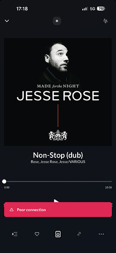

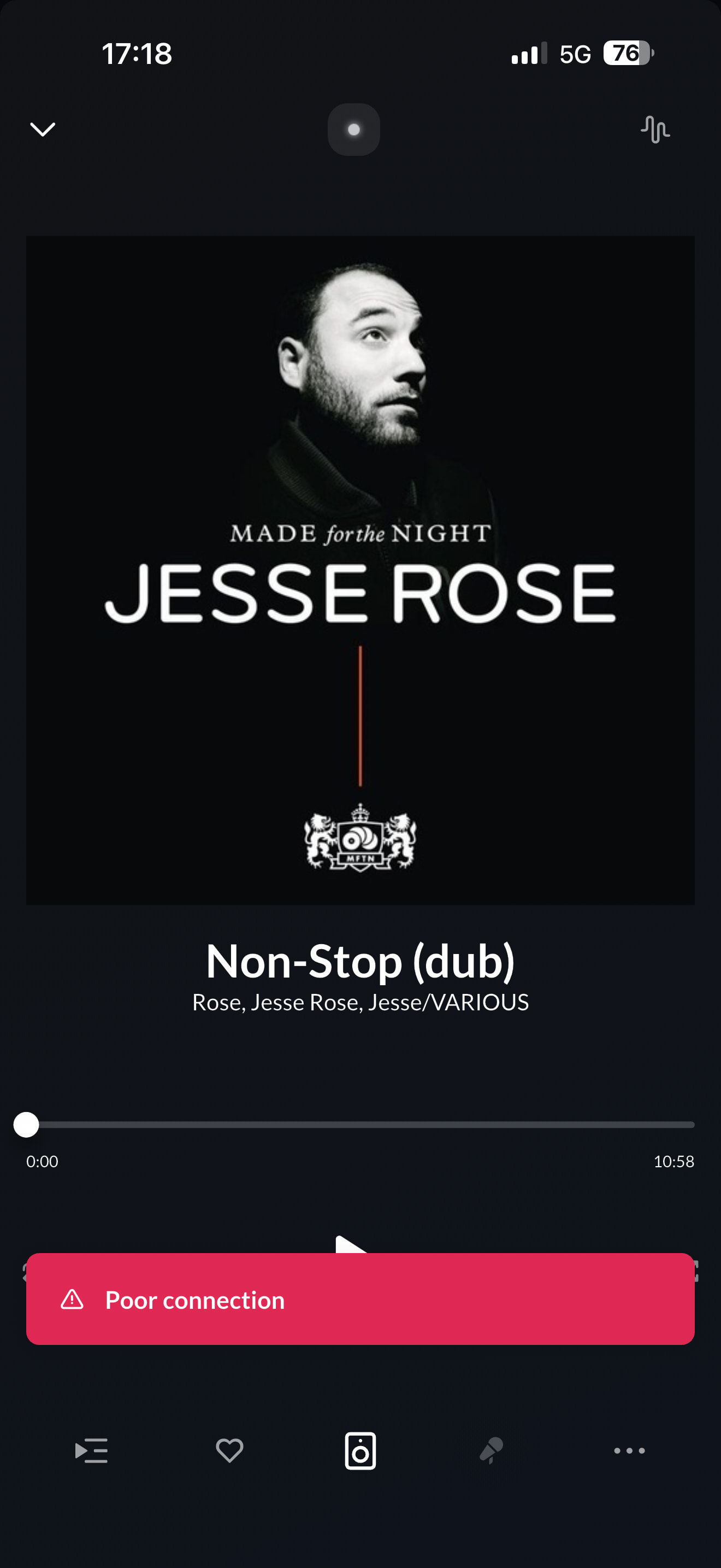

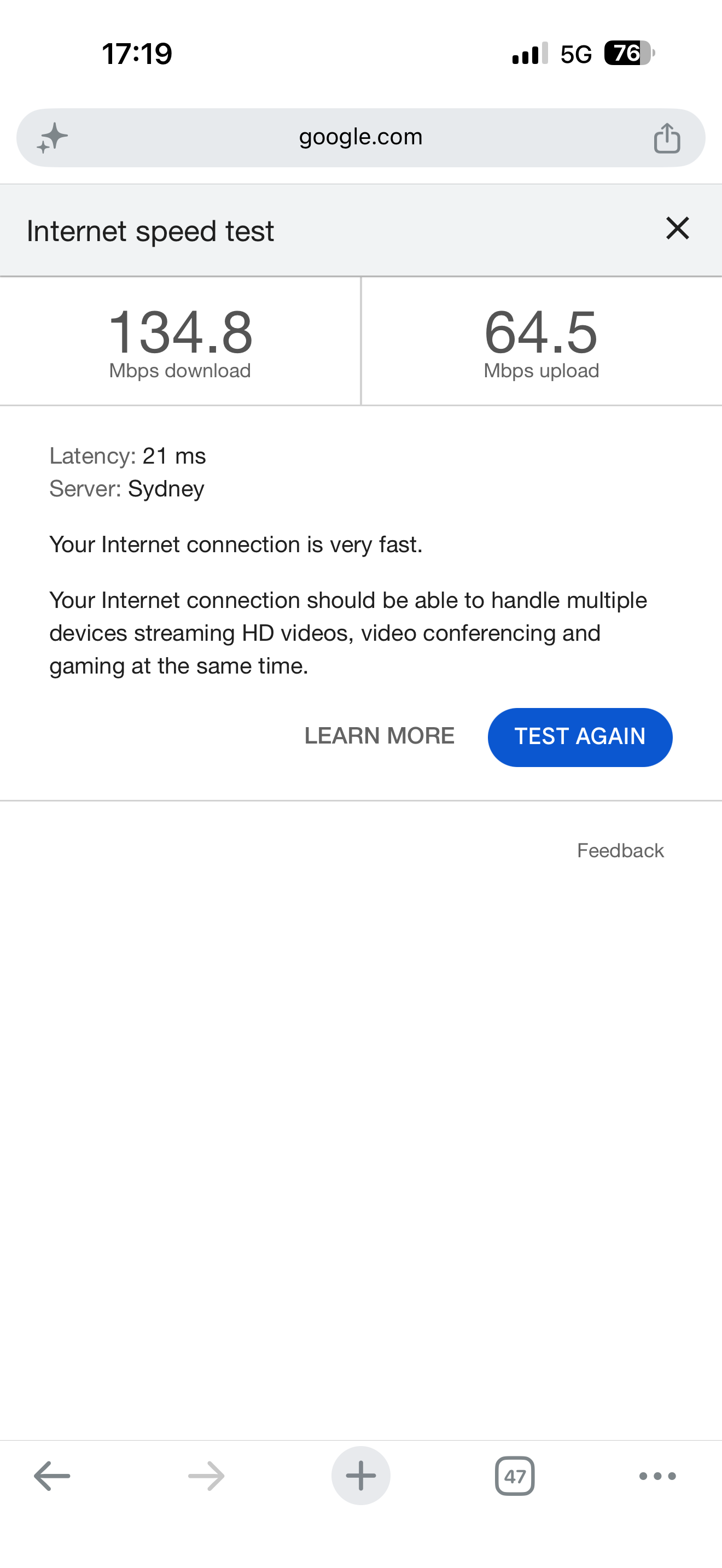

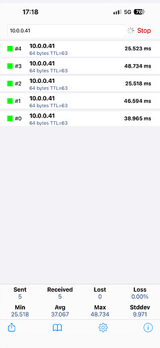

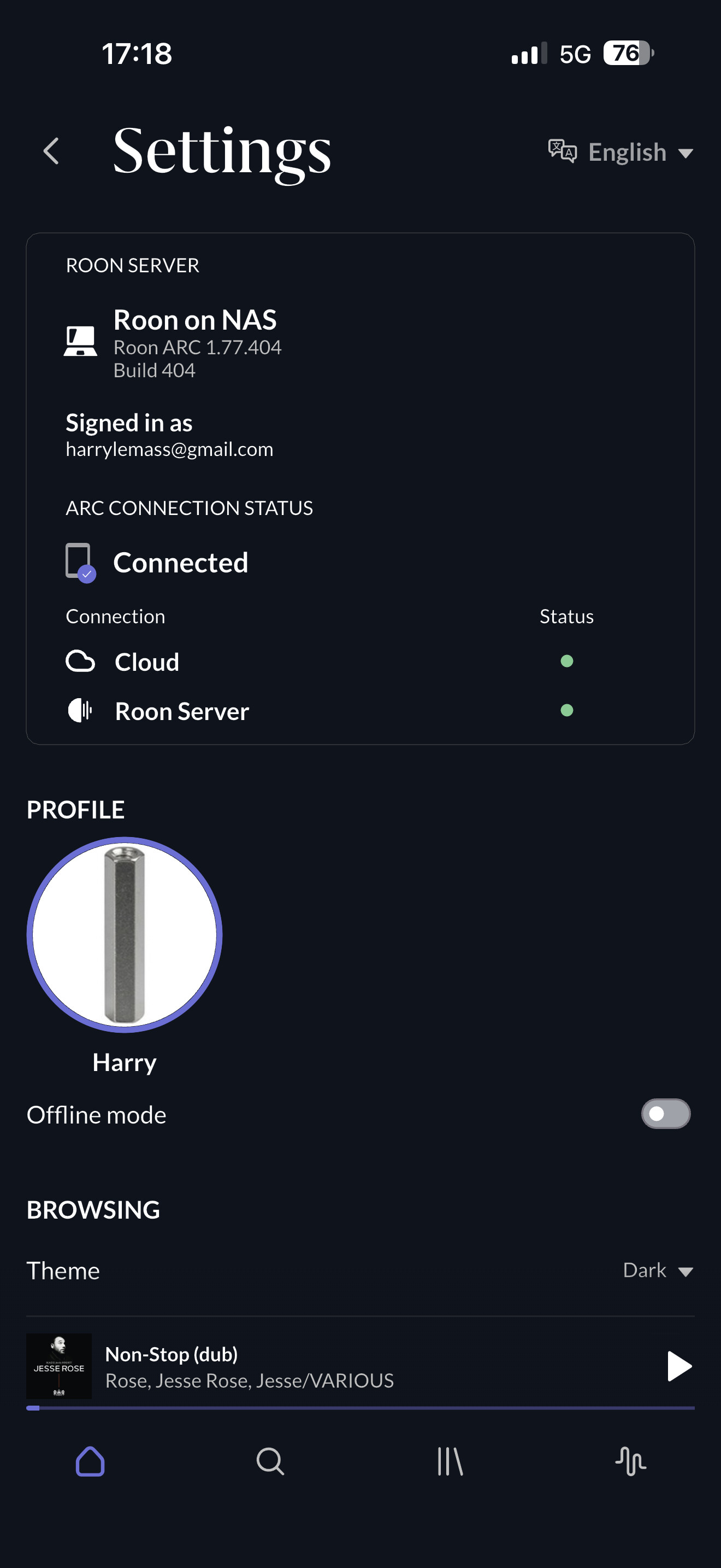

Hard to illustrate further but this paints the picture
  1. The poor connection warning on non downloaded song.
  2. The server status as all green
  3. Ping to the Roon server at home (over Tailscale and 5G) clearly accessible
  4. The 5G speed test - no worries.

Hi @MCMXC,
Thanks for the update! From the looks of it, in your 3rd image, you’re pinging 10.0.0.41 which is a private LAN IP, not a Tailscale IP (which would be 100.x.x.x).
This means ARC is routing through your LAN address rather than the Tailscale tunnel when you’re on 5G. That traffic can’t reach your home network from outside, which is exactly why streaming fails while the control handshake (which goes via cloud) still shows green.
Can you check your Tailscale IP for the server On the Tailscale admin console or the app? Then ping that address from your iPhone on 5G — does it respond?

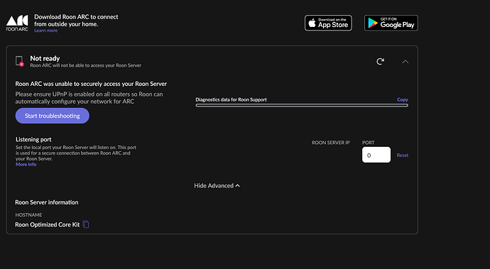

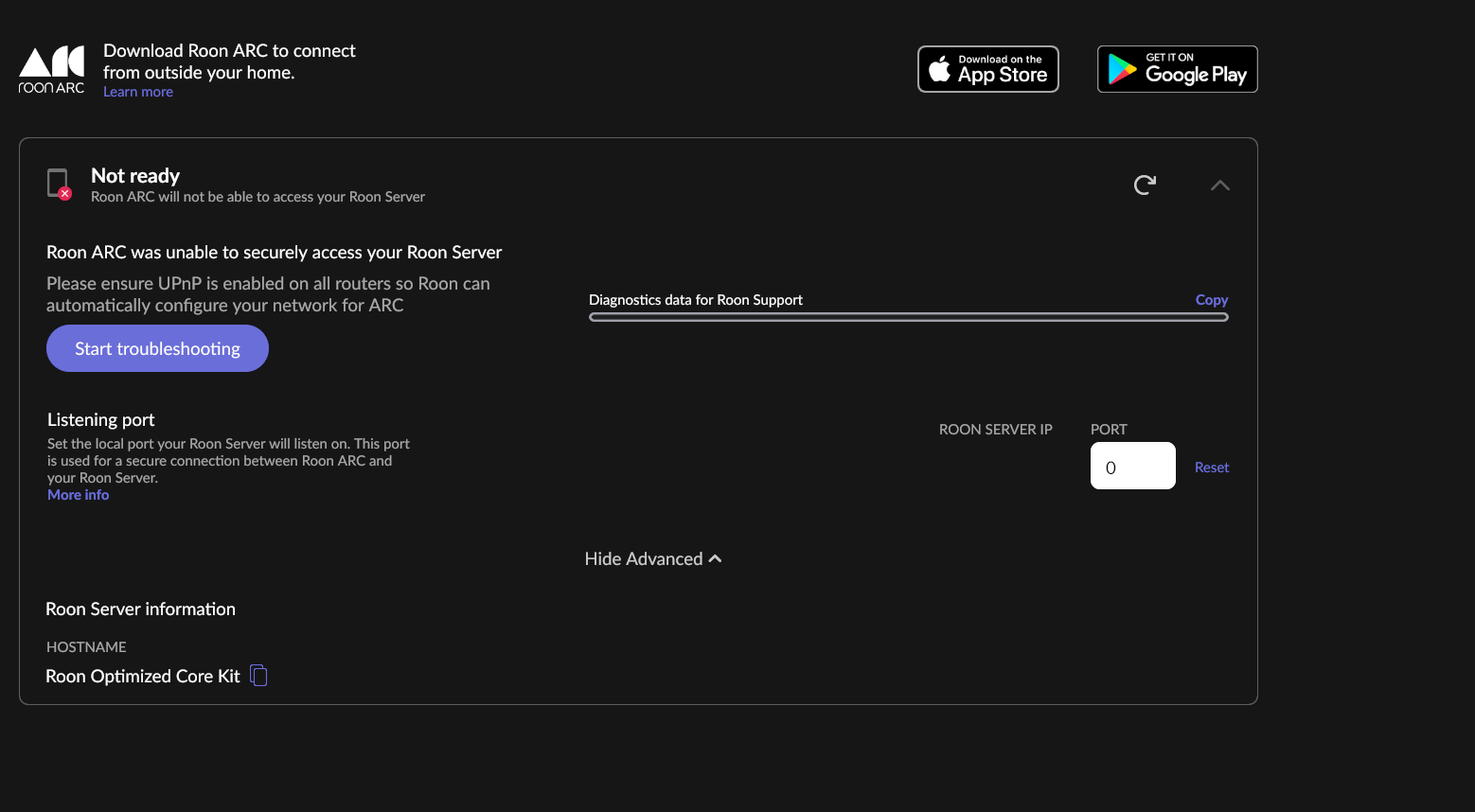

I only use local file streaming. Tidal (which I am not using currently) works flawlessly. All examples previously and going forward are all local files. There is no inbetween. The songs play quickly without buffering or a fails - long pause with the spinner over the play icon followed by the “Poor connection” error box.
My Roon Arc setting on Roon appear like this - no diagnostics to speak of, that box is empty.
