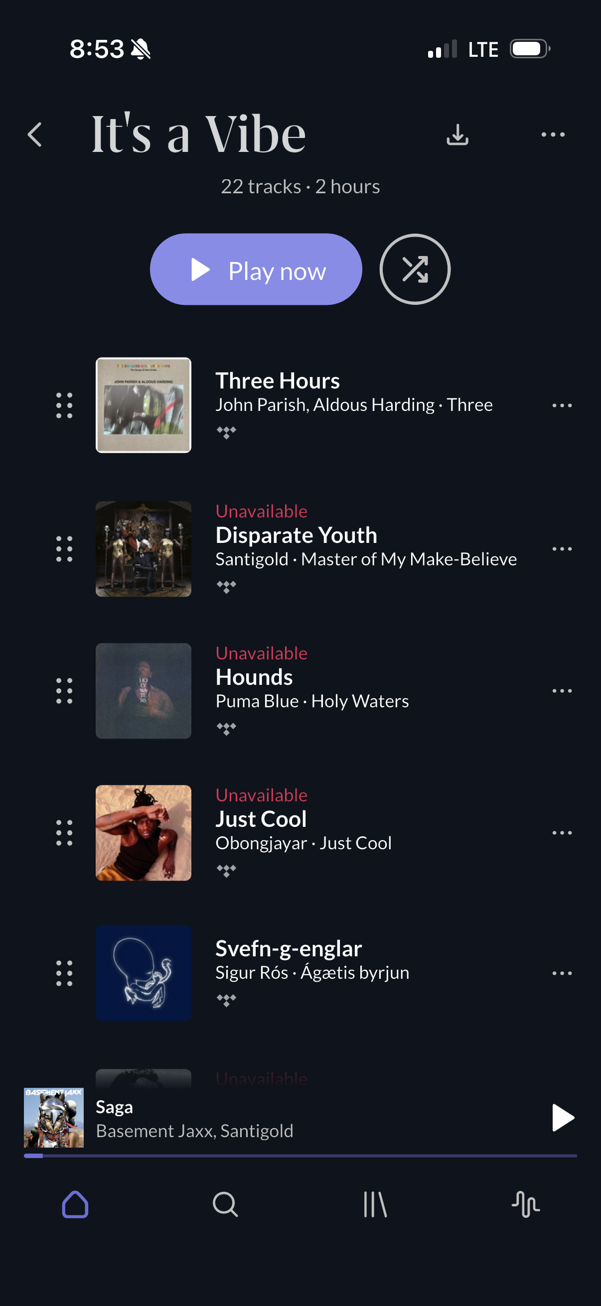

· Roon Arc says most tidal tracks in playlists are unavailable. Some play while others don't. The same tracks play fine on Roon itself. I've tried resetting my core and logging our and back into tidal.

I don’t use VPNs. Roon and Arc are being used in the same city. The unavailable tracks are being streamed from Tidal; they should be the same file formats.
I 1) closed arc on my phone 2) signed out of tidal under services in Roon 3) re-opened Arc 4) signed back into Tidal. Only change was that now all of the tracks were unavailable instead of most. Closed and re-opened Arc for good measure. No change from original problem–all the same tracks are unavailable.
Any further suggesgions?

Anything I can do to fix this problem? Most playlists that rely on Tidal tracks are unplayable from “unavailable” tracks. If I search for anything through the Roon Arc app, however, it plays fine–including tracks that are unavailable in existing playlists.
