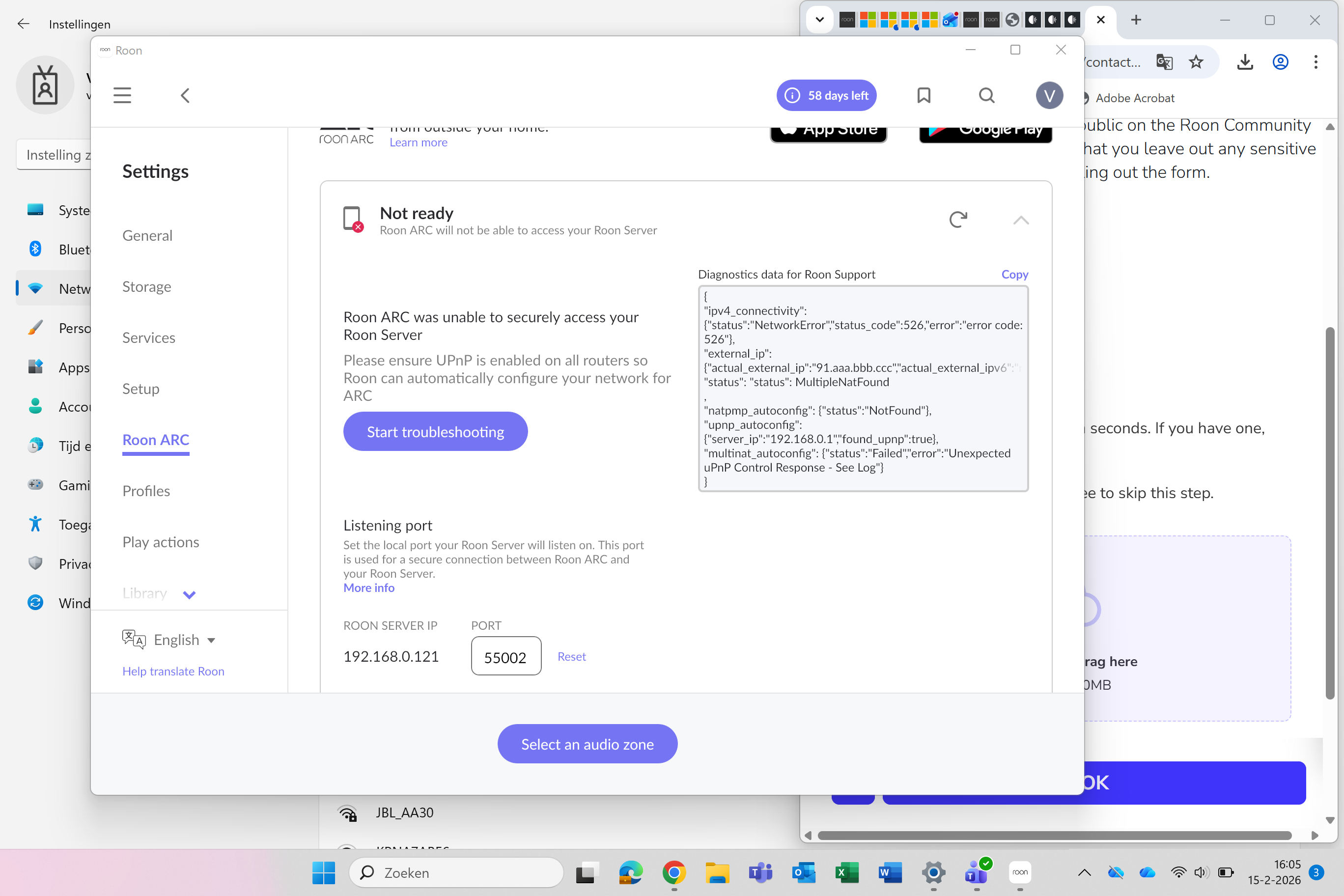

Roon ARC unable to access due to Network Error 526 and MultipleNatFound status (ref#8NXF8C)
· Other ARC issues
· roon ARC will not be able to access your room server,{
"ipv4_connectivity": {"status":"NetworkError","status_code":526,"error":"error code: 526"},
"external_ip": {"actual_external_ip":"91.aaa.bbb.ccc","actual_external_ipv6":"null","router_external_ip":"null"},
"status": "status": MultipleNatFound
"natpmp_autoconfig": {"status":"NotFound"},
"upnp_autoconfig": {"server_ip":"192.168.0.1","found_upnp":true},
"multinat_autoconfig": {"status":"Failed","error":"Unexpected uPnP Control Response - See Log"}
· tp-link archer AX11000, no vpn,
