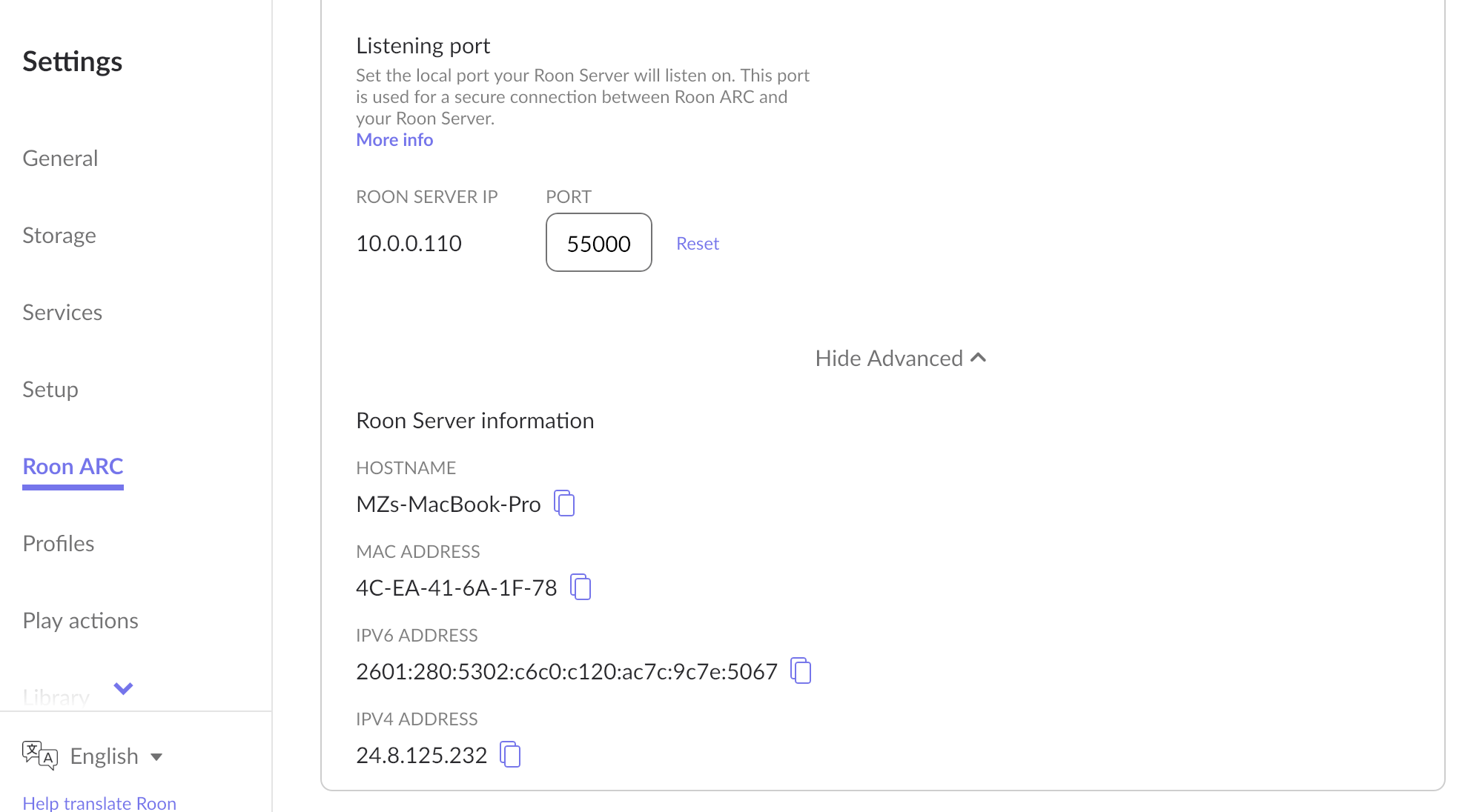

Using MacBook Pro M3, macOS Tahoe 26.4 as Roon Core
In Roon>Settings>Roon ARC, Message: "Not Ready, Roon ARC will not be able to access your Roon Server. Roon ARC was unable to securely access your Roon Server. Please ensure UPnP is enabled on all routers so Roon can automatically configure your network for ARC."

Since uPnP isn’t an option, you’ll need to set up a Manual Port Forward in the Xfinity app. It sounds technical, but it’s just three steps:
  1. Open the Xfinity App: Go to WiFi > View WiFi details > Advanced settings > Port Forwarding.
  2. Select your MacBook Pro: Choose your M3 MacBook from the list of connected devices.
  3. Enter the Details:
  • Internal / External Port: 55000 (This is the default Roon port).
  • Protocol: TCP (or TCP/UDP if “Both” is an option).
  1. Save/Apply.

Success! Thanks, enjoy the music…
