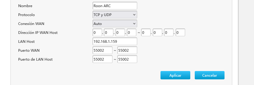

Roon ARC unable to access the server (ref#GV304Y)
· Other ARC issues
· Roon ARC cannot access the server
· ZTE F8748

Hi @J.A,
A quick scan of diagnostics shows that your internet service provider has likely implemented carrier-grade network address translation for your account (CG-NAT).
Unfortunately, port forwarding is blocked above the level of your local network. You’ll need to either:
  1. request a dedicated external IP address from your ISP
or
  1. set up a third-party NAT traversal method. We usually recommend Tailscale. Here’s a guide:
Please let us know if we can help. Thank you!
