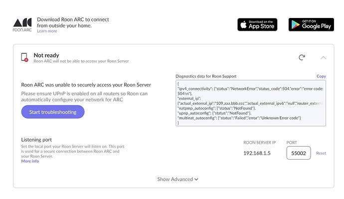

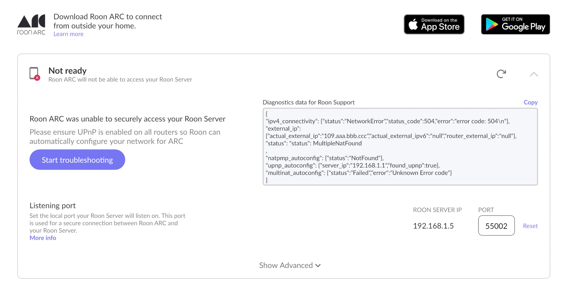

The following diagnostic data is showing following running the RoonARC test ... After running this test it returns "Not Ready" etc with the following
"ipv4_connectivity": {"status":"NetworkError","status_code":504,"error":"error code: 504
"external_ip": {"actual_external_ip":"109.aaa.bbb.ccc","actual_external_ipv6":"null","router_external_ip":"null"},
"status": "status": MultipleNatFound
"natpmp_autoconfig": {"status":"NotFound"},
"upnp_autoconfig": {"server_ip":"192.168.1.1","found_upnp":true},
"multinat_autoconfig": {"status":"Failed","error":"Unknown Error code"}

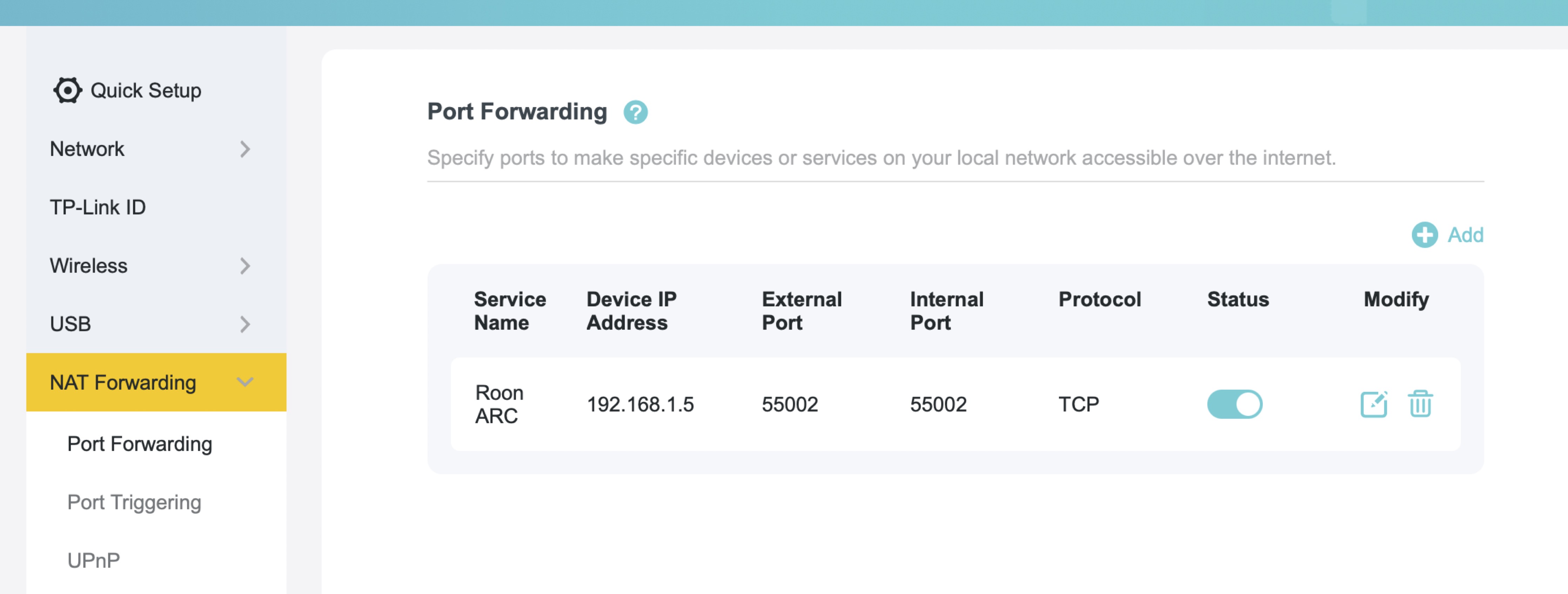

Port Forwarding - the Device Address is the same as the MacOS Roon Server 192.168.1.5 & the Int/Ext Port is 55002 with the protocol =TCP

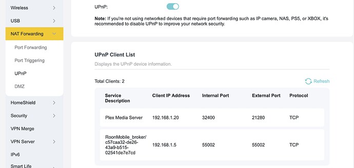

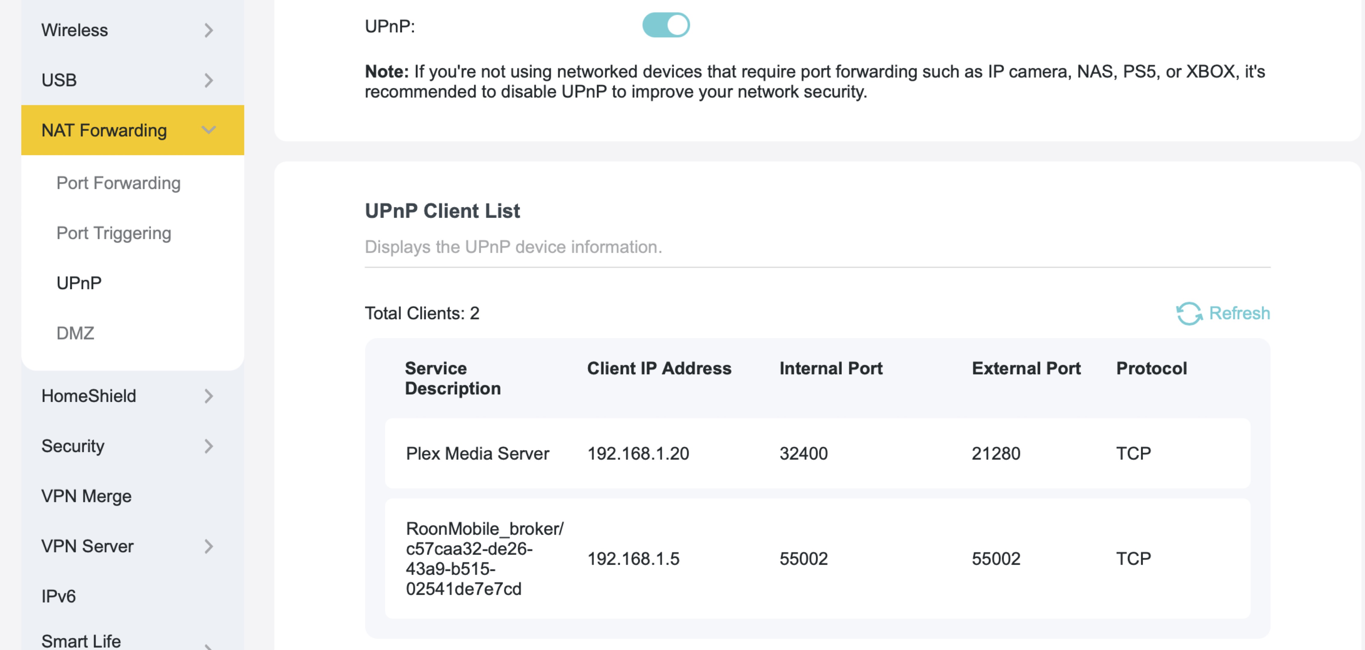

UPnP - a "client" list is available... showing
Client : RoonMobile_broker/c57caa32-de26-43a9-b515-02541de7e7cd
Client IP Address : 192.168.1.5
Int/Ext Port : 55002
Protocol : TCP

Unfortunately this meant I had to re setup the UPnP settings etc... but now I am unable to connect with RoonARC... here are the diagnostics data showing for Roon Support when I go to the Settings, RoonARC page and try to run the test....
After running the connection test it says "Not Ready" and
{"ipv4_connectivity": {"status":"NetworkError","status_code":504,"error":"error code: 504
"upnp_autoconfig": {"status":"NotFound"},
"multinat_autoconfig": {"status":"Success","error":"No Error","routers":1,"routers_mapped":1}

I logged into the router to check the Nat Forwarding rules. UPnP was enabled with the UPnP Ports Forwarded list heavily populated with “Tailscale opened” ports.
I rebooted the Mac Studio and then turned off UPnP, which cleared the auto generated Tailscale forwarding rules and re-enabled UPnP.
I rebooted both the router and the Mac Studio. On the router I went back to the Nat Forwarding Section.

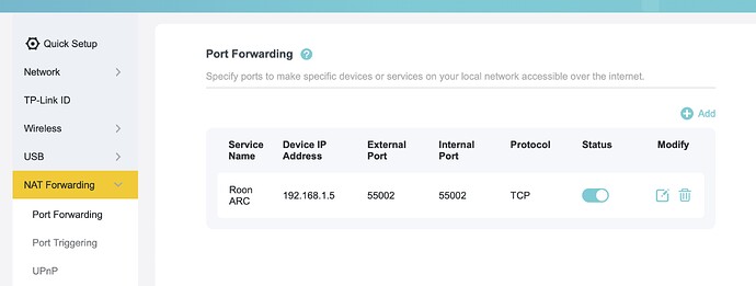

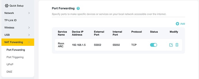

  • In the Port Forwarding Section I had only the 55002 port manually forwarded.
  • In the UPnP section There are now 2x Entries
    • Plex Media Server (automatically generated by Plex / Plexamp)
    • RoonMobile_broker/c57caa32-de26-43a9-b515-02541de7e7cd

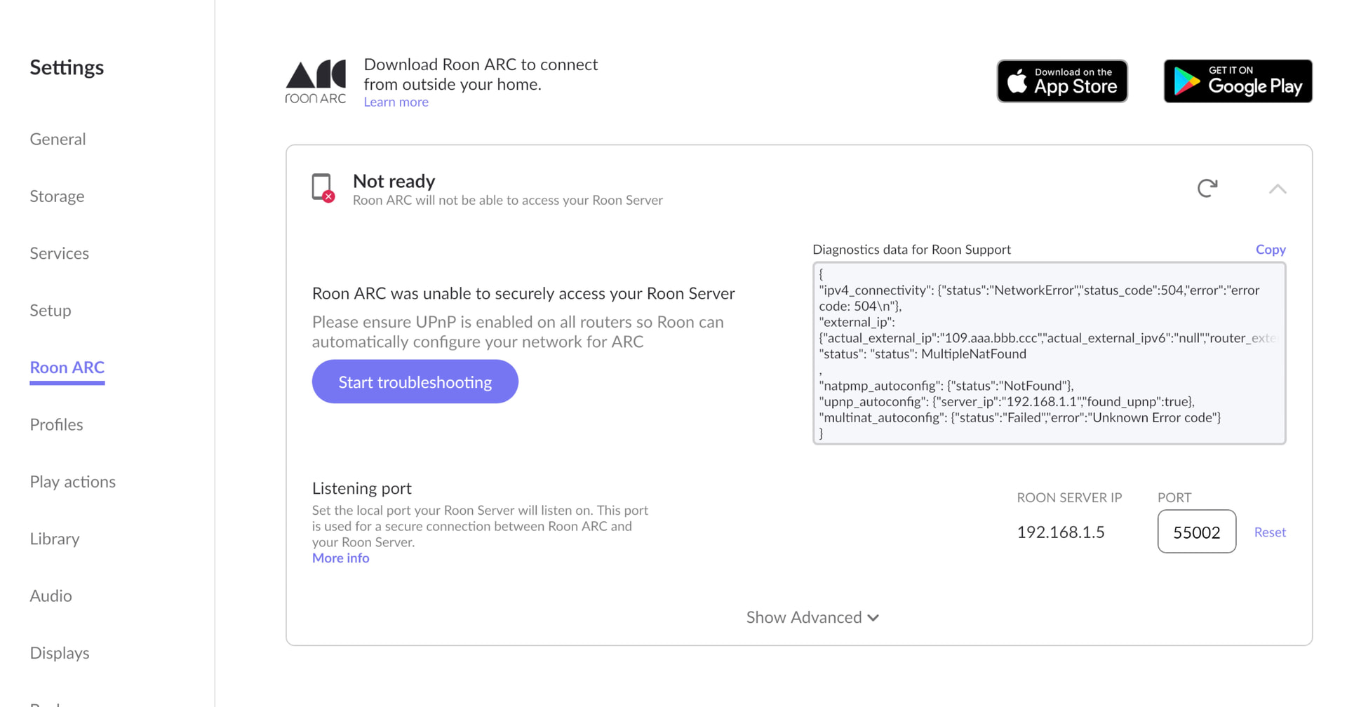

When I restarted Roon on the Mac Studio and went to… “Settings / Roon ARC”… it immediately started “Testing”… and then came up with “Not Ready”…
I have attached the screenshot.

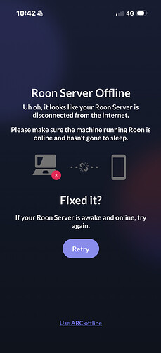

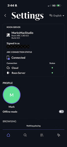

When I went to Roon ARC on the phone… on the “Settings” screen it was still looking for the Server… it probably took about 10 mins before I could see that it was having some success… but it kept dropping the connection… just when it had just looked like it was establishing a firm handshake… after about 20 mins it was stable enough to play a file.

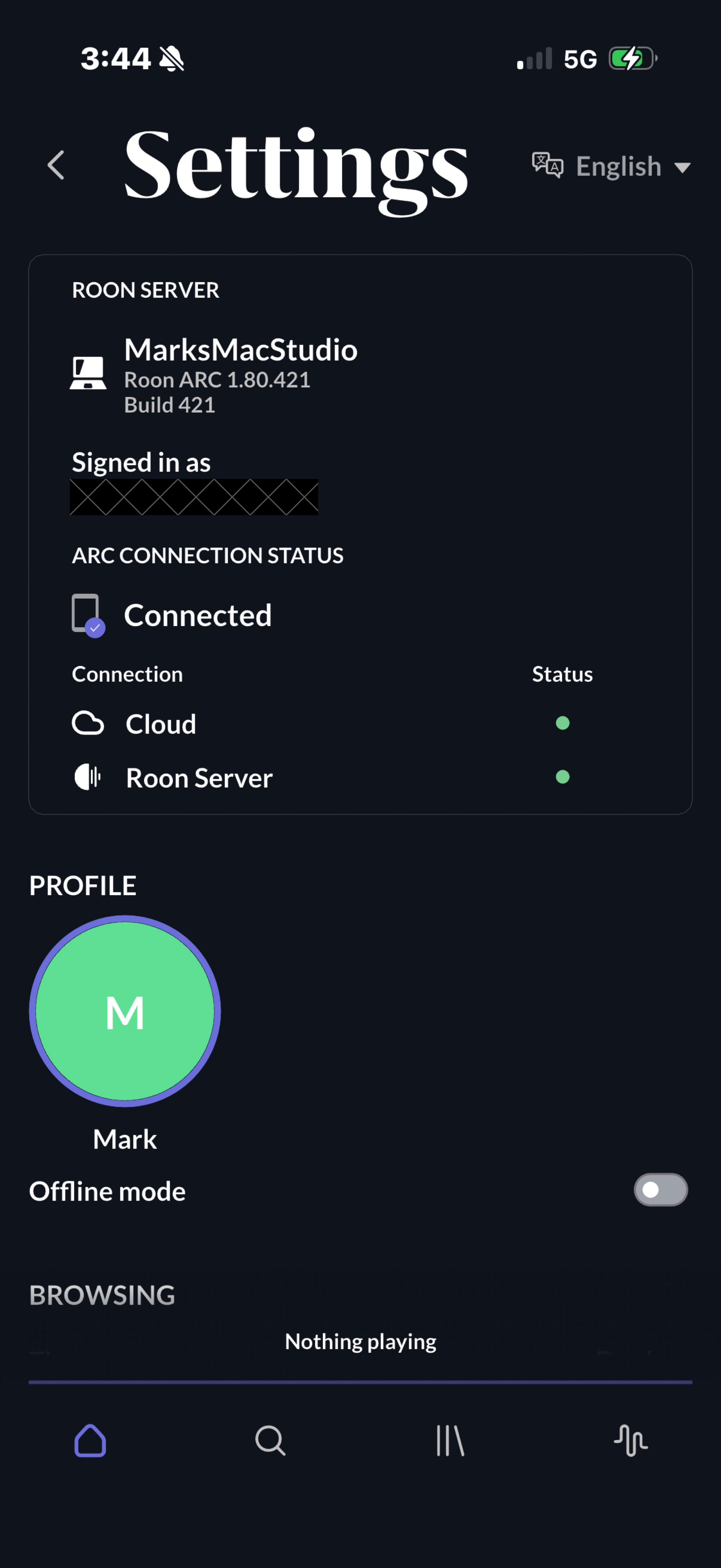

±45 mins later, I have now been listening via Roon ARC for the last 15 minutes with no breaks :+1:
After a number of “connecting” cycles on the phone I have a settled connection - see screenshot

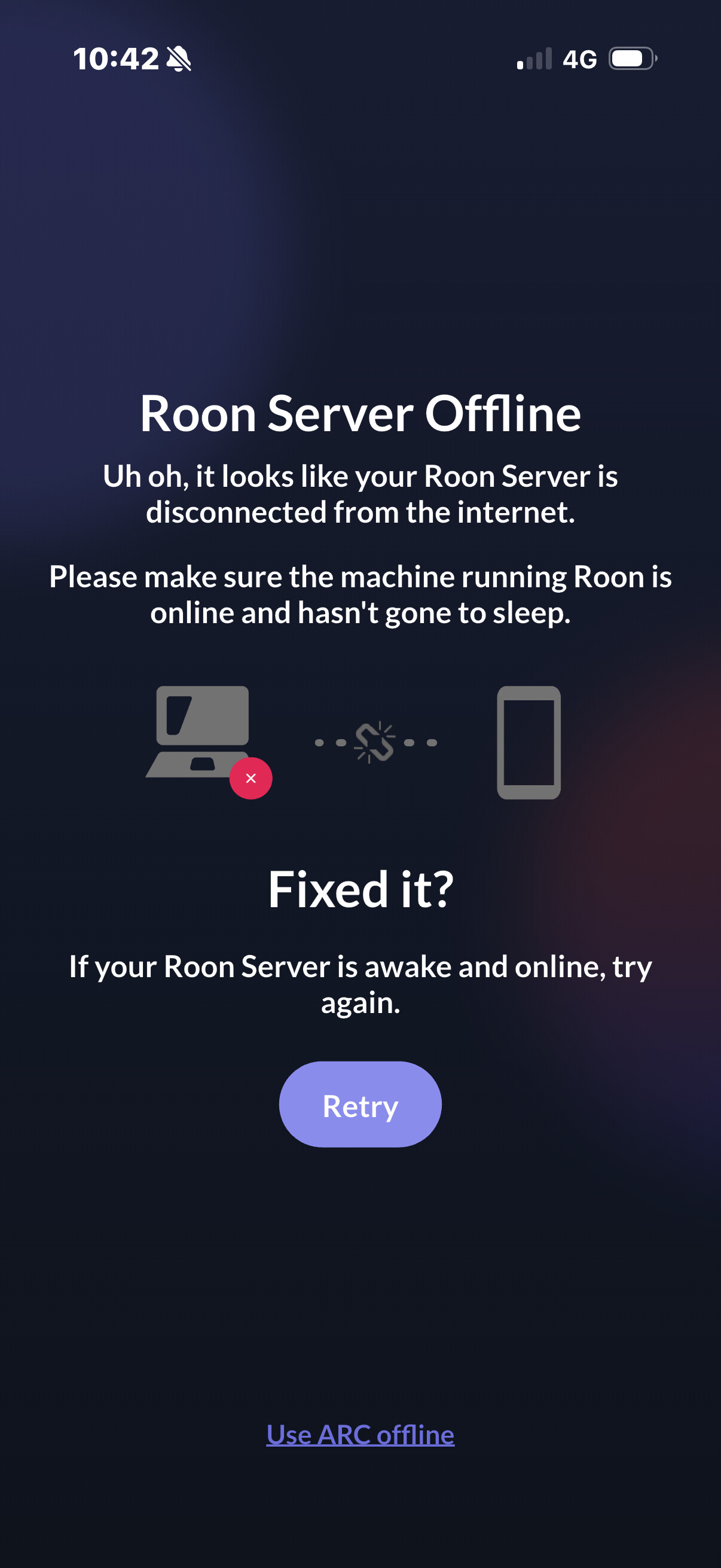

I have just been out for a walk and yet again, after a few hundred yards it loses the connection and then struggles to reconnect.
It again took about 15-20mins to reconnect while I have been writing this reply at my computer… Roon ARC has again been playing for the last 15-20mins - still in Offline mode with the wifi on my phone switched off.
Do these further diagnostic screenshots help? I am not sure that this connection is stable. I will try to use it again when I go out for a morning walk… see if it continues to lose the connection a few hundred yards from the house.

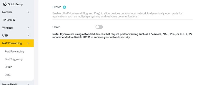

To keep matters simple, disable Tailscale, turn off UPnP, and delete the UPnP rules. Then, make sure you have just one manual port forwarding rule for Roon.
Once this is done, please post a screenshot of Settings → Roon ARC including any diagnostic message.
Ok… ! Thanks for helping.

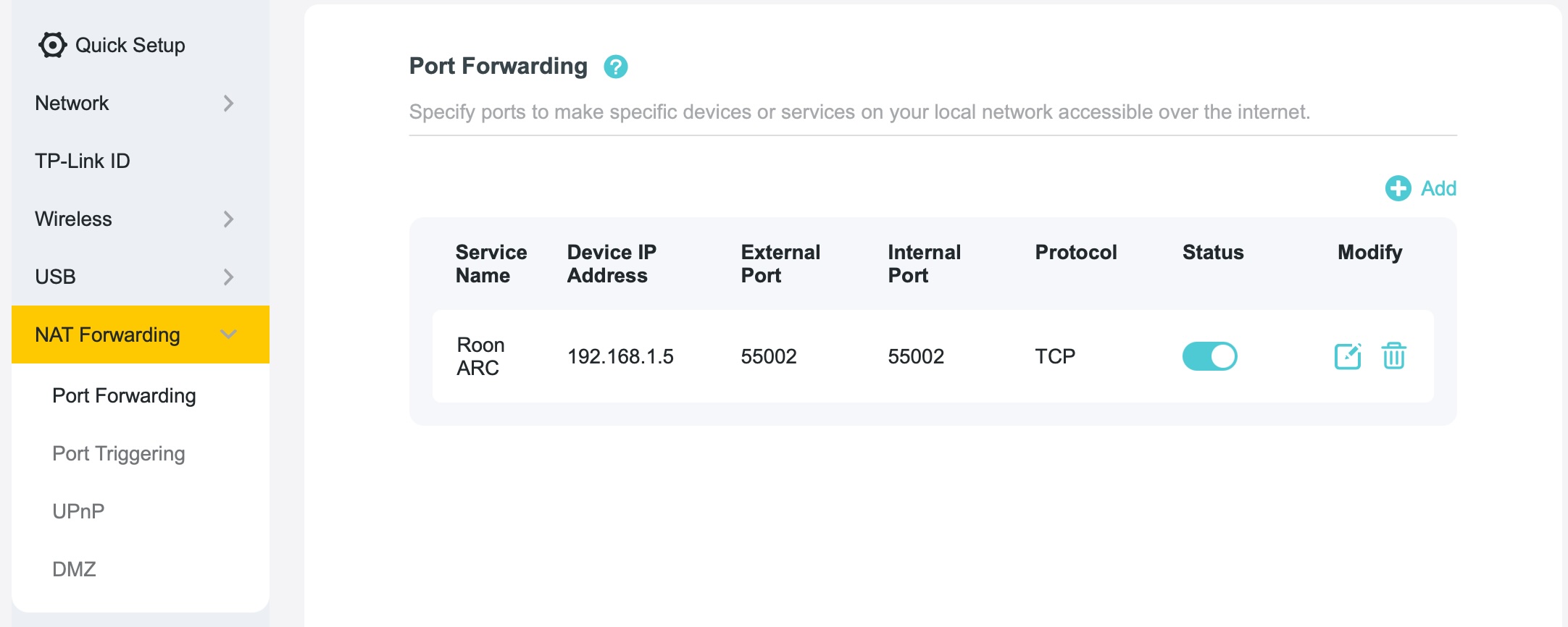

I switched off UPnP and only left the Port Forwarding rule for Roon. See Screenshots

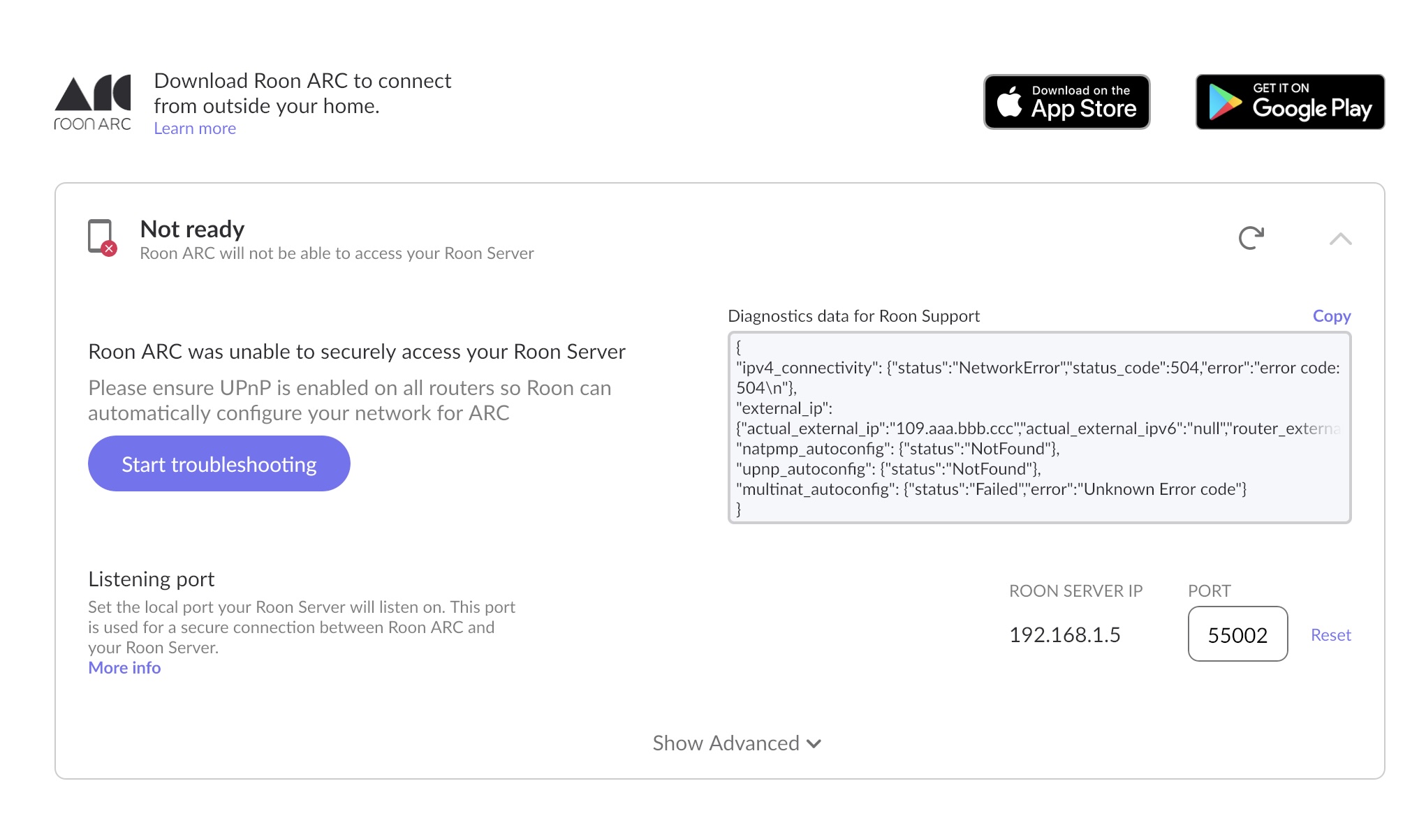

this was the Roon diagnostic “response”… on the Mac Studio…
and on the phone…
Some additional information… I called my ISP and asked them if the supplied modern was in “Bridge” mode… which they confirmed … they also mentioned that at the service provider level they were supplying the internet via CG-NAT (Carrier Grade Network).
The diagnostic messages point to a double NAT issue, which is caused by CGNAT. Port forwarding will not work for you. Consequently, your best option is to use Tailscale (unless your ISP can provide you with a fixed IPv6 address.)
