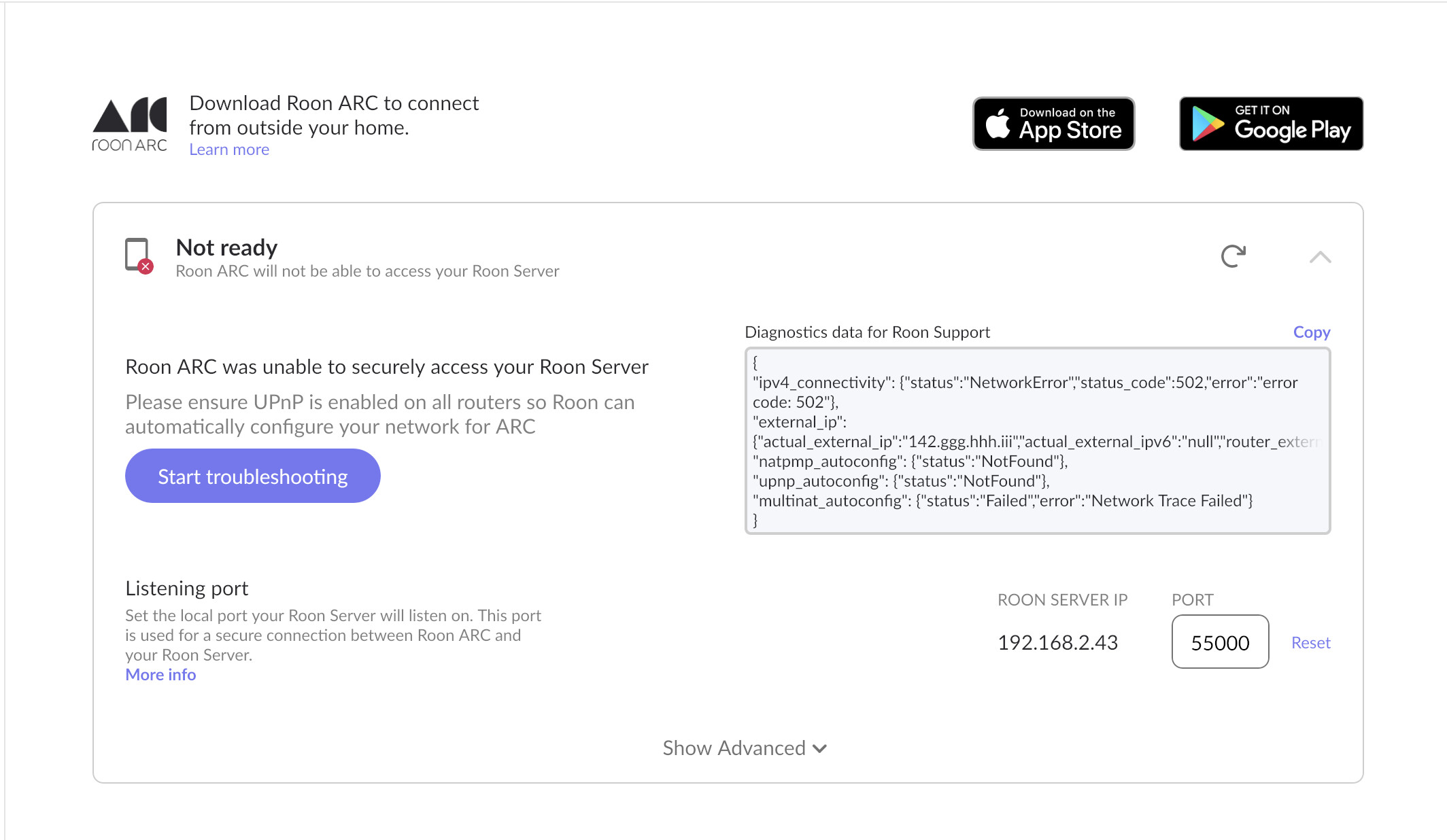

ARC Status
· ARC is *Not Ready*
Roon Error Code
· “natpmp_autoconfig”: {“status”:“NotFound”}, “upnp_autoconfig”: {“status”:“NotFound”} }

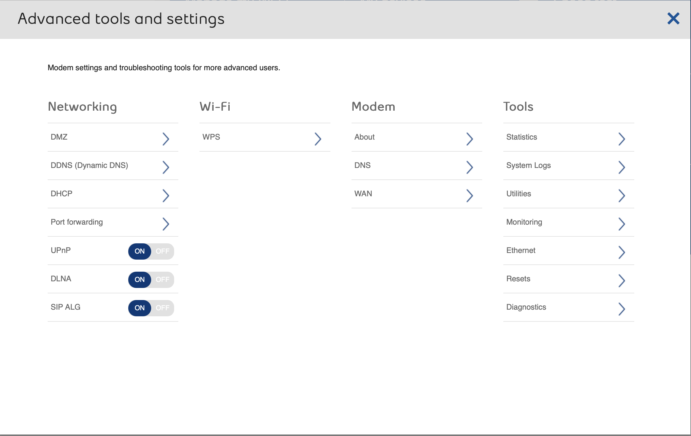

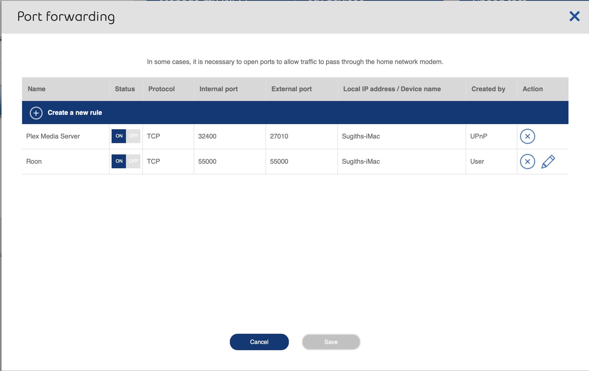

Thanks, but all that was done years ago. It’s only recently that (with no conscious changes to setup) Arc stopped connecting. (See screenshots showing Port Forwarding set in modem, UPnP set in modem and Firewall set to allow Roon connections.)

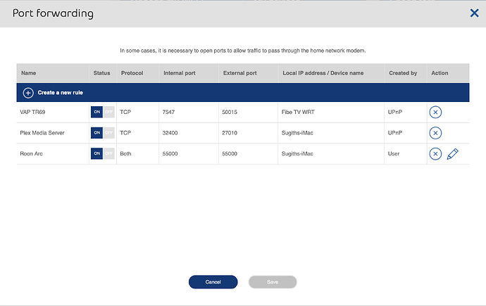

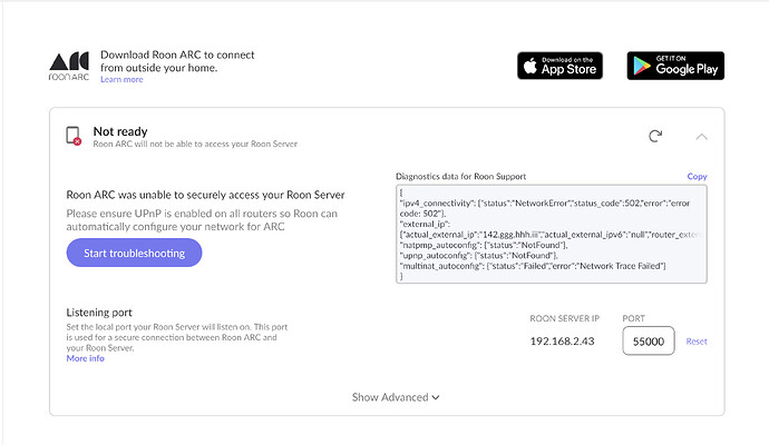

I followed the above instructions, turned off wi-fi, power cycled modem and checked port forwarding but ARC status in Roon remains NOT READY. (See screenshots for portfowarding and Roon ARC settings.)
ARC still can’t connect to Roon Server.

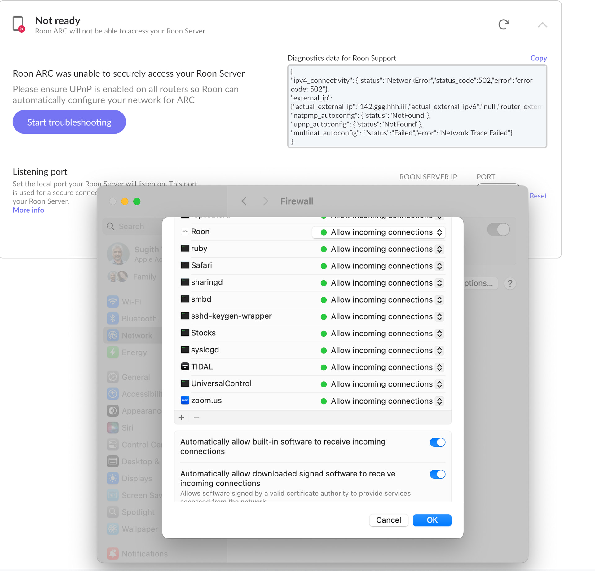

Turning firewall off, enables Roon ARC to connect. But as posted, giving Roon an exception to allow connections in firewall, and turning firewall on, causes Roon ARC to be NOT READY.
I’m unsure how to resolve the firewall issue since the exception was in firewall settings and Roon ARC did work.

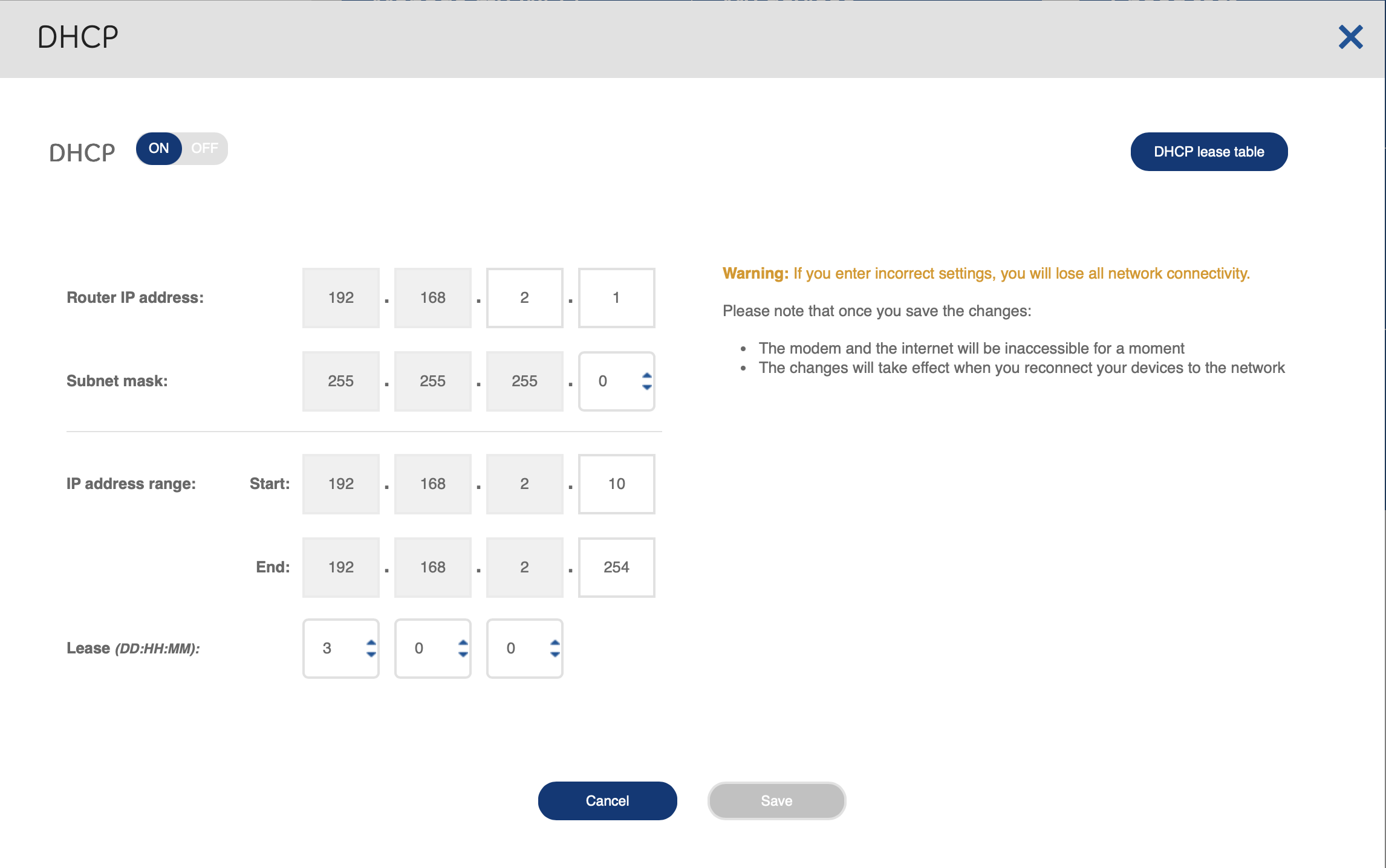

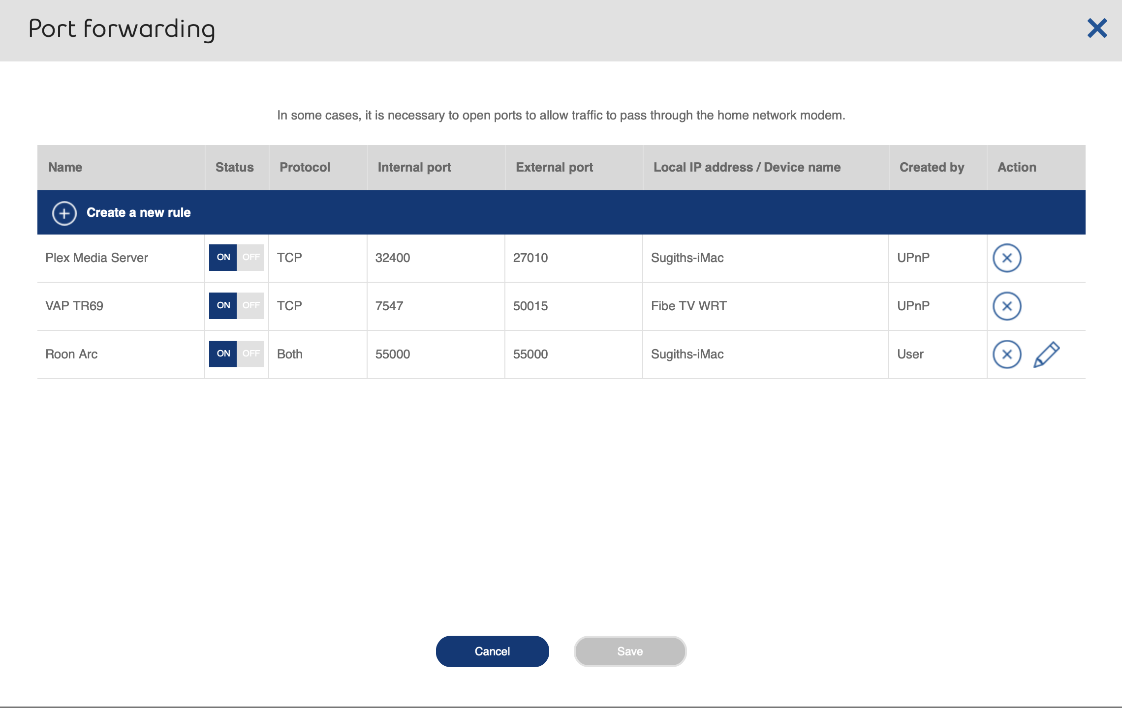

No, deleting and re-creating the rule did not change the error message in Roon. Note, that despite entering IP address manually, it does still appears as Sugiths-Imac. (See screenshot.)
Also, I’m unclear how to reserve DHCP. (Please see screenshot of DHCP settings page.)

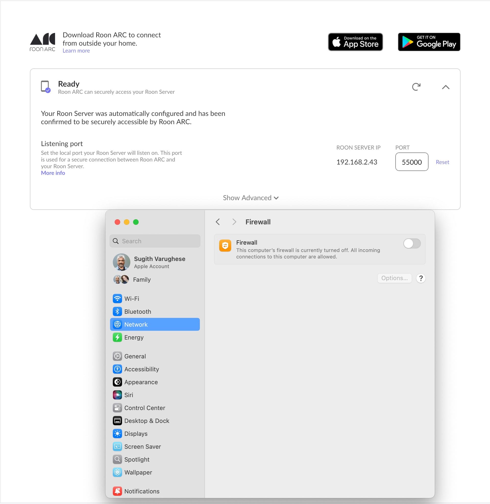

I can get Roon error message to disappear only if I turn Firewall OFF. (See screenshot.)
But when Firewall is on and Roon is enabled as an exception, Roon is NOT READY again. (See screenshot.)

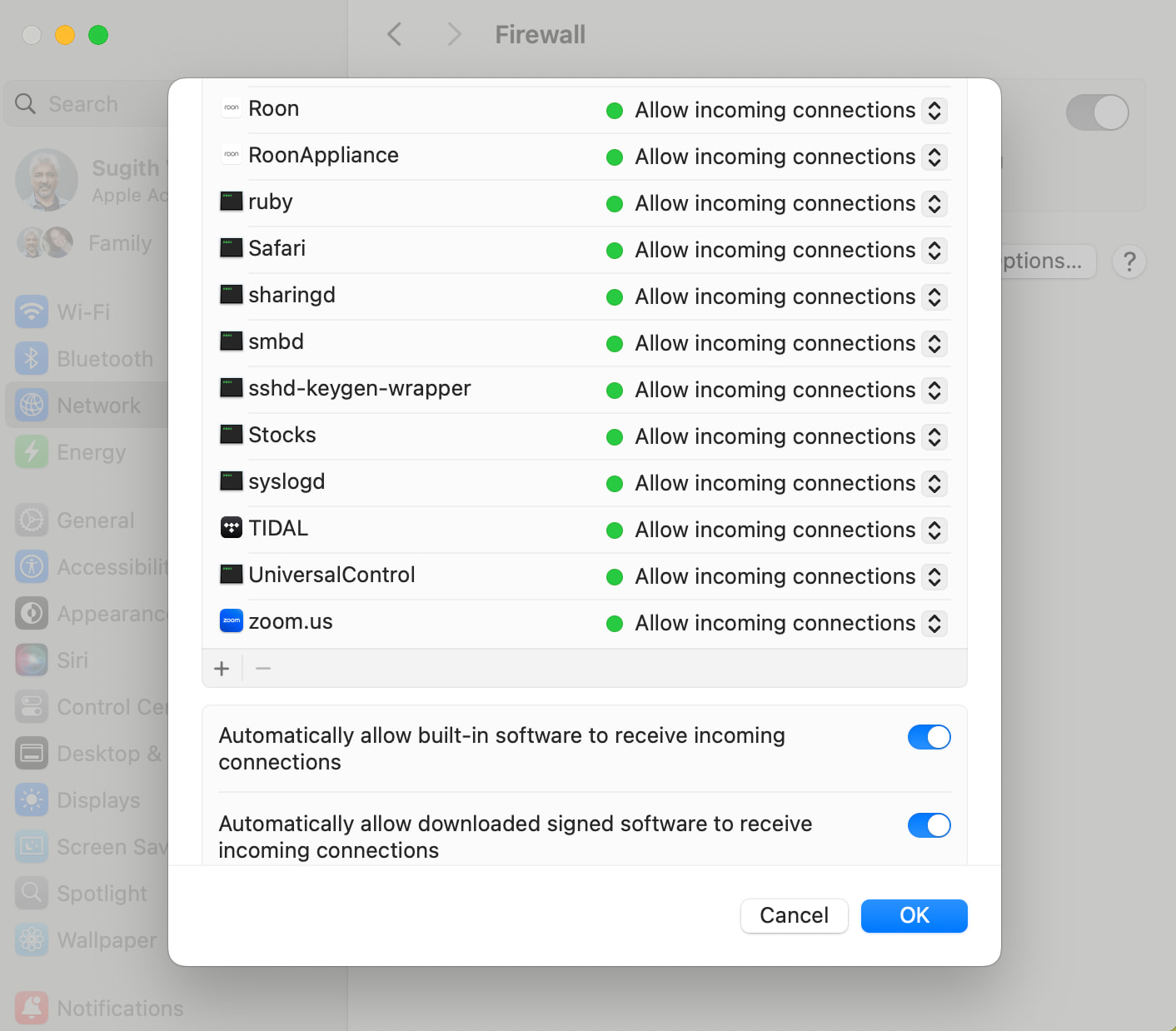

Thank you. That appears to have fixed things. (Though macOS did not prompt me to add Roon network connections. And when I checked Firewall/Options, “Roon appliance” was already added. I could add Roon, but not Roon Server.)
But ARC is now working as before.
