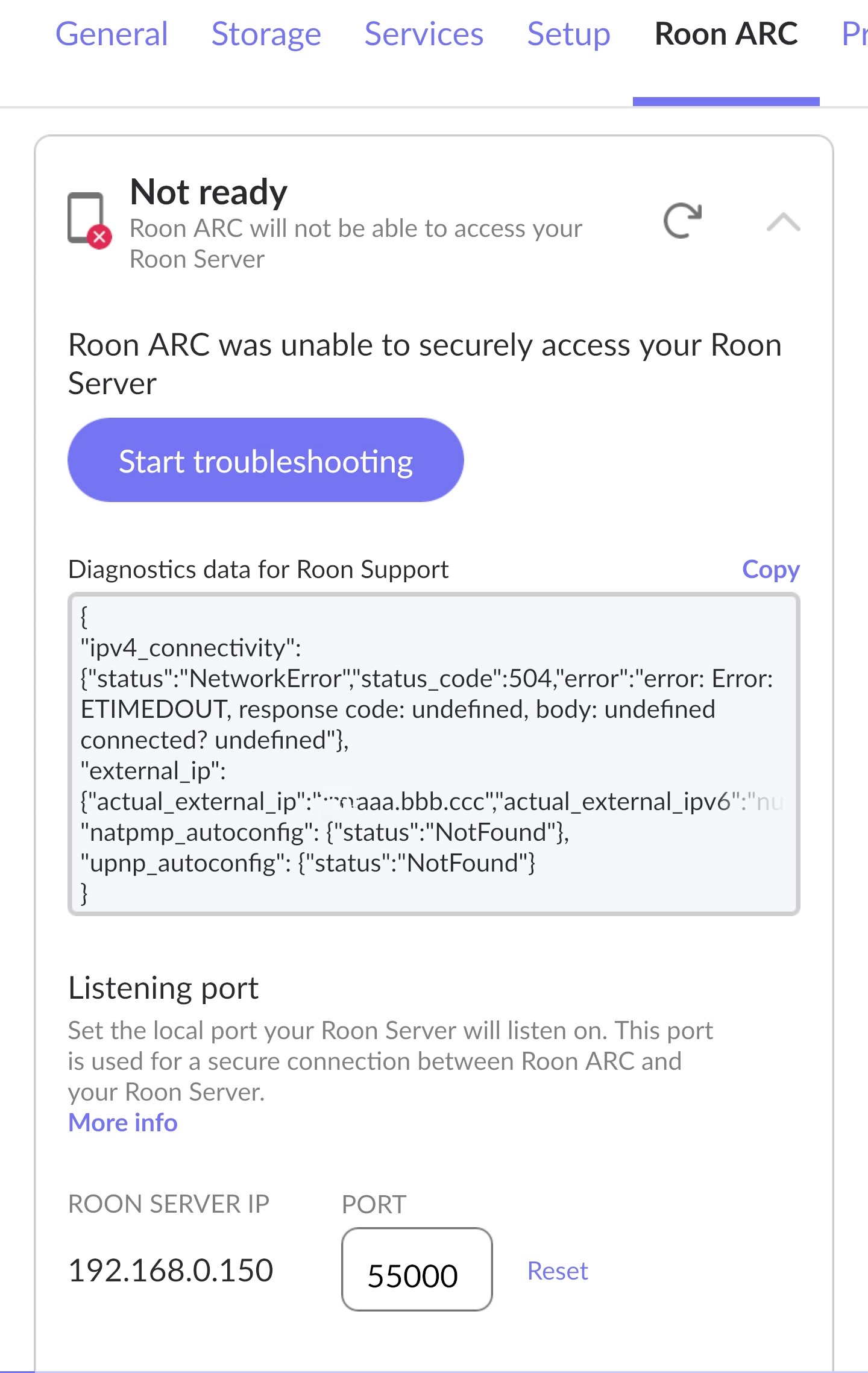

I have problem with testing connection in settings/Roon ARC. I used to port 55000. I have forward this port on my firewall: IP/TCP/55000 and I see this screen:
{ "ipv4_connectivity": {"status":"NetworkError","status_code":504,"error":"error: Error: ETIMEDOUT, response code: undefined, body: undefined connected? undefined"},
"external_ip": {"actual_external_ip":"XX.aaa.bbb.ccc","actual_external_ipv6":"null","router_external_ip":"null"},
"natpmp_autoconfig": {"status":"NotFound"},
"upnp_autoconfig": {"status":"NotFound"}}
Before update to latest version of Roon/Roon Arc and server everythink was ok and testing connection was ok.
Right now I have ROON and ROON ARC - 2.49 (1525).

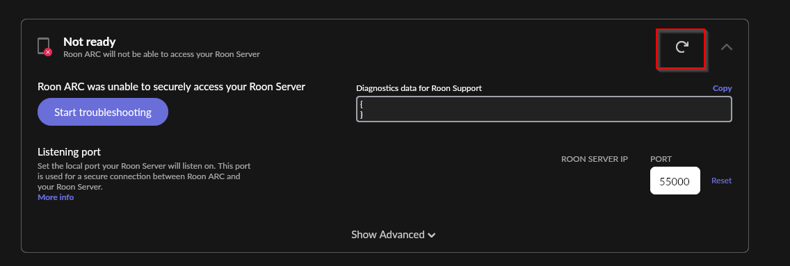

Thanks for your message. I just want to make sure I fully understand—are you saying that ARC is working as expected, and the only issue is the error message you’re seeing in the settings? If so, it may simply be a UI issue rather than a sign of something not working correctly.
There’s a Reload button on the ARC settings page—could you try clicking that to see if the error message clears? If it doesn’t, we’ll definitely take a closer look. But if ARC is still able to connect and function normally, it’s likely just a visual glitch rather than a connectivity issue.
Let us know what you find!

No, we misunderstood each other. I have updated Roon, Roon ARC and Server to the latest version i.e. 2.49 (build 1525). I wrote about this in first post. In the Roon/Roon Arc tab, the only thing that fails is the port forwarding test, which is not true, because the port forwarding works 100% well. You need to check the redirection test mechanism to see why it reports an error. Maybe it’s related to IPv6 which is not there, I use IPv4?

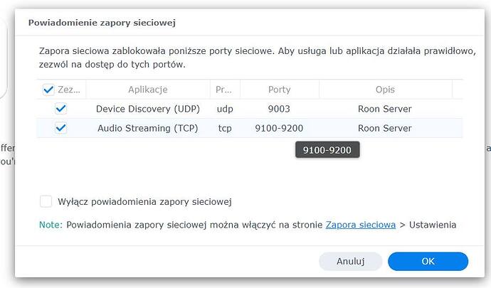

Additionally, please let me know whether the ports in the attached screenshot should be forwarded within the ROON server. Synology Server reports that it will forward these ports after the Synology Server restarts.
Hi @Bruno_Winyle ,
Thanks for letting us know you were able to find the cause of the issue! The Roon ports and IPs can change, they are not static. If you wish, you can look over your Roon logs by using these instructions, and by searching for [mobile] [remoteconnectivity] for the port test lines. Hope this helps!
