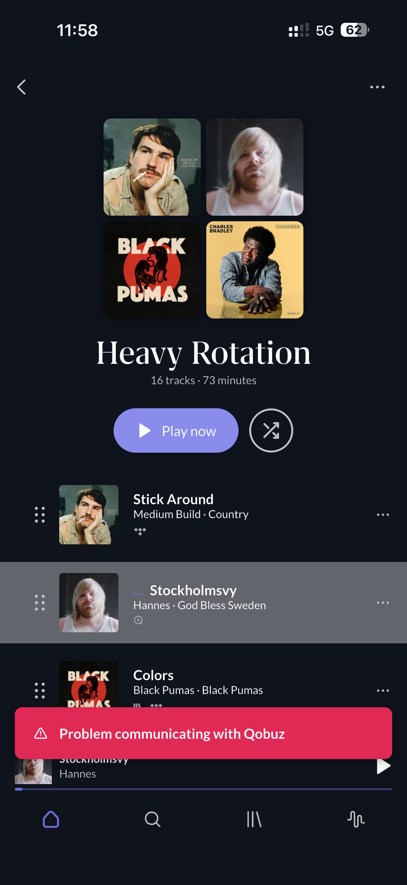

I uninstalled and reinstalled the app. Same problem. Qobuz tracks will not play on cellular network. On WiFi network I use the Roon app and everything works perfectly. Photo from one hour ago
Hey @Jeffrey_Hastie,
Thanks for the follow-up, and for the screenshot.
From a Roon Server diagnostic report, one detail worth mentioning: it isn’t failing every single time. A few Qobuz tracks did play through completely in ARC, including “Stockholmsvy,” the same track showing the error in your screenshot, which played start to finish at 9:29am on Wednesday. So it’s intermittent rather than a hard block, which fits with something in the cellular path being the sticking point.

Thank you so much for your response. Here are the results.
  1. ARC on WiFi works fine. Everything plays including what is in my library.
  2. I lowered the streaming quality to CD Quality, Balanced, and Bandwidth Optimized and none of them worked. As you mentioned, Stockholmvy did play but nothing else after that. There are times when it will play one song from Qobuz but that is it. When it gets to the next Qobuz song in the list it doesn’t play. In addition, once it doesn’t play a Qobuz song, it will not play the Tidal songs or any other songs in the playlist.

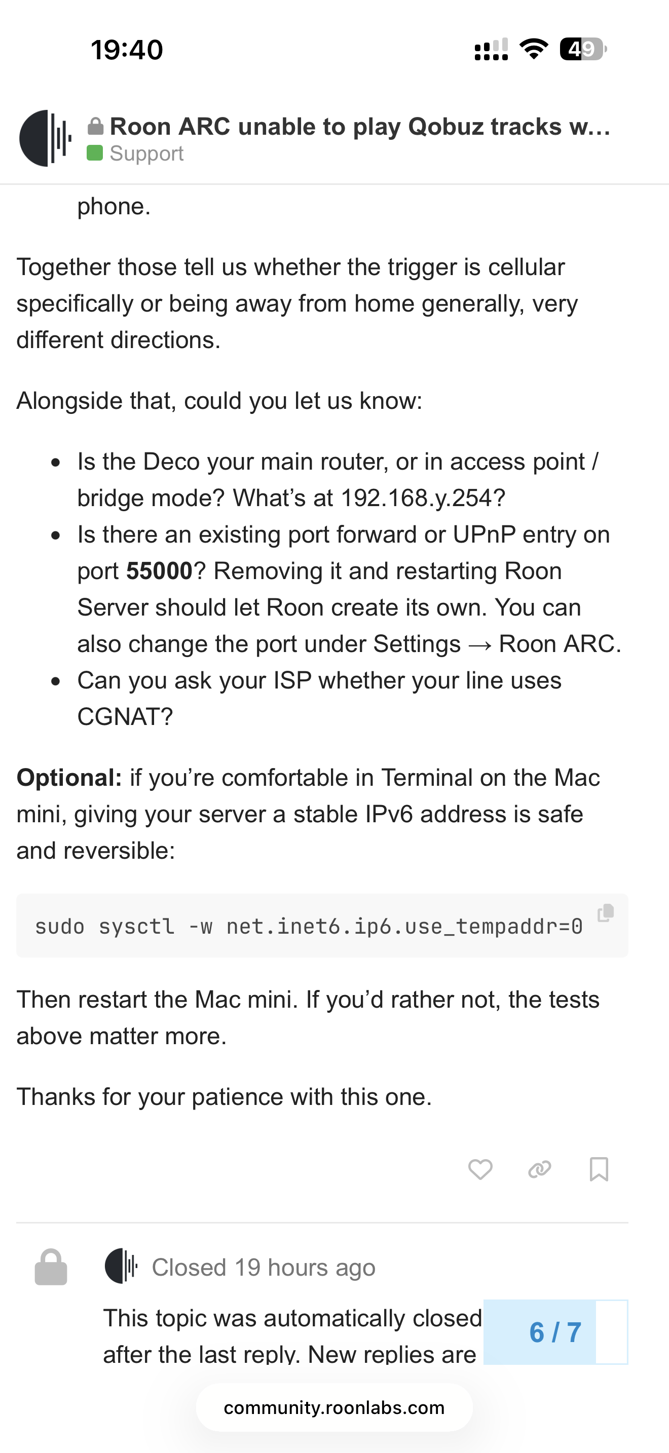

The most useful test, two minutes:
  1. On cellular only, standing at home, try one of the failing Qobuz tracks.
  2. Then try the same tracks on a different WiFi network, a friend’s, or a hotspot from another phone.
Together those tell us whether the trigger is cellular specifically or being away from home generally, very different directions.
Alongside that, could you let us know:
  • Is the Deco your main router, or in access point / bridge mode? What’s at 192.168.y.254?
  • Is there an existing port forward or UPnP entry on port 55000? Removing it and restarting Roon Server should let Roon create its own. You can also change the port under Settings → Roon ARC.
  • Can you ask your ISP whether your line uses CGNAT?
Optional: if you’re comfortable in Terminal on the Mac mini, giving your server a stable IPv6 address is safe and reversible:
sudo sysctl -w net.inet6.ip6.use_tempaddr=0
Then restart the Mac mini. If you’d rather not, the tests above matter more.

· Other ARC issues
· Qobuz songs will not play on Arc. I’ve reported this before and the issue was closed before resolution. I’m attaching screenshots of the previous post. The last suggestion was to try through a hotspot and another WiFi. Both worked fine but when I go back to Arc through cellular data either one Qobuz song plays then nothing plays or the first Qobuz song doesn’t play and the whole thing crashes.
· See attachment
Second attachment
The original thread was closed because you didn’t respond for 1 week. If this happens, please flag the last post, select Something else, and ask the moderators to reopen the topic. Thank you.
