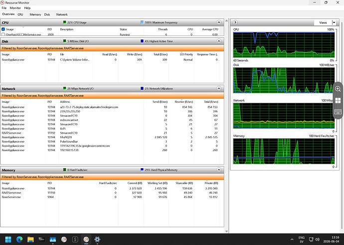

Looking at Performance Monitor in Windows (my server choice), this snapshot is from a couple of minutes into the song playing. (Birds- Dominique Fils Aime, 5th Element 24B-88.2K)
Note the Receive column, at around 800Kbps… This has previously been done within 10Seconds of a song chnage/initialization.
My Internet speed is not significant, but 100Mbps should be fine to stream this kind of material, at least 20 times in in parallell!
Any reflections on the subject from other observant users?

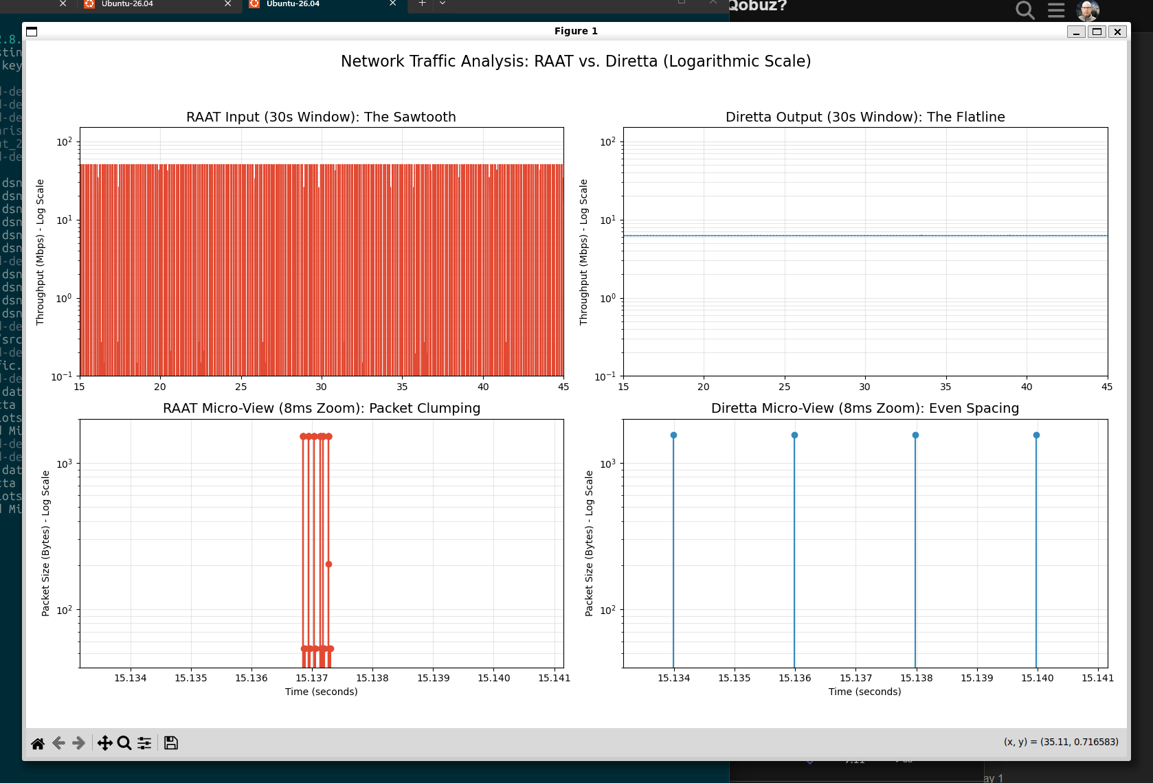

Edit: I’m still seeing rather bursty audio delivery from Roon Server to Roon Bridge.
For this reason, I’m successfully using the Diretta protocol downstream of Roon Bridge to smooth out network audio delivery before it reaches the transport that feeds the DAC.
No, the server->endpoint behaviour is not new, it has always been like that.
The RAAT protocol is working with a low buffer, but it is “bursty” as @David_Snyder also points out.
