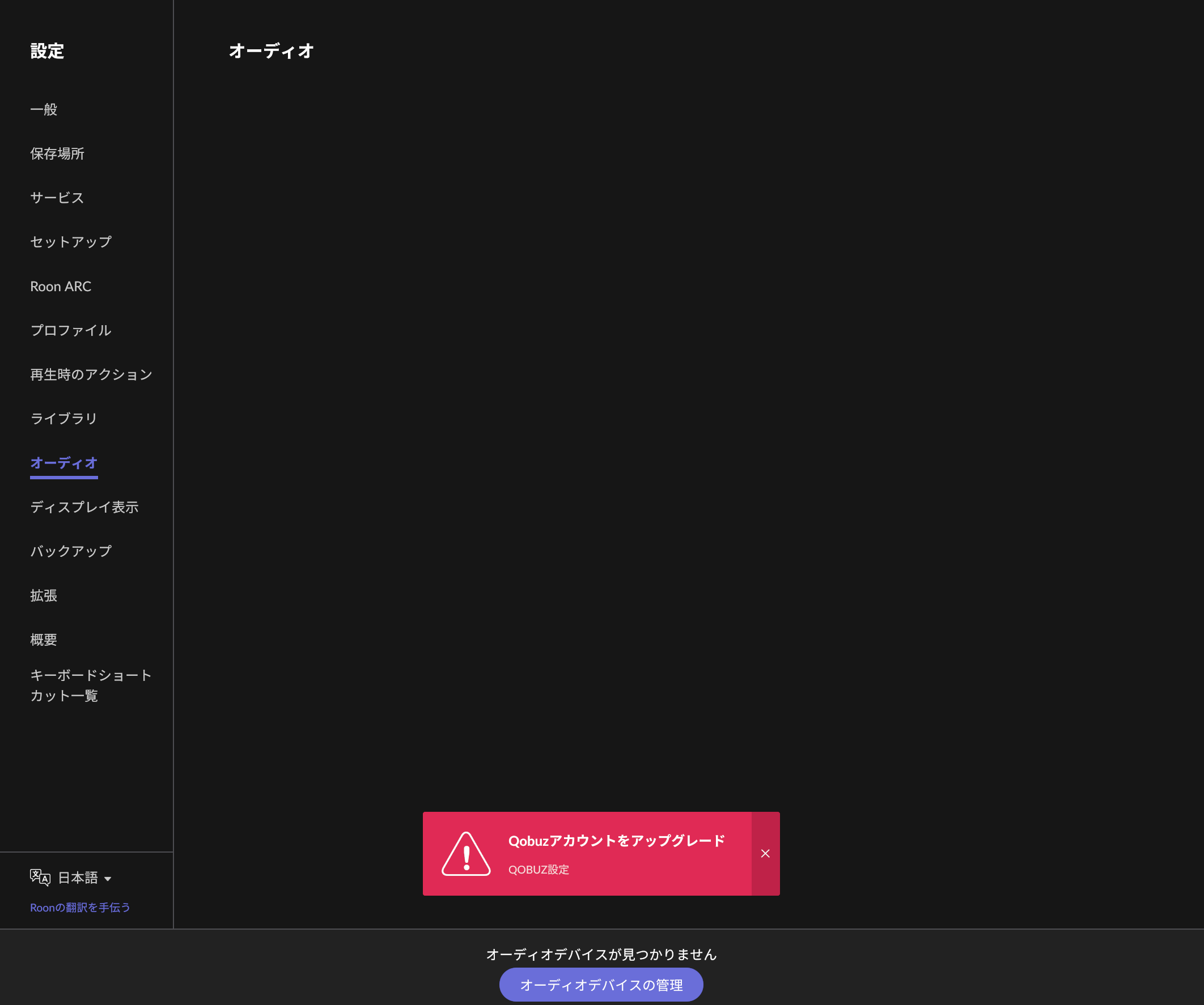

RoonのAudioに表示されるdeviceのアイコンが全て点滅して表示される様になって、deviceに接続ができない状態になりました。改善の仕方についてご回答ください。---Realtekのアイコンを押した際にそのような状態になりました。現在、デスクトップPCで動画を視聴すると、とぎれとぎれに中断します。
router, switch, DA converter, streamer, PC

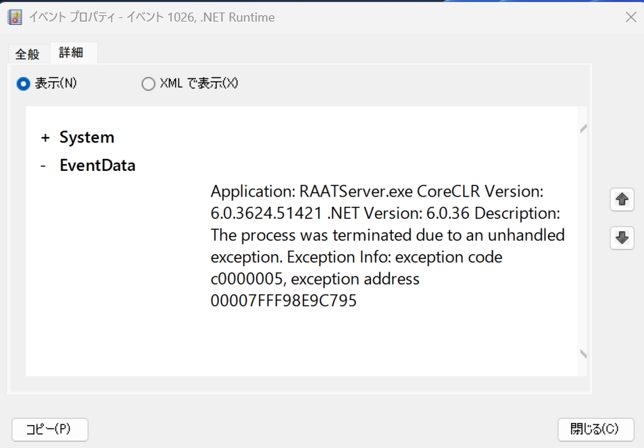

先程、そちらから求められたイベントビューアでのRAATserverに関する通知の表示画像ですが電子メールではそちらへ返信が出来なくされてスクリーンショットが送る事が出来ません。以下に文言を転記します。“Application: RAAtserve.exe CoreCRL Version: 6.0.3624.51421 .NET Version:6.0.36 Descr.exe CoreCRL Version: 6.0.3624.51421 .NET Version:6.0.36 Description: The process was terminated due to an unhandled exception coe c0000005, exception address 00007FFF98E9C795“
router, modem, Switch: Silent engel N8, DAC IfI: Zen DAC, streamer: IfI Zen stream
Hello @zvl02623,
Thank you very much for providing the Event Viewer details — they’re extremely helpful. The entry you’ve shared indicates that RAATServer.exe is crashing due to an unhandled exception in the .NET runtime.
This usually happens when the .NET 6 runtime installation on Windows becomes corrupted or when Windows security software interferes with Roon’s background services. Let’s try the following steps to repair this:
  1. Repair or reinstall the .NET 6 Desktop Runtime
  • Download the latest version of the .NET 6.0 Desktop Runtime (x64) directly from Microsoft:
    :backhand_index_pointing_right: Download .NET 6.0 (Linux, macOS, and Windows) | .NET
  • Run the installer and select Repair (or Install if not already present).
  • After completing this step, restart your computer.
  1. Ensure Roon and RAATServer are allowed through the firewall
  • Open Windows Security → Firewall & network protection → Allow an app through firewall.
  • Make sure both Roon.exe and RAATServer.exe are checked for Private and Public networks.
  1. Temporarily disable antivirus or endpoint protection software, then start Roon again and observe if the devices appear without flashing.
  2. If the issue persists, please let us know:
  • Whether you see any new Event Viewer entries mentioning RAATServer.exe after reinstalling .NET.
  • If your Realtek audio device still causes the flashing icons when selected.
Once we have this information, we can determine whether this is purely a Windows runtime issue or something related to the Realtek driver stack.

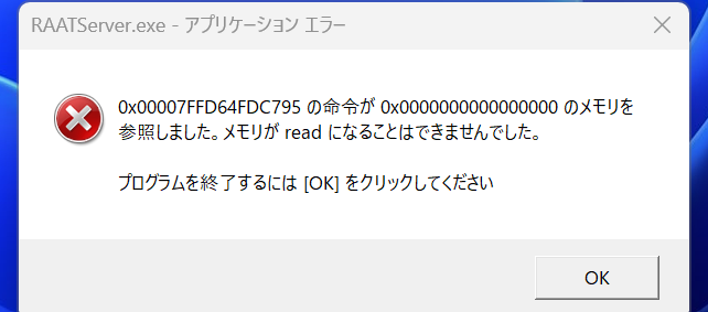

vadim sann. 手順通り試みましたが、アイコンは相変わらず点滅をしていて、接続ができません。 画像は、数分から10分おきにデスクトップ上に表示されるものです。
DAC, (IFI ZEN Sigenature v2,) PC,Streamer
Post merged, so all the history is together.
Please reply here in this topic to provide more information.
Hello @zvl02623
Thank you for the screenshot — this error indicates that RAATServer encountered a memory access issue and could not continue.
To resolve this, please follow these steps:
  1. Fully close Roon
  • Right-click Roon icon in the taskbar → Quit Roon
  • Open Task Manager → make sure RAATServer.exe and RoonAppliance.exe are not running. End them if they are.
  1. Delete the RAATServer cache
  • Press Win + R and enter:
%localappdata%\Roon
  1. Delete the folder:
Cache
Temp
  1. Rename the folder Database to Database_old
  2. Restart the computer
  3. Make sure audio drivers are up-to-date
  • If using a USB DAC → reinstall the DAC driver from the manufacturer’s website.
  • Unplug it from the PC and check if the RAAT is launching well wi the system output.
  1. Try launching Roon again and let us know if the error still appears.
