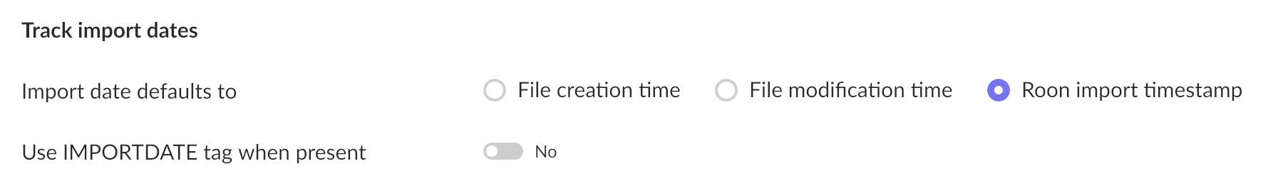

What are your settings under Settings > Library > Import Settings > Track import dates?
Are they:

Thanks for this @DDPS this resolved my issue. I have set the import date to the date created and this has reordered all my albums to the order I have added them to the library.
