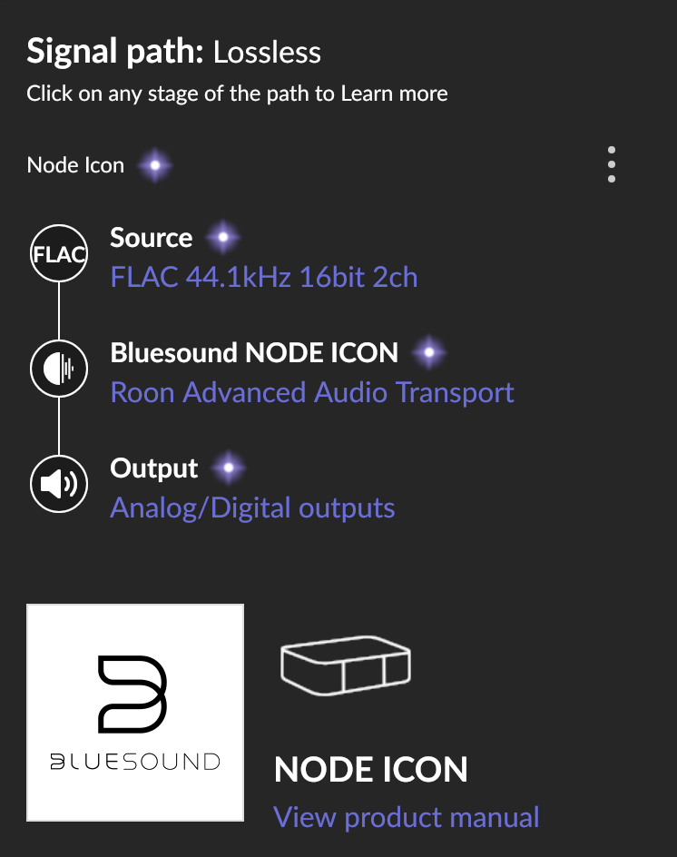

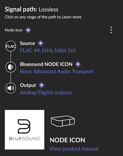

Roon displays the Signal Path, which shows exactly what happens up to handoff with the device (the Roon icon) and for some Roon Ready devices, what it signals internally, e.g. if DSP is applied.
Please share a screenshot of the Signal Path.

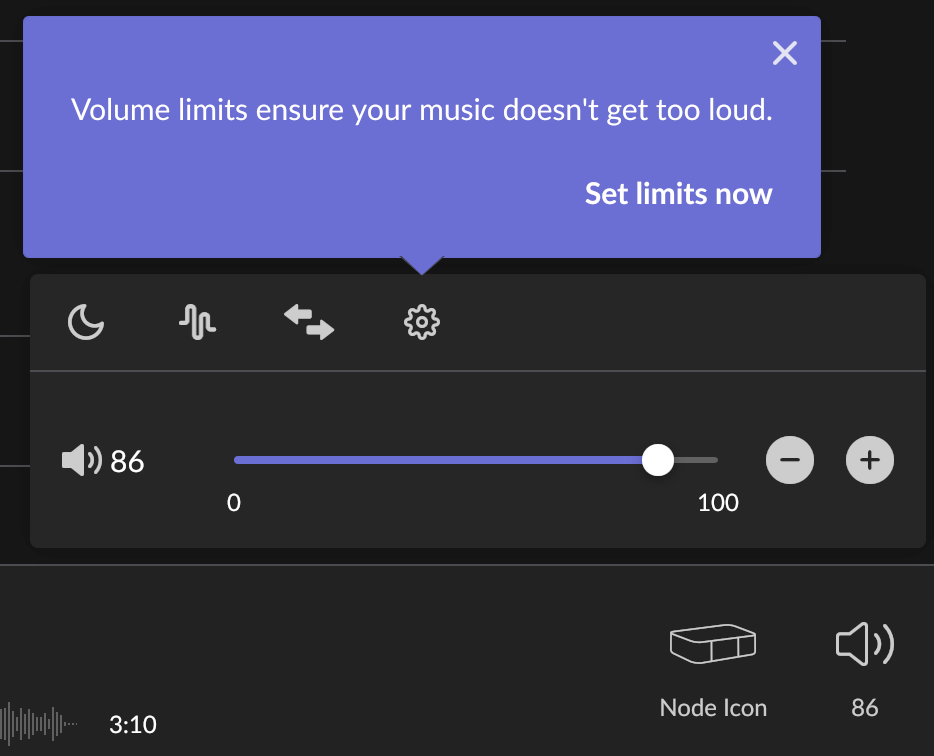

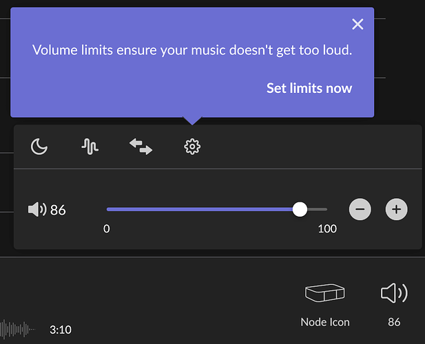

Screenshots of Signal Path and Volume Control
The Node Icon doesn’t have analog volume control a.f.a.i.k, it is changed digitally… which means the signal path should be “enhanced” instead of “lossless”, since it can never be bit perfect with adaptable digital volume control.
In fact from what I’ve read it should always be “enhanced”, because it shouldn’t be possible to disable “QRono d2a” on the Node Icon and use “bit perfect” (unless the digital output is used to an external DAC). But here it looks like I can disable it anyway, even without an external DAC?
I’m doing this weird (buggy!) procedure to do three things which shouldn’t be possible: disable QRono d2a, enable the lossless signal path, with adaptive volume enabled:

This is incorrect. You are using neither DSP volume nor fixed volume, so Roon is using device controls for volume. This varies from device to device, but Roon will report correctly in the signal path as this is considered as part of the Roon Ready certification.
For example, my Roon Ready DACs with device control use an analogue volume control that Roon can adjust. This includes a Bluesound Pulse Flex, Tanchjim SPACE, and DragonFly 1.2.
That answers the question how ROON controls the volume of the Node Icon. However, internally the Node Icon uses digital adjustment of volume via DSP. So, if you disable “fixed audio signal” in the BluOS app, the signal path can’t be “lossless” anymore. But I guess ROON is never aware of how this is processed internally, it simply triggers ‘volume up / down’ signals. So it shows “lossless” anyway.
Being able to disable QRono d2a still baffles me… but I guess that might be a similar issue of the Node Icon not reporting back to ROON what’s actually going on.
