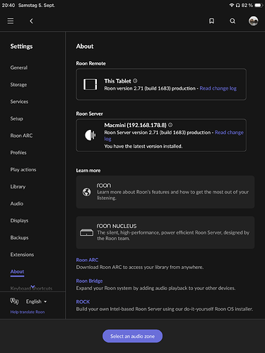

Same here. Roon bridge does not appear.
Roon version is the same as yours.
Reboot didn’t help. :thinking:

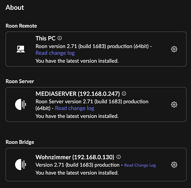

I have to admit that the updated Roon Bridges are currently behaving somewhat inconsistently when displayed in Roon.
Here an example from my setup:
In the Roon Settings/About I see my PC, my Roon Core and one Bridge (Wohnzimmer @.130)

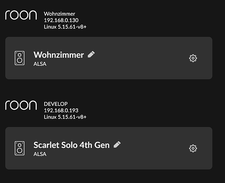

Going to Roon Settings/Audio I see two Roon Bridges, the one @.130 and the other one @193.
And most importantly: Both run on rooExtend and BOTH WORK!
I assume this is a display issue in Roon (a minor problem), since I can play music without any issues via both Roon Bridges.

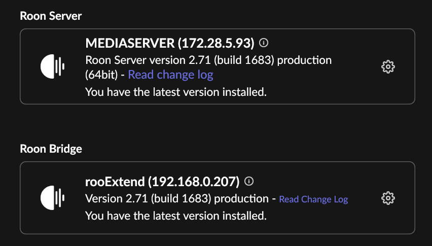

@DrCWO i think there is a rooExtend related issue.
Since the roon bridge update (which I initiated via the roon app) my rooExtend no longer appears as an endpoint in Roon.
The rooExtend extensions are all working fine.
My suspicion is roon bridge isn’t running (although I can see it’s being started in the log).
This isn’t a problem for me ( I don’t use this as an endpoint), but happy to help with logs etc.

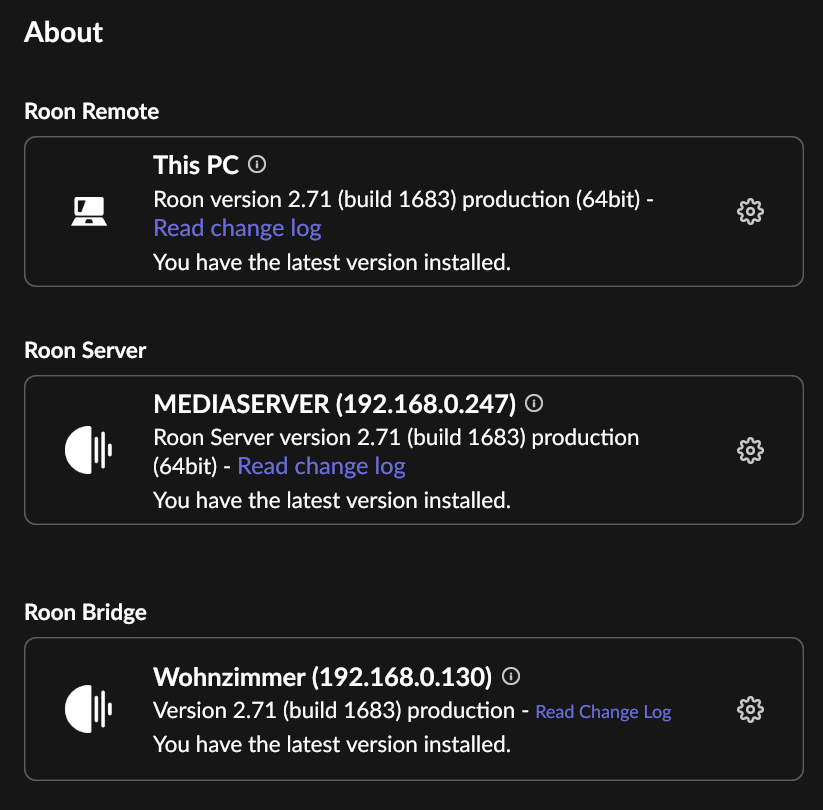

In my setup (Roon Core on Win11) I miss one of my bridges in the Settings/About section but non in the Settings/Audio and both are working. The versions of the installed software also meet Roon’s requirements.
