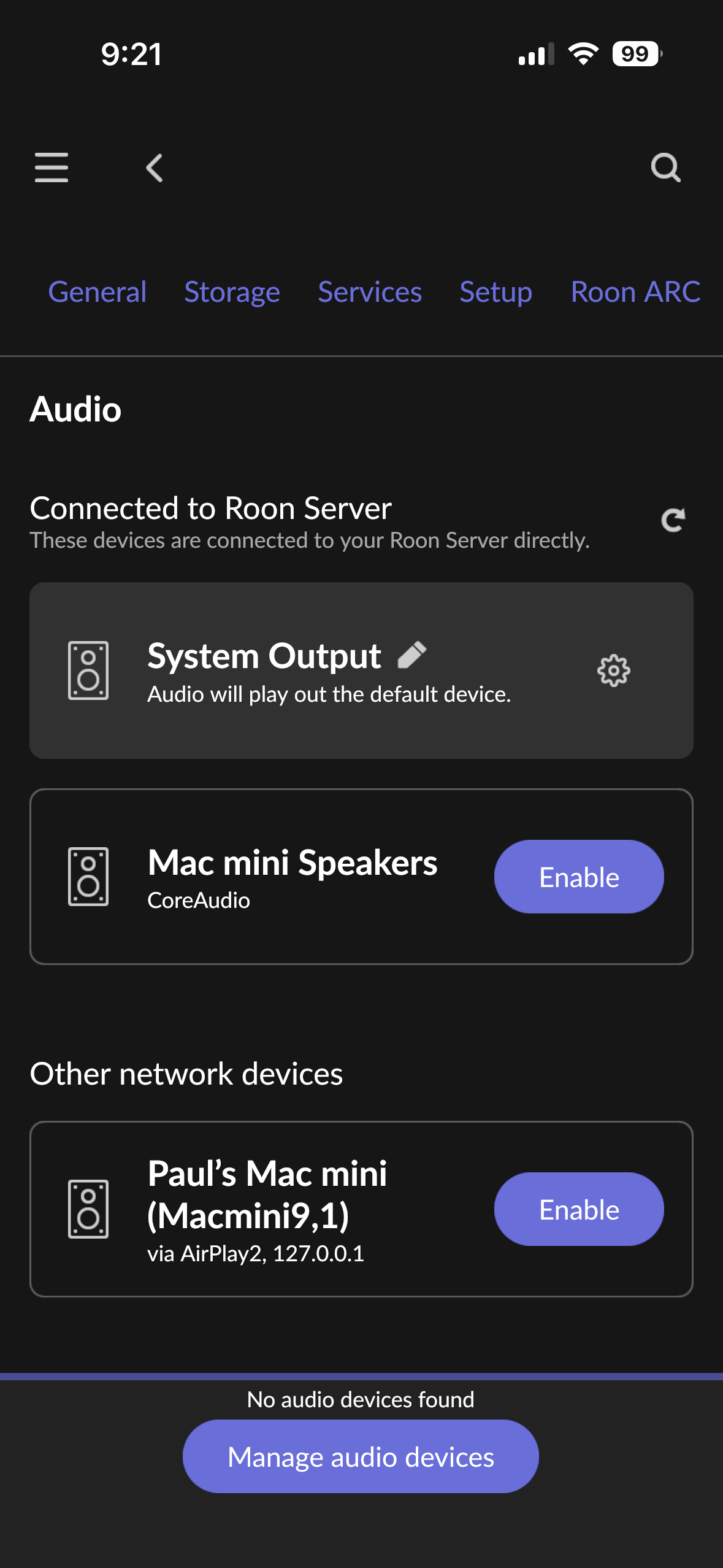

· the last couple of updates as always stopped Roon from finding my speakers/amp all these are run ready products which have worked for the last couple of years fine until these last few updates I used to be able to just restart Roon after the update and this usually fix my problem but now I cannot use room at all. It will not find any of my speakers. I have done the obvious of restarting the router and restarting all of my hardware nothing works. Roon is now useless. It does not work.
No audio devices found

macOS Sequoia (version 15), has tighter (and more obfuscated) network security settings than preceding MacOS versions.
Can you please navigate to macOS System Settings > Privacy & Security > Local Network, and make sure Roon is allowed.
If it is already enabled, toggle it off and on again. Then reboot your Mac, and see if the same issue persists.

Thanks Carl — that resolved the issue and everything is working again as it should.
