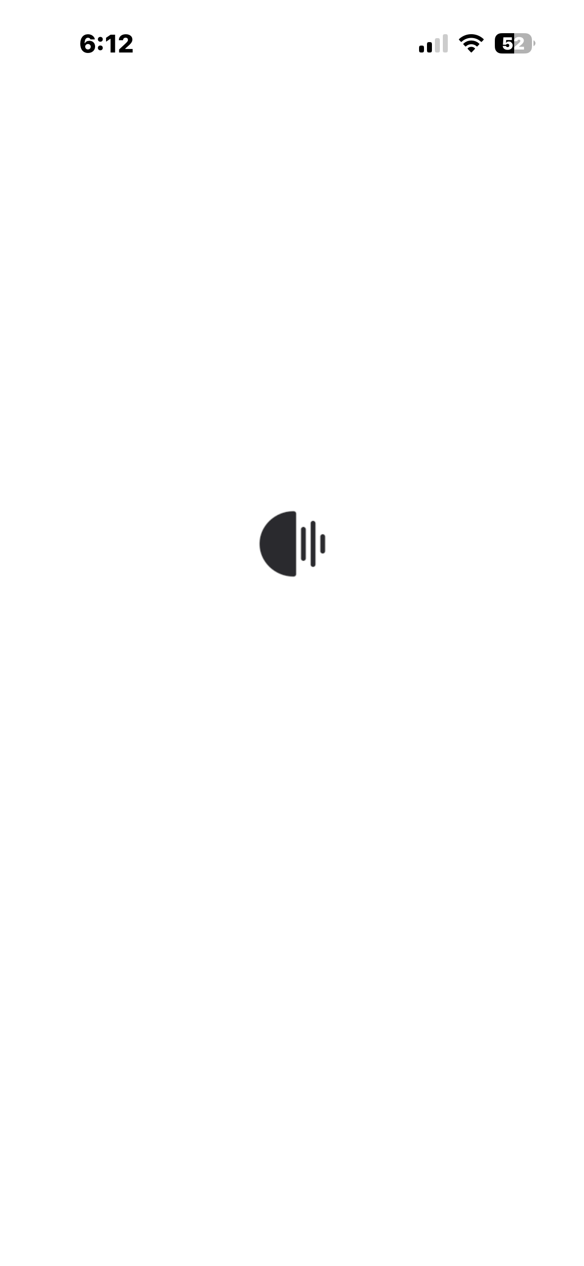

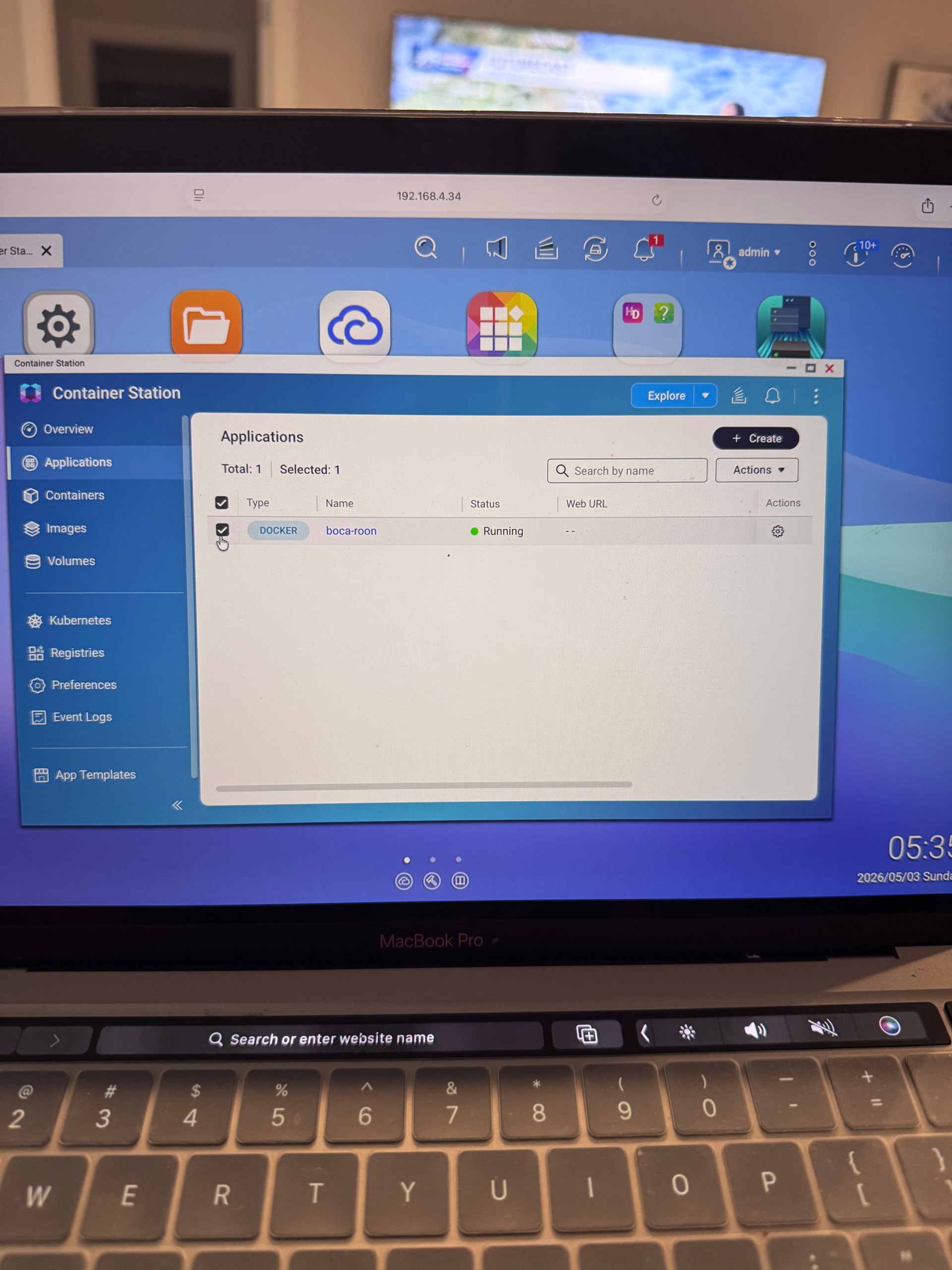

I created everything in docker. I can see that my nas is connected and I can view files but when I open roon on my devices it does connect and just shows the roon icon
This is what I see on qnap for roon

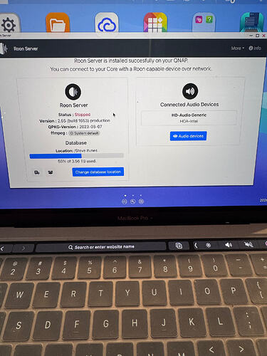

From your screenshot, it looks like your remotes are still attempting to connect to the (now offline) original, non-containerized Roon Server. You essentially have two installs: the QPKG is stopped, while the Docker container is running separately.
Since you want to use the Docker, you’ll want to first stop and disable the QPKG version by going to App Center → Roon Server and selecting Disable or Uninstall.

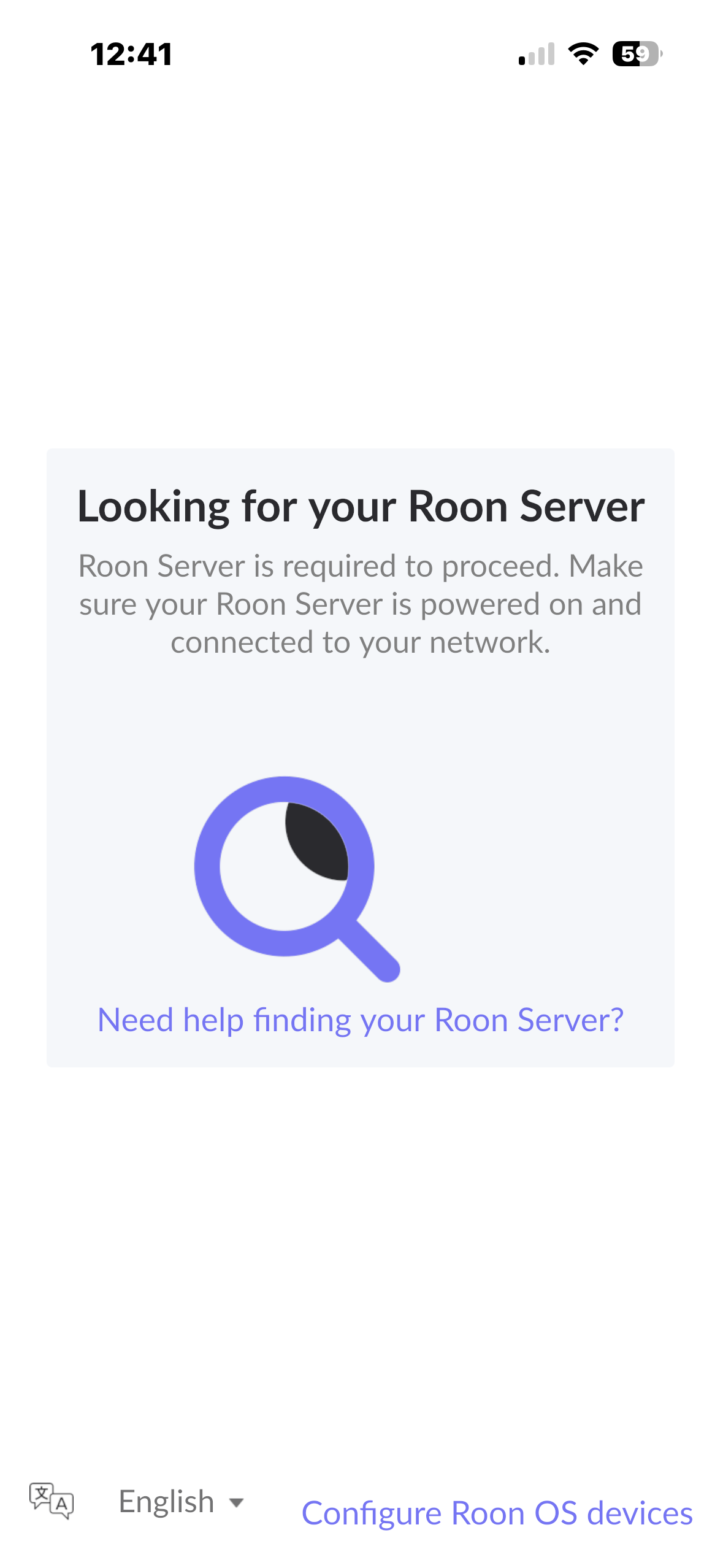

I still can not get this to work. Even after disabling the old version of Roon It seems that I can’t get the docker app to find my music. Very frustrating

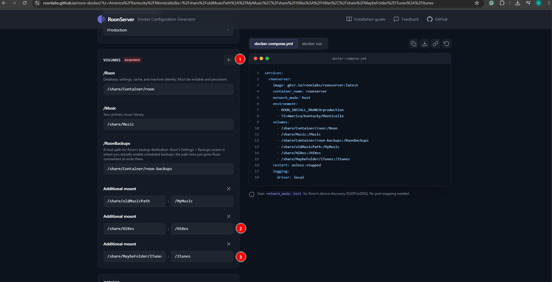

  • The YAML/Docker Compose text you used to create the container.
  • A screenshot of your Shared Folder mappings in Container Station.
  • The actual path in File Station where your music files are stored (e.g., /Multimedia/Music).
Once we have those, we can give you the exact “map” to restore your library perfectly. How did the file copy go?

  1. Multiple Mounts: When you generate your Docker configuration, you aren’t limited to just one music folder. You will assign your first folder to the default /Music path, and then you can use the “Additional mount” option to add as many extra folders as you need (for example, mapping your hi-res folder to /HiRes inside the container).
  1. The “Edit” Rule: When you fire up the new container in September and restore your rescued database, you will go to Settings > Storage. You will see both your old iTunes and Hi-Res paths marked in red.
  2. You will simply click the three dots > Edit for the old iTunes path and point it to the new /Music container folder, and then do the exact same thing for the old Hi-Res path, pointing it to /HiRes.
