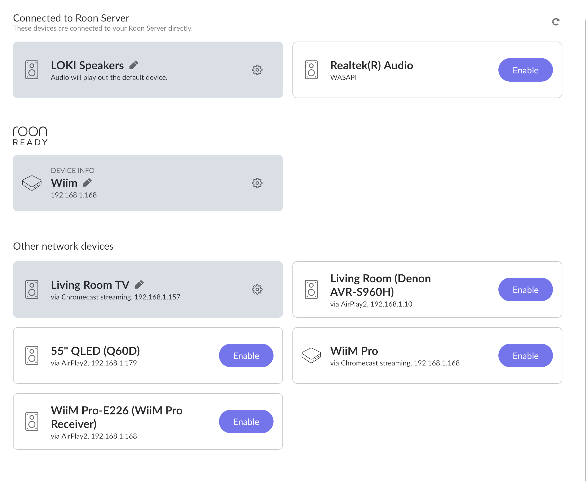

Roon can't detect Mac laptop speakers (ref#U9P6YW)
· Roon can't see my Mac laptop's speakers anymore
· Verizion FIOS wifi router, the mac laptop is hooked up via ethernet and wifi, the roon server is on wifi
The LOKI speakers are the computer that is running the server software.

Is the screenshot you’ve shared from MacOS or from your PC?
MacOS System Output is a locally-controlled zone. It won’t be visible on your Windows machine; it will only show up in Roon Settings → Audio when you run the Roon app on the Mac itself.

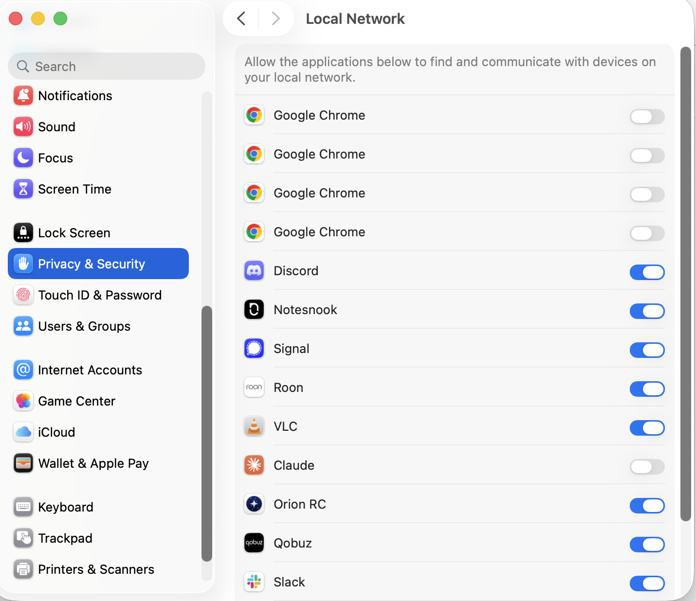

If you’re still not seeing it there, ensure that you’ve toggled local network access on for Roon in your MacOS Privacy & Security → Local network list.
We’ll watch for your reply. Thank you!
The screenshot is from the Mac laptop. It already has Local network access turned on.
Try toggling them off and on again
