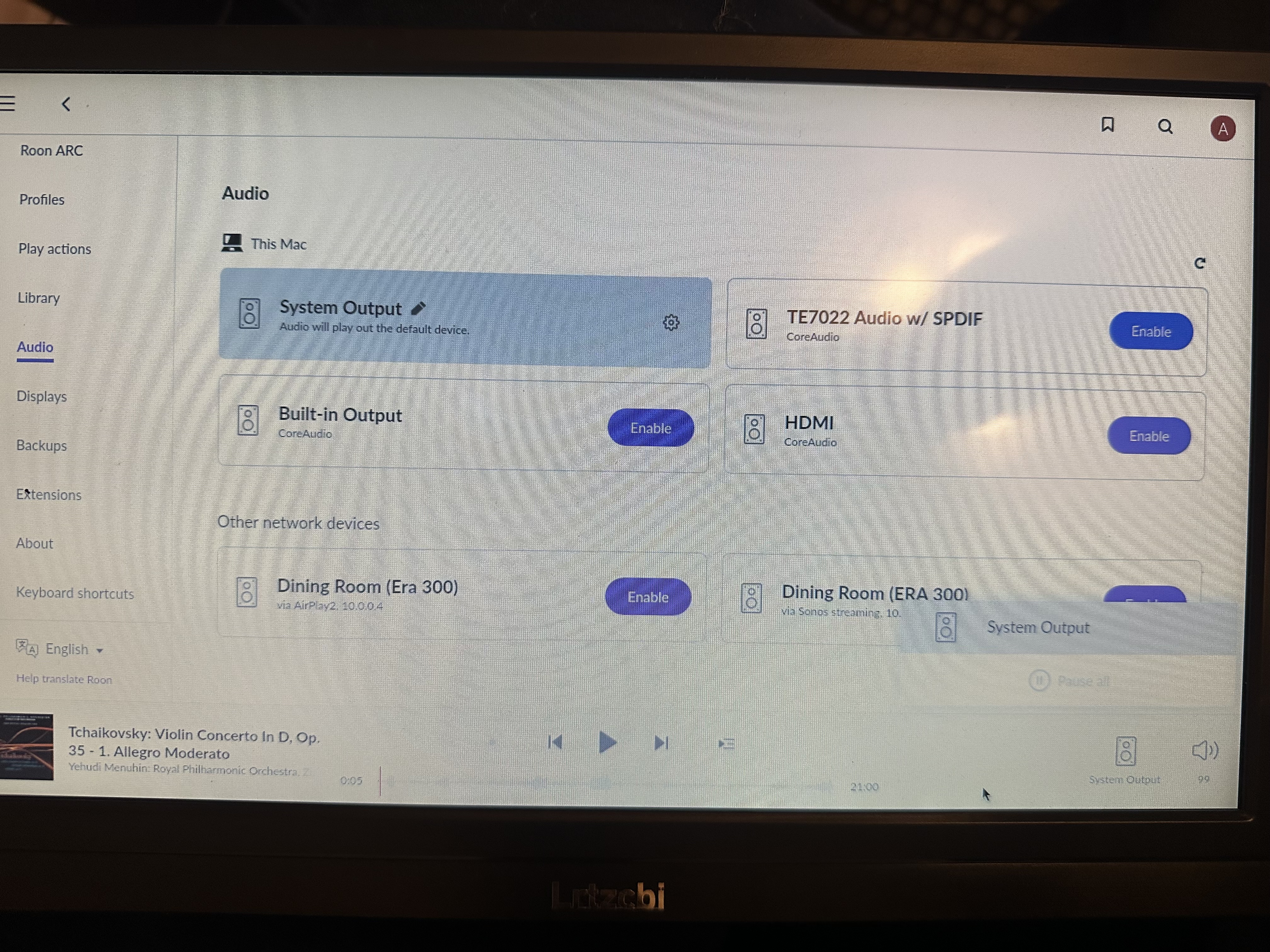

Two issues (probably related). (1) Roon can’t see my Hegel H190 as an endpoint anymore. When I open the Roon App on my Mac Mini, it just says “System Output”. It used to give me two options for the H190 (one of which was USB and the other the Roon Ready option).

It shows up as a TE7022 USB device in MacOS.
This is from a previous support ticket.
I would try enabling the TE70222 Audio device, choose it as the target and try playing something to it and see.
Sadly no joy. It seemed to change in the last week. It had been fine for a year!
