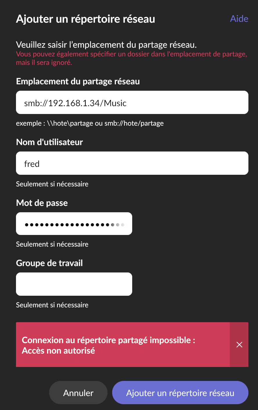

After reboot and launching roon server, I have the same error when I try to add my music on the NAS to the roon server. Here a picture of what I get as result.
well, I’ve tried again and it works, but…
but I was forced to “mount” on my mac desktop the Music volume of the NAS (by “command-K” in the finder of the mac).
Roon is actually scanning my Nas library.
I am curious to see what happen if I “unmount” my NAS from my computer.
thanks for you help :slight_smile:
Hey @frederic,
Thanks for the update, and glad to hear it’s scanning now.
To answer your question directly: yes, if you unmount the NAS volume from Finder, Roon will most likely lose access to it again.
So for now, I’d recommend treating the Finder mount as a required step rather than a one-time workaround: keep that volume mounted, and consider setting it to reconnect automatically at login (System Settings → General → Login Items → Add the NAS share as a login item, or add it to “Open at Login”). That way Roon Server will always have the volume available on startup without you needing to manually reconnect it each time.
A couple of smaller things I noticed that may be useful if you ever want to try Roon’s native connection again: a few of your address formats (e.g. entering smb://sangar or the Synology QuickConnect address directly) aren’t in a format Roon’s network share field accepts, it needs the share entered without the smb:// prefix, along with the hostname/IP, share name, and credentials in their own fields rather than as a single URI.
In the meantime, the Finder-mount approach should keep you up and running. Let us know if you run into anything else!
