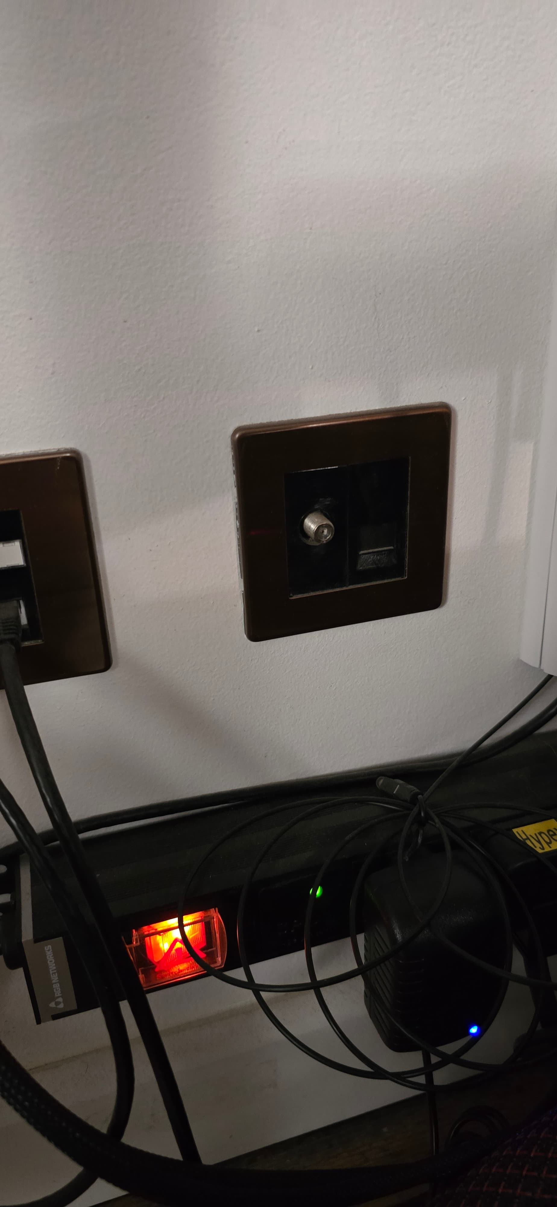

Result! I forgot about the now disused RJ11/F Type coax outlet that I put in when we had cable TV and a land line. Just need to switch out the modules for a couple of Cat6 and pull in a couple of bits of cable between here and the patch panel in the cupboard behind! :wink:

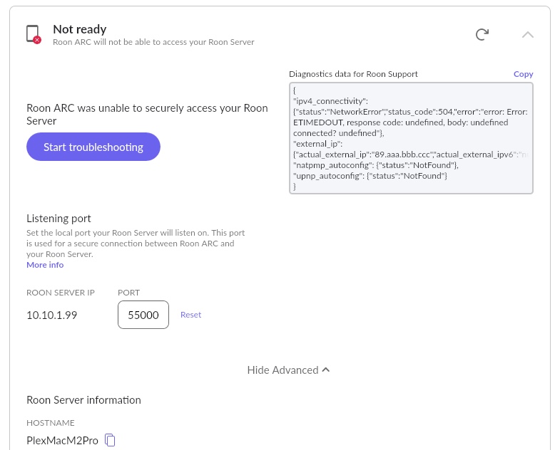

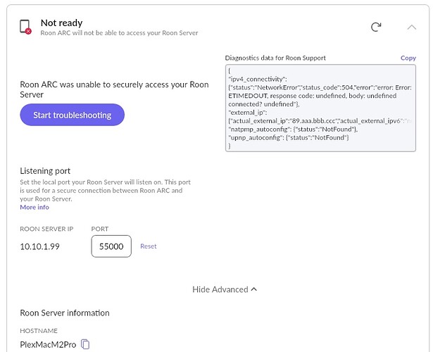

Just as an update, I have done a clean reinstallation of Roon and can now see all of my AirPlay speakers but the Arc app cannot see the Roon server despite logging and initially seeing it from a drop-down list.
This error message is showing:
“ipv4_connectivity”: {“status”:“NetworkError”,“status_code”:504,“error”:“error: Error: ETIMEDOUT, response code: undefined, body: undefined connected? undefined”},
“external_ip”: {“actual_external_ip”:“89.aaa.bbb.ccc”,“actual_external_ipv6”:“null”,“router_external_ip”:“null”},
“upnp_autoconfig”: {“status”:“NotFound”}
FYI: Sonos streaming is also back from the MiniMac though no Devialet (Roon Ready); we will get this sorted on Tuesday.
Thanks
Hi @noris
Thanks for your insights. After some troubleshooting, we found that the issue with the Devialet Roon Ready device was related to a firmware issue—an update was required to make it properly discoverable and allow it to work with the Roon Server.
Additionally, setting up NAT correctly and ensuring port forwarding was properly configured resolved the ARC connectivity issues. Assigning a static (or fixed) IP to the Mac Mini running Roon Server was also a key step in maintaining a stable connection.
In our case, we didn’t need to use Tailscale, as proper port forwarding on TCP 55000 was sufficient to enable external access to ARC.
