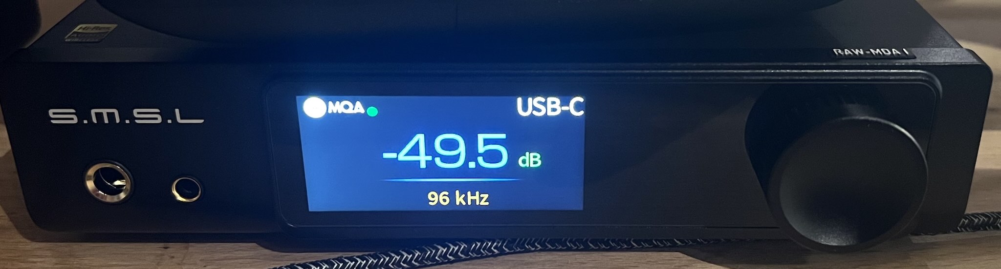

Due to the fact that I own more that 1000 tracks of mqa coded audio mqa will remain a use case I will have even if tidal stops serving it. With my other DAC Roon gets some kind of confirmation that the DAC is doing the MQA rendering. With this DAC I get the MQA decoding message in Roon but no MQA rendering confirmation. However the DAC indicates the MQA signal and is doing the rendering. See the two screenshots
