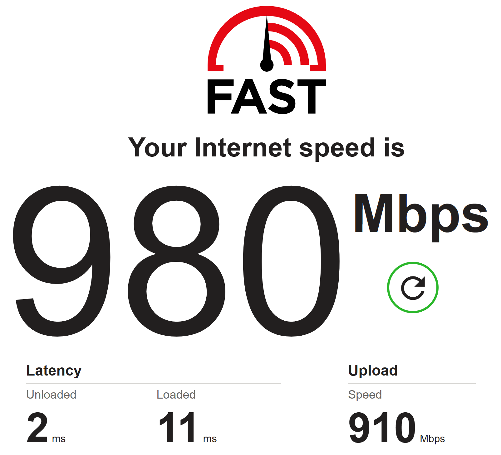

Speedtest run from the roon server machine

Thanks for the logs, they are exactly what we needed and they point away from your setup entirely.
Your log shows the requests reaching our servers and our side failing to answer in time. One came back as a 504, and others to the same host in the same minute succeeded but took over 40 seconds. Every failure was against the same service. There was nothing wrong with your network, and no need for any further changes there.
Others reported the same thing over the weekend, and from those reports it looks to have come right on the 7th. Could you please confirm whether things are back to normal for you as well?
Things appear to be loading normally.
