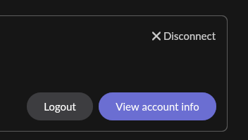

Another easy way to ensure you’re connected to your QNAP would be to navigate to your Roon Settings>General> X Disconnect
Screenshot 2025-04-01 at 10.46.55
This will allow you to select a different Roon Server, so if you’re accidentally on your Windows, you can select your QNAP.
Once you’ve selected your QNAP, you can quit Roon Server running on your Windows machine via your Windows task bar.
