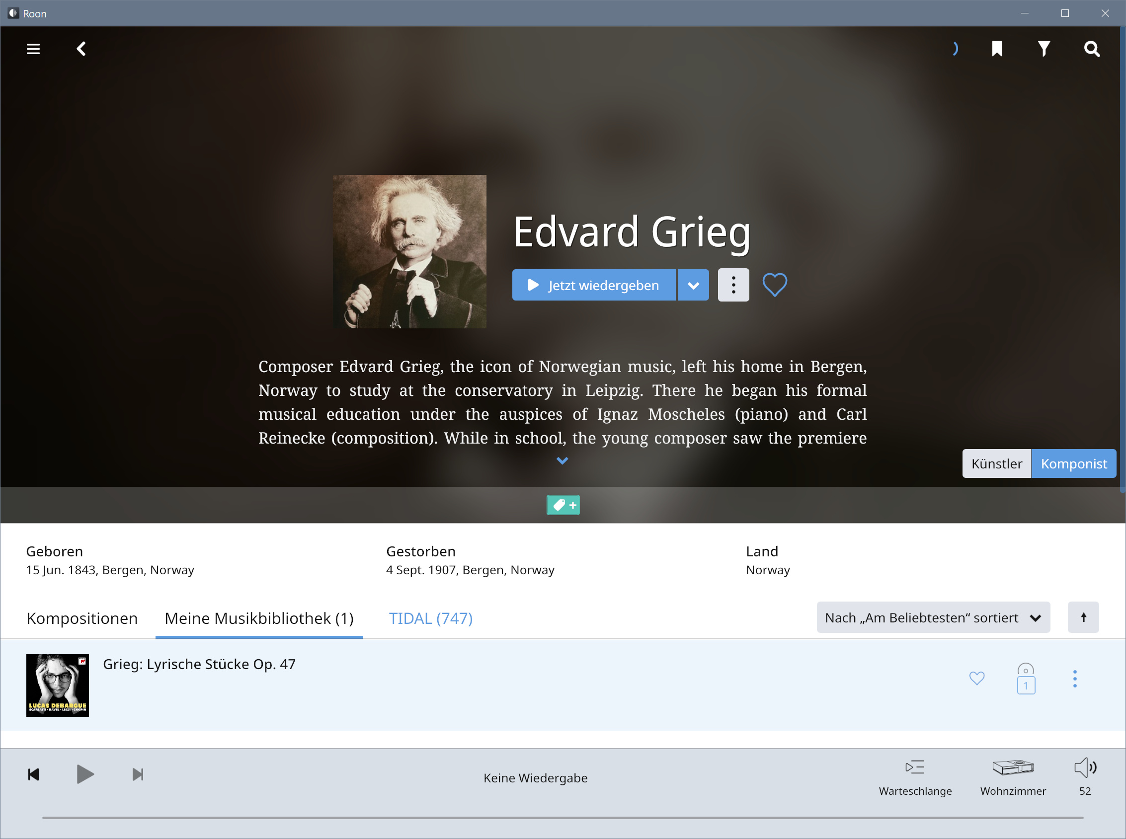

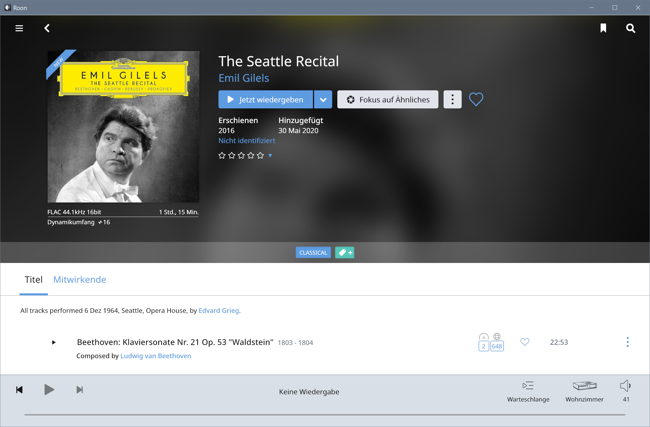

NOW, all of a sudden Roon believes that the album by Emil Gilels (a live recital from 1964) is performed by Edvard Grieg, the composer (who died in 1907).
What is happening here, and how do I get rid of this error?
This glitch may be the result of the metadata provider coding Grieg as an Artist, not as a Composer. This is easily fixed by Editing Album/edit Album Artist and/or Primary Artist Links.
This is an unidentified album (Nicht identifiziert), so is probably worth double-checking your file tags for this album.

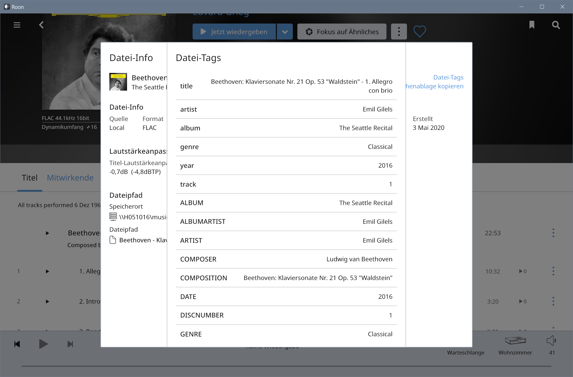

Joel, the file tags are not the issue. All of the files tags indicate exclusively Emil Gilels as Soloist, Artist, and Albumartist. Not ever once is Grieg or Edvard Grieg mentioned.
Again, before I added the first album containing a composition by Grieg to Roon, it showed Emil Gilels (however without a populated Artist site). It only began tagging this album as being performed by Edvard Grieg is when Grieg was added also as composer for the first time in Roon (because I added the album by Lucas Debargue which contains a composition by Grieg).

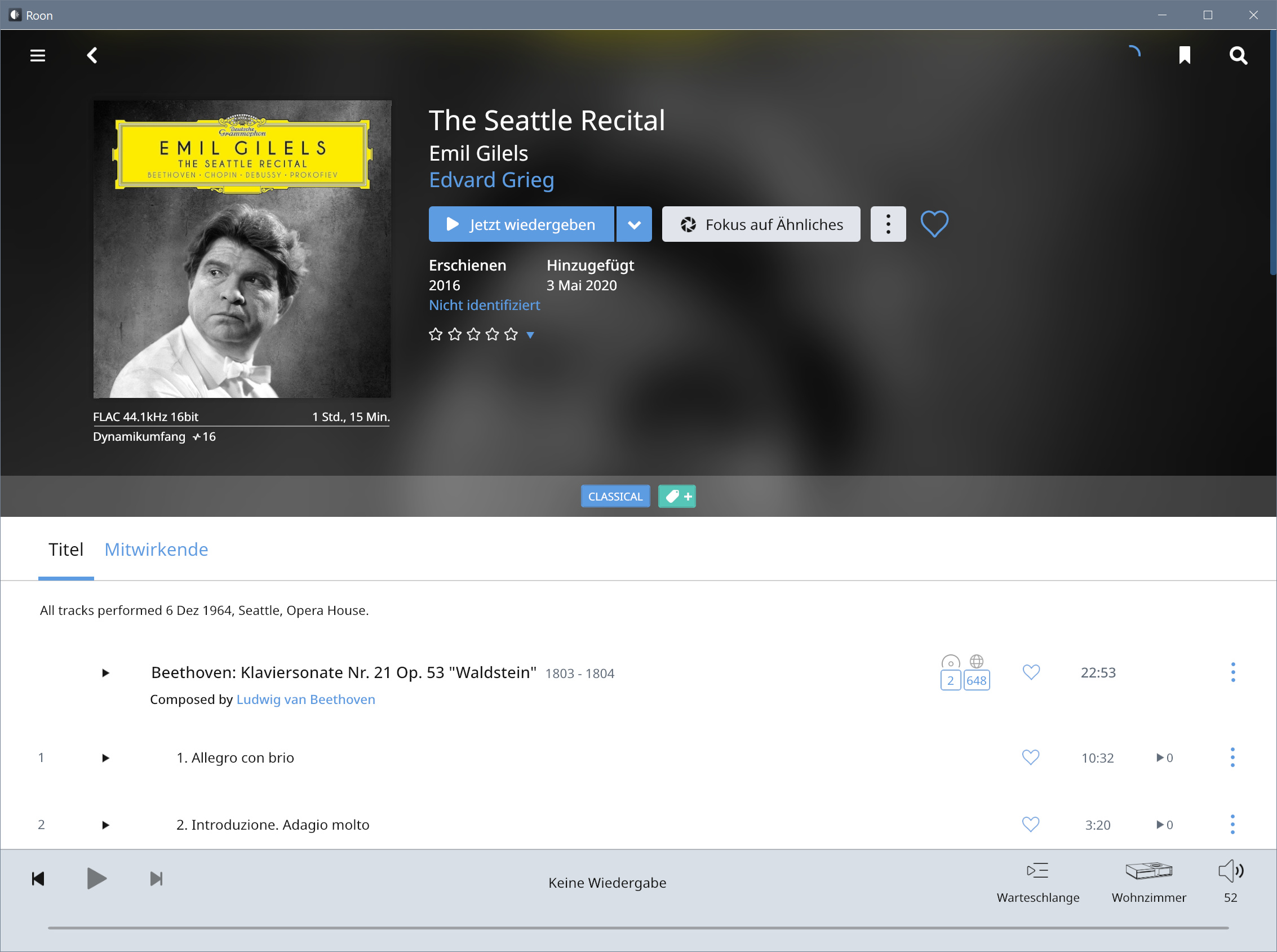

I tried adding “Emil Gilels” as Primary Artist Link and unchecked the “Edvard Grieg” Primary Artist Link, and Emil Gilels is the only Album Artist:
Now, the link to “Edvard Grieg” next to the album cover is gone. However, below it still states that all tracks are performed on December 1964 in Seattle by Edvard Grieg.
Accordingly, I still have Edvard Grieg as Artist in the Artist browser (showing Gilels’ Seattle album), and no Emil Gilels in the Artist browser.
@Martin_F Thanks for confirming your tags. I know what is going on here… Someone mistakenly credited Grieg as “Emil Gilels” on Musicbrainz, so we think that the Emil Gilels on your unidentified album is an alias for Grieg. I will fix this (on Musicbrainz).
Edit: done https://musicbrainz.org/edit/70209682

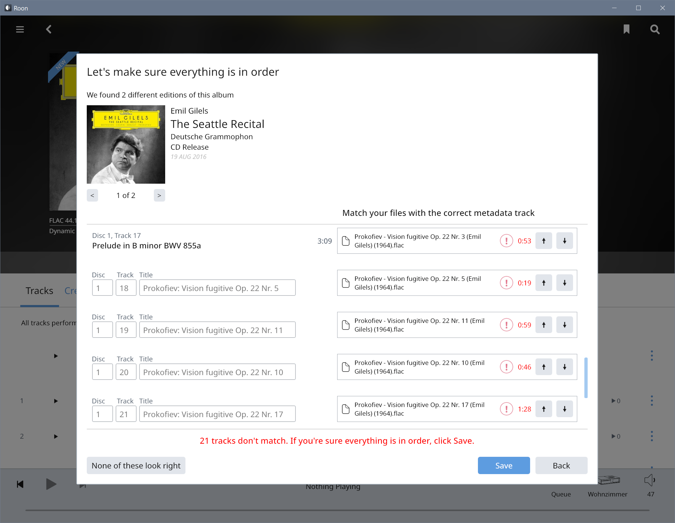

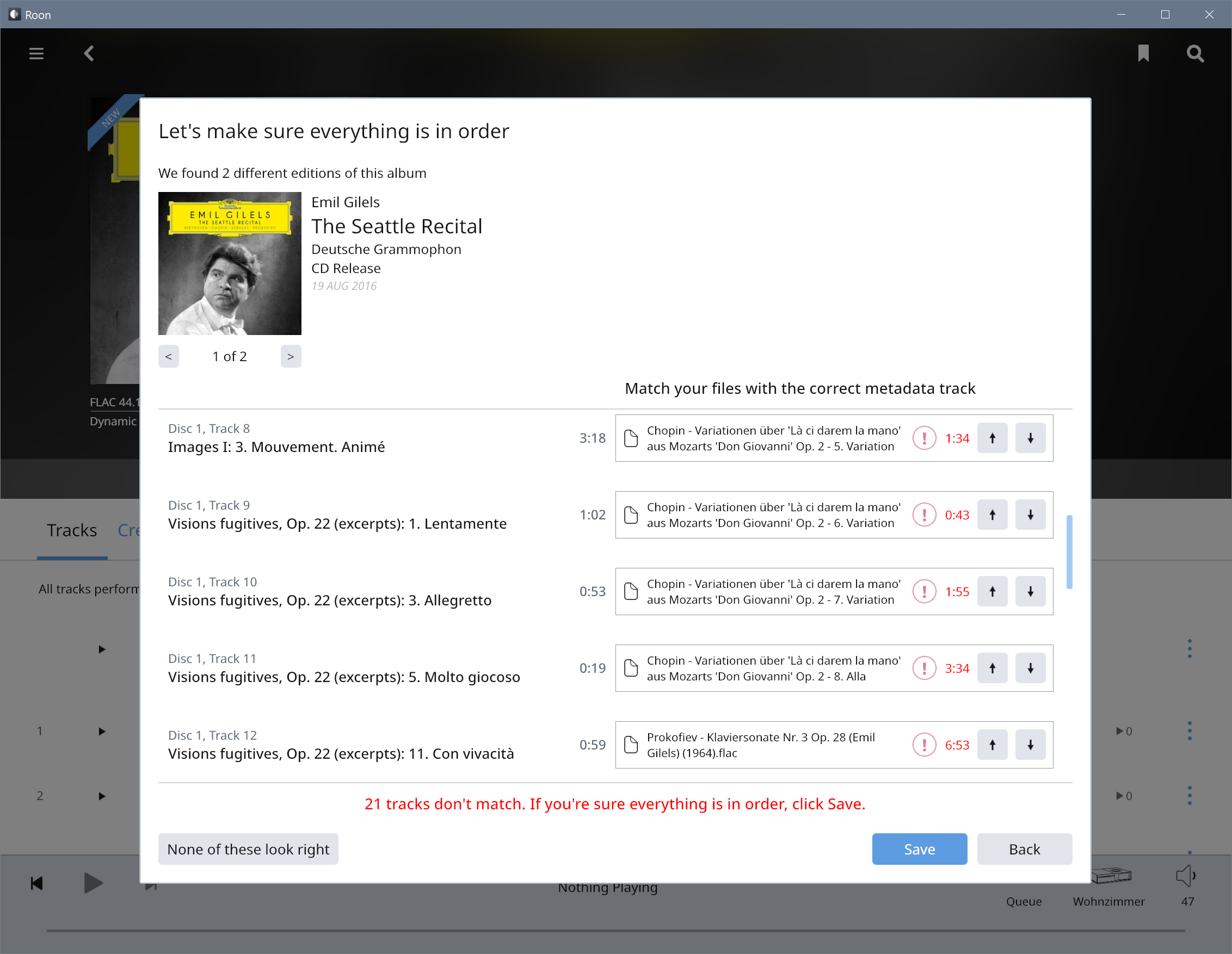

Incidentially, I have another issue with this album that I have also elsewhere: How do I identify an album of local files if the track numbers do not match up?

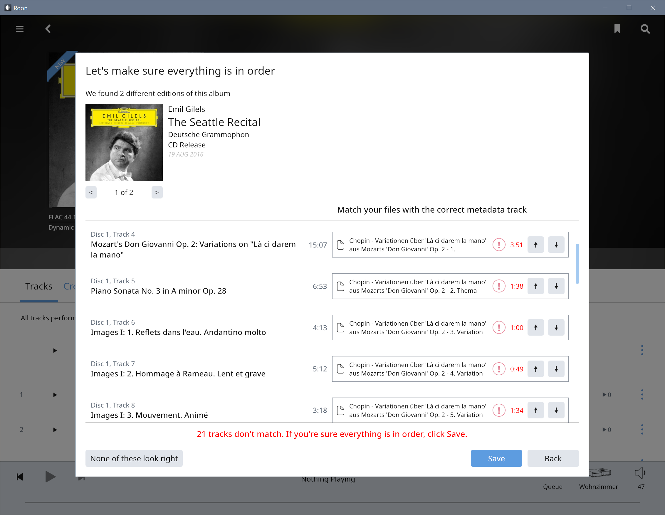

The problem arises because sometimes I split local files into several files. In this case, track 4 are Chopin’s variations on a Mozart theme, followed by Prokofiev sonata (track 5). In the original CD (and in Tidal), the Chopin variations are just one track of 15 minutes. I have split this one track into eight files, one for each movements of this work. As a result, the track count is off. The original album has 17 tracks, my local copy consists of 24 tracks. In the original album, the Prokofiev sonata which follows the Chopin variations is track 5, in my local album however it is track 12.
As a result, Roon has trouble identifying the album. In the “Identify album” dialog, I have chosen the right album (which has 17 tracks). Roon has added in the left column 7 blank tracks at the end to align with the local track count of 24. The problem is that my local album does not have 7 additional tracks at the end, rather my local album has split the original track 4 into tracks 4 through 11, and original track 5 and onwards align again with local tracks 12 and onwards.
I do not understand what I need to do now to align the left column with the right column so that the local album is properly identified? In other words: How do I tell Roon that track 4 in the album Roon knows corresponds to tracks 4 through 11 in the local album I’m trying to have identified?
Hi @Martin_F,
This is not an officially supported method here, but you should be able to get where you want by shifting some of the extra tracks on the left and just ignoring the track time mismatches.
Note that this will likely result in losing composition / performance benefits unless you’re using WORK/PART tags.
