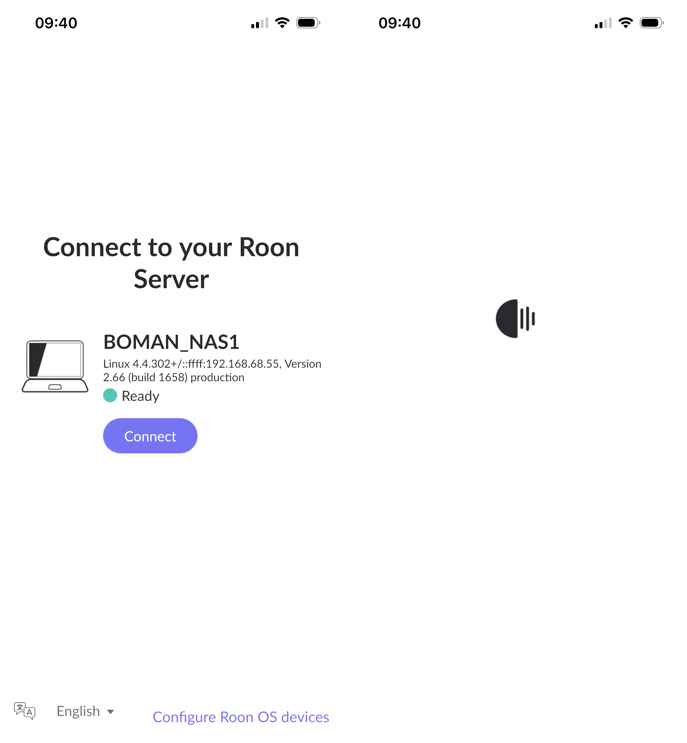

Roon on iOS or Windows not connecting to Roon on Synology NAS. Roon server is recognised and says Ready, but when pressing connect, it just hangs with the Roon animated icon on screen.
Everything is connected to a Deco mesh. Whole network system has been shutdown and restarted, but problem remains. Firewall has been disabled.
The same problem occurs from both iOS and Windows 11. The Roon logs show the connection to the NAS is made, but then after a long while and several memory related messages, it times out and disconnects, then reconnects. This repeats itself forever.
NAS is a Synology DS918+ with 8GB memory.
Plusnet broadband 80Mb/s in modem mode. Deco mesh nodes in each room. Connected by Ethernet to Plusnet router. NAS is connected by Ethernet to a mesh nodes, although the mesh to mesh node communication is over WiFi. No firewall enabled on NAS.

I have spent the last few days redoing the setup. I installed a new separate SSD on my NAS, then installed Container Manager (docker) to that volume. I then setup Roon for docker. All seems to run okay on the NAS, but I still have the same problem connecting from iOS or Windows 11.
I get the same on screen. It shows the server as being Ready, but when I click Connect, it just sits on the Roon animated icon on screen.
Are there specific log files l can upload for you to investigate further? The server logs show the server is finding some roon ready devices, so it seems to be able to talk to my lan.

Hey @Tony_tboman,
Thanks for sending those over! We were able to review them further, and see the following pattern:
  • The Windows client connects to BOMAN_NAS1 successfully, the TCP handshake works fine.
  • You log into your Roon account via SSO, login succeeds ([accounts - LoginSSOConfirm] successful login).
  • The server calls machineallocate and gets back {"status":"NeedsLicense"}.
  • The server briefly reaches AccountStatus=LoggedIn MachineStatus=NeedsLicense — it knows the account is valid but the machine can't proceed.
  • Then Roon calls the logout endpoint, resets to AccountStatus=NoAccountConfigured MachineStatus=NeedsAccount, and the server is back to square one.
This is why the client sees "Ready" but hangs on connect, the server is stuck in a pre-licensed state and never finishes loading the broker.
Based on your account admin, it looks like your Roon subscription is currently expired. I would check your subscription status, log into
and verify the subscription is active and not expired.
Thanks, Tony! :+1:
Hi Benjamin,
Thank you, that explains the problem. I had not taken a subscription as I did not think one was required for simply using my locally stored music.
Based on the requirement to have a subscription, I will return to using free dlna options instead.
Thanks for your time and you can close the ticket now.
