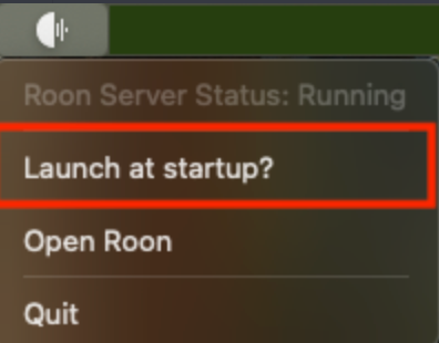

· I changed to a new server,when I login with the correct credentials I am logged in as a free trial user. I have a subscription but it cannot be used probably to login on my new server. There is one other server on my mac but I do not use it and I cannot delete it.

You can stop it from running. Click its icon in the notification area on the Mac, unselect Launch at startup? and then click Quit
However, it doesn’t really matter if it runs.

About the Mac server you’re seeing
The Roon Server instance on your Mac does not affect the Antipodes server in any way. It’s completely independent and can simply be stopped or ignored — it will not interfere with licensing or server selection on your network.
