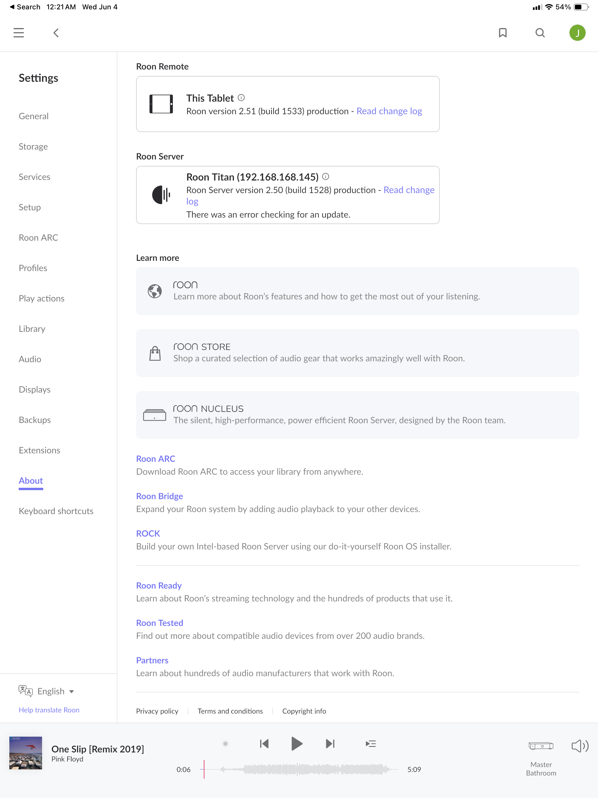

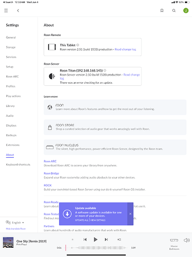

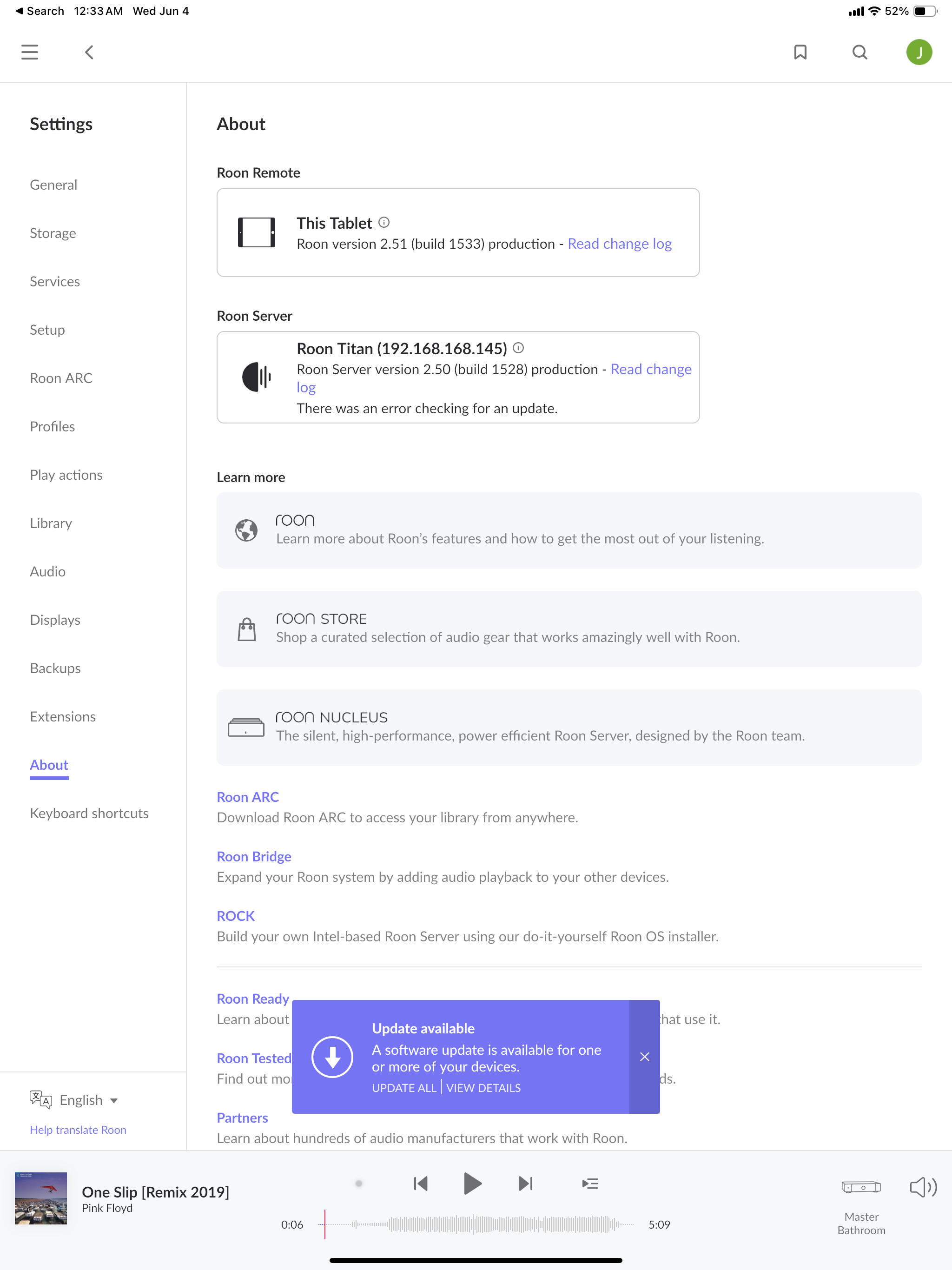

Forgive me if this has been covered. I scanned down the current list and no one seems to have this problem except me. Everyday when I first login to Roon I get a message that “A Software update is available…”. Is there really a daily update occurring. I would think this is dubious.
I have attached a pic of my current builds to see if there is an issue brewing on my Titan or something else is going on.
Another interesting observation is that if I try to perform a manual update I get a message to the effect “There was an error checking for the update”. So I seem to be caught in a loop.
But I don’t see how I can fix this on my own.

  1. So far I tried to delete and reinstall the App- no go.
  2. I reinstalled the OS software - no go.
  3. I restarted the Titan- no go.
Right now I am stuck at build 1524 and it looks like I should be at build 1534.
Just to note I was getting a delayed error saying “there was an error checking for an update.” Now I get the error immediately after hitting the install button.
I’ve tried this on my iPad and my iPhone with the same results.
Any other suggestions?
John
