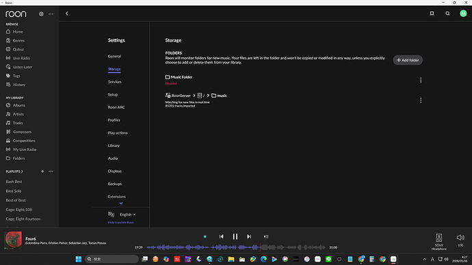

Thanks for your advice.
To be honest, it’s a bit over my head right now, so I’ll need to do some studying.
I actually followed the instructions in this link, but…
Numbers of folders is 151310 on my QNAP. (find . -type d | wc -l)
The result of ”cat /proc/sys/fs/inotify/max_user_watches” is 262144.
Trially I have done “sysctl -w fs.inotify.max_user_watches=524288” but detection still does not work.

Embarrassingly enough, I wasn’t following the procedure correctly and it ended up as a network share. Once I retried with the correct YAML file I downloaded, the direct reference worked perfectly.
