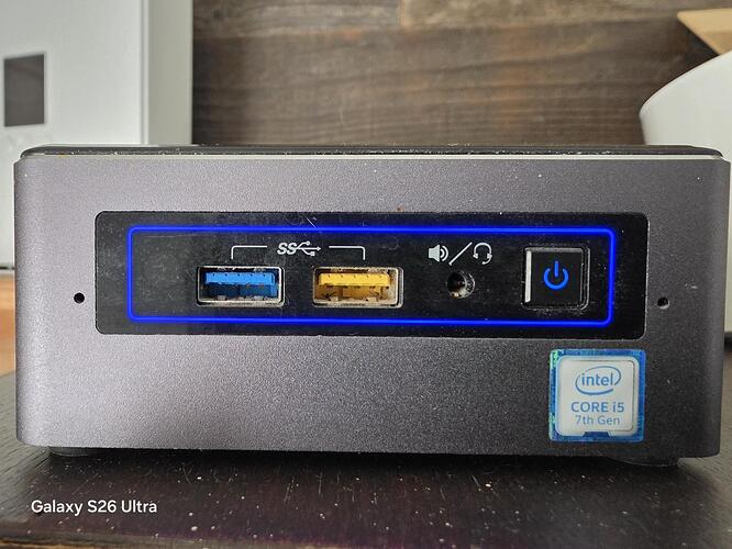

Hi and thanks for trying to help. Picture of my current NUC below. It will take a while for me to connect it to a screen - I’ll work on that and post photo later. If this does need replacing, I am reluctant to get another NUC. This will be my 3rd in 5 years. It runs extremely hot, is noisy…. and doesn’t seem to last very long; which is why I was considering the swap to a Necleus.

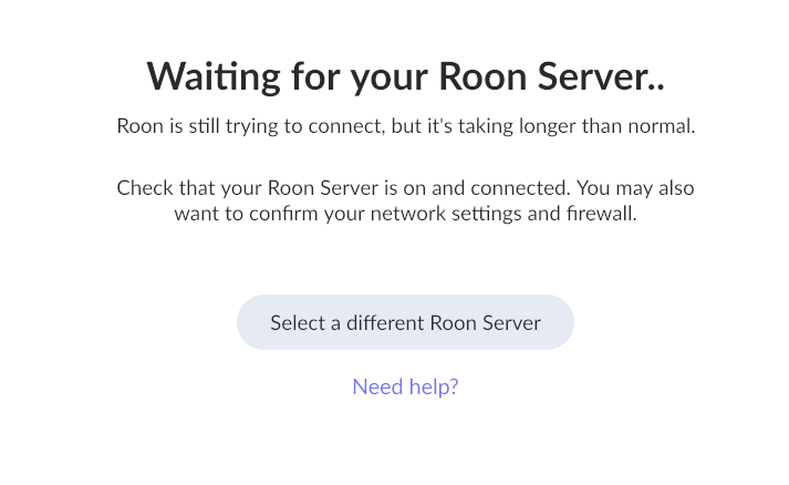

My setup. I have the NUC hardwired to my internet router and hardwired to a Cambridge Audio 851N. I also have a laptop and a desktop (both running Windows 10) connected via Wifi. All used to play together nicely but now none of them can find the ROON server - I just ‘waiting for ROON server’ message.
Not sure if its relivant but I’ve never been able to get ARC to work - apparently my T-mobile home internet router won’t allow the connection……..but this situation has been going on well before the NUC started playing up, so doubt it is related. :grinning_face:
Now I have really confused myself. I seem to be able to play fine when I use my laptop or desktop PC’s as the remote. However, if I try to use my Android or Amazon Fire tablet (more convenient than getting the laptop out) neither of them can see the server. I just get the magnifying glass thingy moving around in circles.

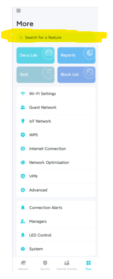

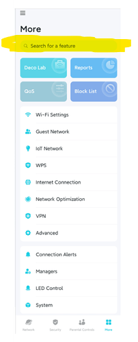

TP-Link changes the menu system between versions (as noted in Benjamin’s post) and the setting might be located under ADVANCED instead.
However, most have a search bar and you can search for IGMP which should bring you to the page that has the IGMP Snooping setting.
Example with Search area highlighted
Thanks for the followup @Ian_Webster - @Rugby is 100% correct with the above, are you able to use the search function?
