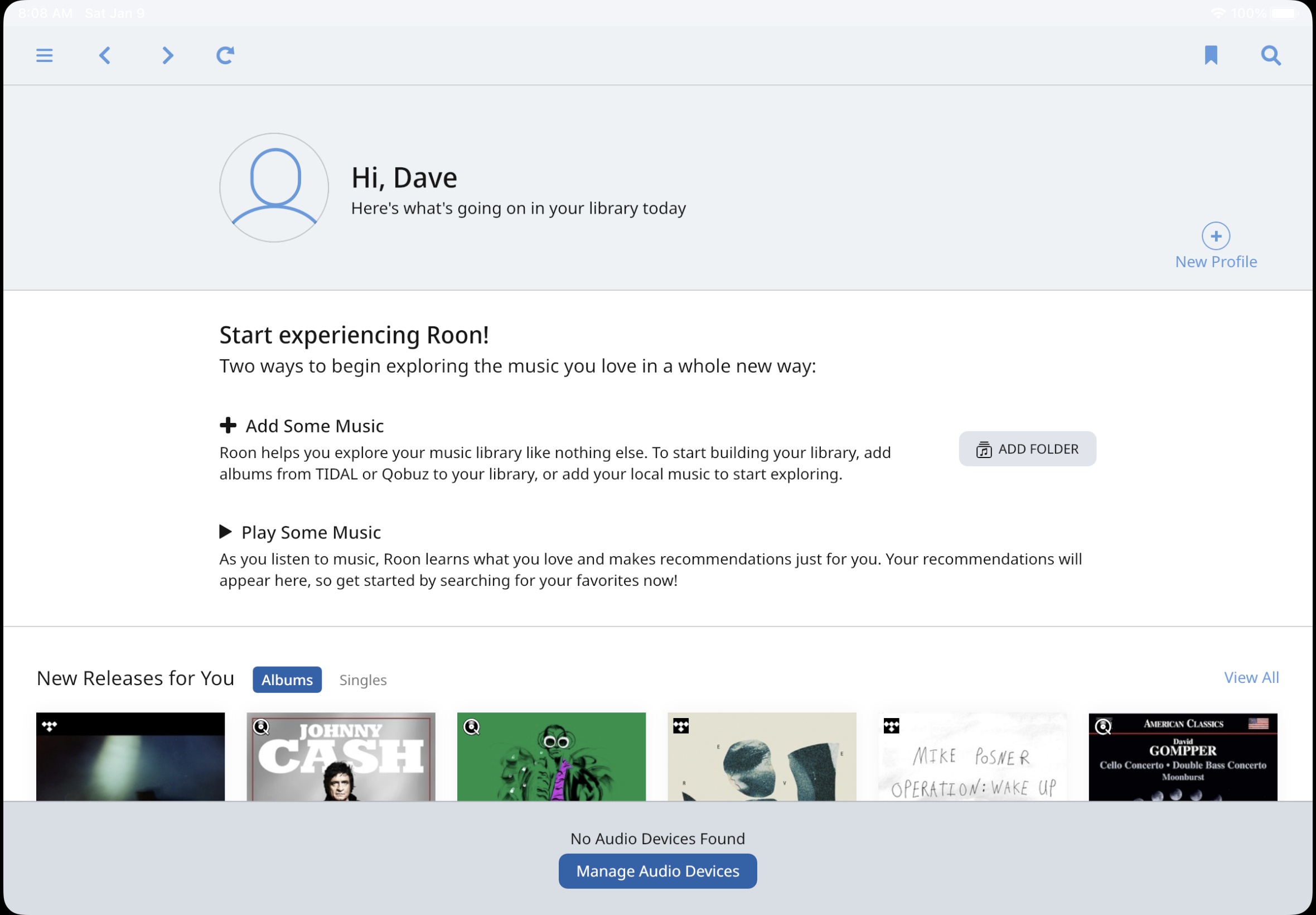

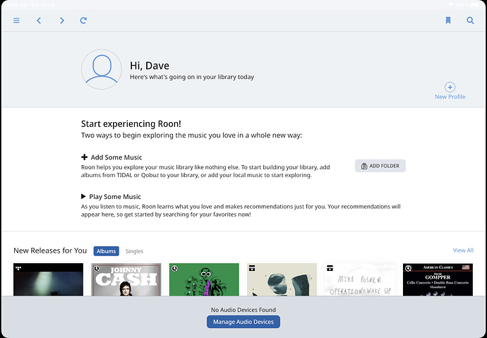

It’s lost my library and audio connections - see screenshot …
You’ve lost your Roon library. The power outage (spike) corrupted it; a not uncommon result.
