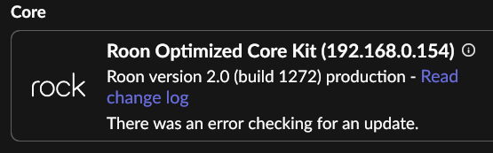

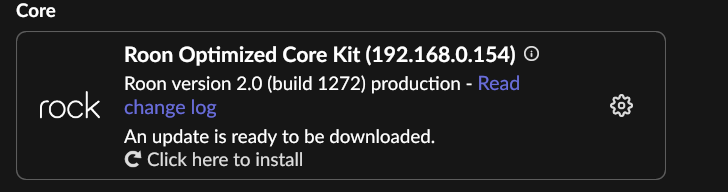

The upgrade of Roon Core, from buld 1272 to build 1277 fails! After downloading, it comes with the message:
Schermafbeelding 2023-06-16 110943
Is there anybody from Roon @support who can answer my previous question, please?
Go to the Web Administration page and Reinstall the Operating System - that should pull in the latest Build of Roon for you.
Hi @Dirk_Maes ,
Have you been able to use the Reinstall button on the Web UI to force a manual update?
I activated diagnostics on your ROCK and it looks like the update is timing out, even though the link appears to be correct in the logs.
I would suggest trying the manual update via the Web Interface to see if this sorts the issue out. You could also try to double-check your DNS servers and switch them to Cloudflare (1.1.1.1) or Google (8.8.8.8).
