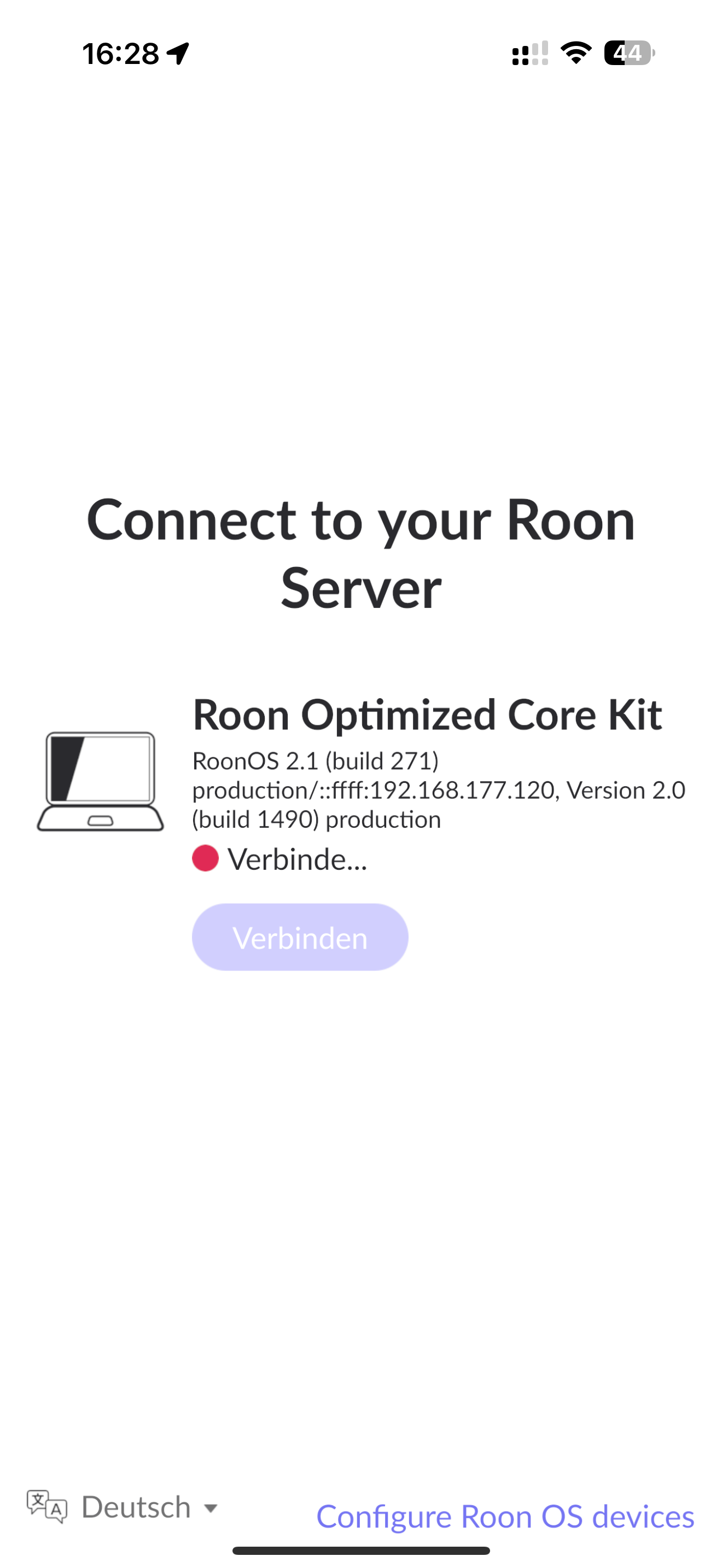

Roon Core visible but not connecting to iPhone 16 Pro (ref#PI4TAB)

Roon Core does not connect to my iPhone 16 Pro/ Roon core visible but no connection
No connection with iPhone 16 ro
Hi @Rosario_Beninati1,
Thank you for your post. We’ve requested diagnostic from the affected ROCK and iOS instance to take a closer look.
In the meantime, can you please share the following to expedite our investigation?
  1. A screenshot of the RoonOS web administration page for this ROCK.
  2. A basic description of the topology for the mesh network you mentioned. Where are the ROCK and iPhone connecting relative to the main router and to one another? How many mesh nodes or managed switches are in between, and how much of the network chain relies on WiFi?
Please also share any VPNs or additional network interfaces you might be using on the ROCK.
Thank you!
