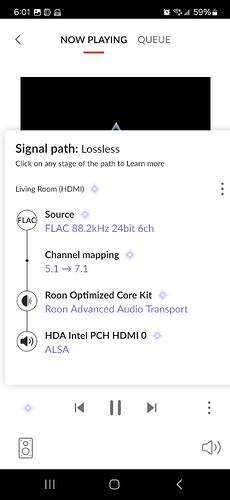

Multi-channel audio definitely is supported by Roon and it works fine using the HDMI output on my custom built NUC running ROCK. This is basically the same as the Titan or Nucleus hardware.
I’ve gone ahead and moved the NUC running RoonCore to the home theater and am using the HDMI output for multi-channel audio now. Just feels stupid to have such an expensive home theater processor that is “Roon Ready”, from the company that owns Roon, and it not support multi-channel audio without an external streamer. I’ve moved my ST60 to my stereo hifi / DJ system now.

I guess I’m going to have to live with Plex and HDMI off the back of my RoonCore as the way to play multi-channel content until RAAT lives up to its promise. It just sounded like since Roon supports multi-channel that RAAT would to, as that is literally what @brian said would be the case in the past.
It does. RAAT is perfectly capable of handling multichannel up to 7.1, but there are very few roon ready devices out there capable of accepting such a stream.
You seem to be missing the point that your AVR doesn’t support multichannel via streaming nor do lots on the market. This is a hardware limitation of streaming boards they buy in not Roon. If the hardware supports it and the vendor codes RAAT to use it it will. But you can’t get 4k output from a 1080p video board can you so here your more or less asking the same thing from Roon to support something the hardware can’t by its design. Doesn’t matter if it’s a multichannel processor or not if the input into it is limited to start with. Take this to the manufacturers as trying to find if they actually support multichannel over DNLA or anything streaming related is rarely advertised as a feature as it’s not and it’s only via support threads you will find it out.
Looks like the Trinnov AV range support multichannel over RAAT Streaming. But at 21k a tad pricey cant find any other AVRs that support multichannel at all via Network playback. . So it possible if the hardware is. You could look at adding an Eversolo DMPA6 as an endpoint and connect that via HDMI. Roon can send multichannel to it and it sends on to the Amp via HDMI. Cheapest option is to use your roon server direct connected or another low cost pc with HDMI and install Roon Bridge on it. Both these will give multichannel.
Luckily, I only have one multi-channel audio setup/room, so I’ll just leave the hdmi from the RoonCore for it. Annoying to have to run a fiber HDMI connection from the server room, but it works.
