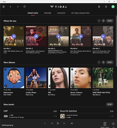

I get this issue as well if I use the ‘play’ button in the centre of the playlist image like:

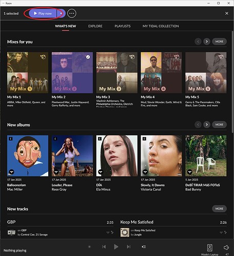

However, if I select it and then use the ‘play now’ button at the top of the page it plays fine.

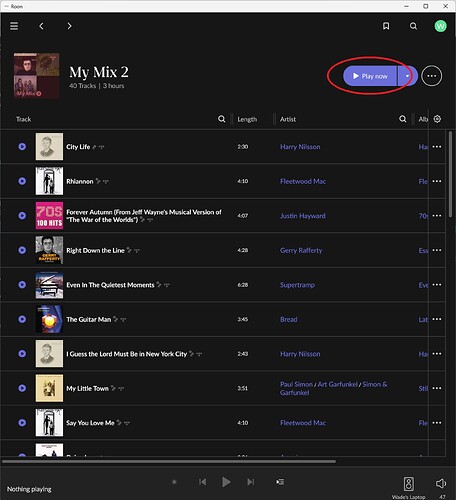

Similarly, I go to the playlist track listing and use the ‘play now’ button from there, it works without issue:
Not ideal - but it is a workaround.
