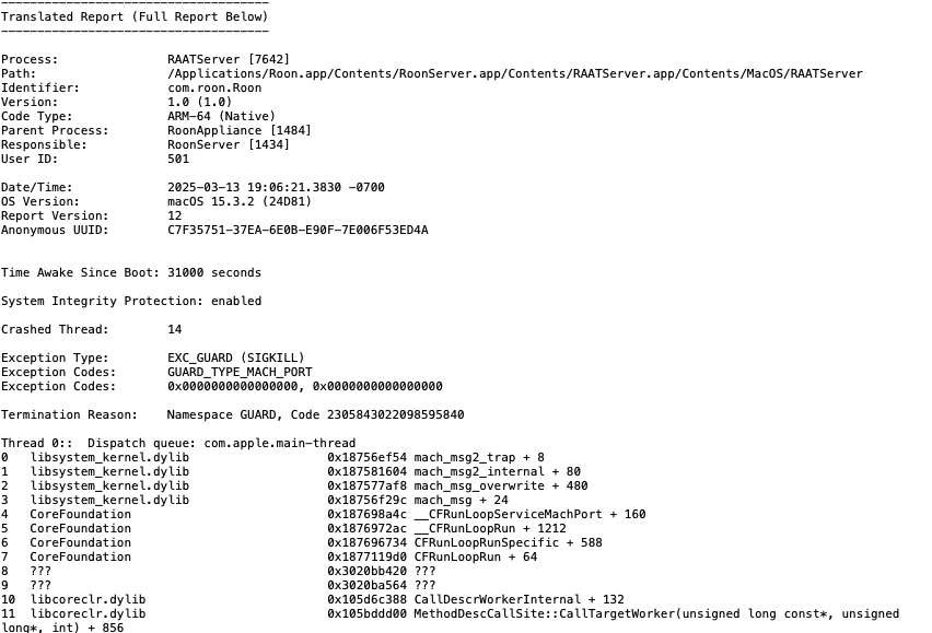

Roon is no longer functional after MacOS Sequoia 15.3.2 Update.
I have Roon installed on a Macbook Pro M3 2024 Model.
To add a bit more information to this, I have restarted the Mac and it works for a little bit and then crashes again. I’m not seeing a Roon update to fix the issue…is there one coming or already available? I literally just got DSD features working again.

Thanks for reaching out. That looks like a RAATServer crash, which is strange. I suggest trying a RAATServer refresh to see if this helps.
You can generate a new RAATServer instance on your device by following these instructions, but please be aware that this will reset your Roon Settings → Audio Tab to factory settings and I would advise making a backup of any custom DSP settings you have:

I literally did this 2 weeks ago to resolve an issue with DSD files not playing. While I agree that it’s a RAATServer crash, it just happened IMMEDIATELY after processing the 15.3.2 update so it stands to reason there is a system change in 15.3.2 that’s causing the problem.

We appreciate your patience. Are you able to upload a copy of the crash report itself? They should be listed in Console. You can use this uploader link at your convenience.
So far, our efforts to generate a crash reproduction on the same OS and hardware have been unsuccessful, so developers are requesting some more information to pin this down:
We can see these cyclical RAATServer crash events in logs associated with your RoonServer. RAATServer and RoonServer both report a loss of network access to the loopback just before RAATServer goes down. The 15.3.0-15.3.1 updates contained more granular security that restricted third-party apps (including Roon) from accessing the local network. Users had to toggle “Local Network Access” off and on for Roon in their Privacy & Security settings. I recommend trying this step in the meantime.
