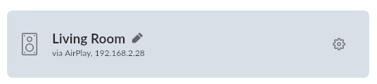

Can you post some screenshots of Roon’s settings for the Denon (Settings > Audio, and the details of the device setup screens for the Denon connection in Roon)?
Looks like it is over AirPlay after all. My phone is Samsung though. I guess AirPlay doesn’t have to work through wifi?
