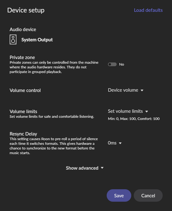

Here you go.
It looks as though you’re using the System Output device on your Dell. You could try the Realtek WASAPI device instead. Odd, though that you seem to have two Realtek WASAPI devices - I would have expected to only see one…
Those wasapi ones you see are a direct link to my audio devices, so the default output is ignored if I pick these. One is my onboard speaker, the other my su9. The ASIO one doesn’t work. Even if I pick the su9 directly via this method it doesn’t work. This is not something I set up.
So shouldn’t you be using the WASAPI connection to your SU9? That’s the one where trying different settings might prove to fix things, I think
Unfortunately this gives exactly the same result as using the default.
What have you got for the Advanced settings for that device?
@Geoff_Coupe @Gilles_Van_pellicom Thanks for you’re reaction. Not a tech guy just trying to help out.
Here are the advanced settings:
And my driver settings:
I tried turning exclusive mode and/or enhancements back on but that just made the sound on my entire laptop worse or just crash.
