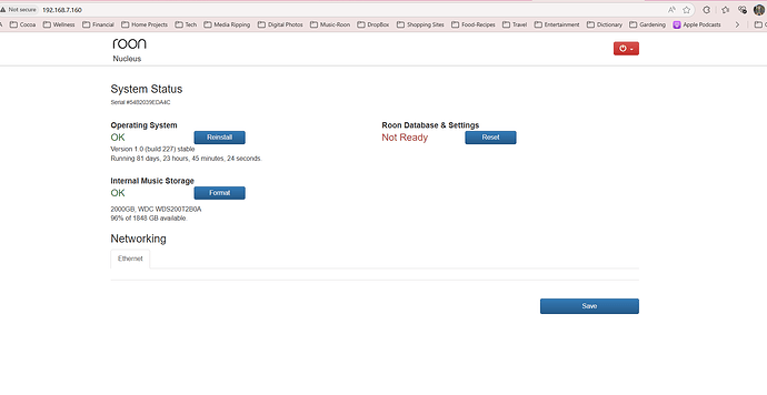

Hi benjamin - this is all the WEBUI shows for us:

Thanks for the screenshot of the Web UI. The Networking section being blank is concerning. The Nucleus is clearly connected to your local network, since you’re able to access the Web UI, but it doesn’t appear to be reaching outside your network, as we’re unable to see it from our system.
The best way to proceed is to follow the database refresh steps that @benjamin sent you earlier. Were you stuck on the second step (i.e. stopping RoonServer from the Web UI)? If so, we can help guide you through that part. Just let us know where you’re getting stuck.
The only part of the WebUI we could access was in that screenshot. We tried all of the options there, reinstalling the OS, resetting the database, and reformatting the drive. None of those options make any difference, we still can only see that limited part of the UI and cannot find it with Roon software to setup.

Based on the screenshot and the symptoms you’ve provided, it sounds like you might be suffering from a failing m.2 SSD.
If reinstalling the OS and rebooting the machine didn’t help, the best next step here is to get in touch with our RMA department directly, as they’re in charge of all hardware-related Nucleus issues. To do so, open the Typeform link below and select ‘Other’ followed by 'This issue is related to a physical component".
