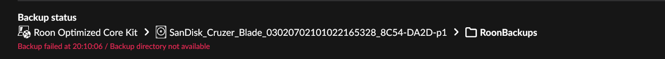

Roon database backup failed
ROCK on NUC wired to the home main router. SOtM network streamer wired to another router (Netgear R7000) in bridge mode.

Hi @noris, thanks for quick response. The drive has been connected to NUC’s USB socket and backups worked well for many months. It just stopped working last weeks. Should I disconnect it from the NUC and format it?
Edit: Just ejected the drive from the NUC and formatted it to exFAT. Forced backup - works fine now. Hope scheduled backups will also work. Thanks for help.
