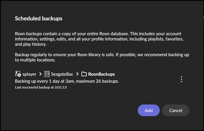

This shows the new path set up, specifically selecting the RoonBackups folder (which wasn’t required before)

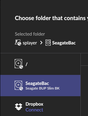

After running Force Backup Now and Scheduled Backups, I go into Find Backups and just select the drive, NOT the RoonBackups folder

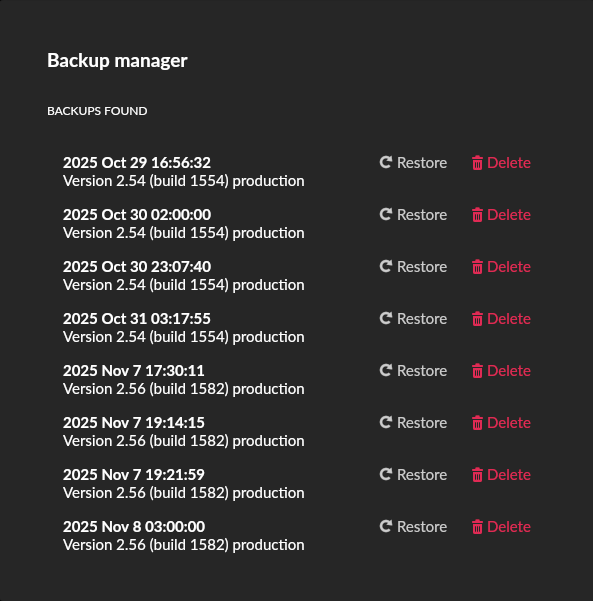

Now Find Backups can see the backup created by Force Backup Now (either 2025 Nov 7 19:21:59 or Nov 7 19:14:59) and Scheduled Backups (2025 Nov 8 03:00:00)

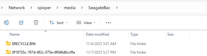

I don’t know if this makes any difference, but I do see a file named " roon_backup_root" that was created in the root of the disk, outside of the RoonBackups folder, along with the database backup that was also created outside of the RoonBackups folder (see the folder and file dated 11/7/2025). Of course, being outside the RoonBackups folder, Find Backups cannot see this.
